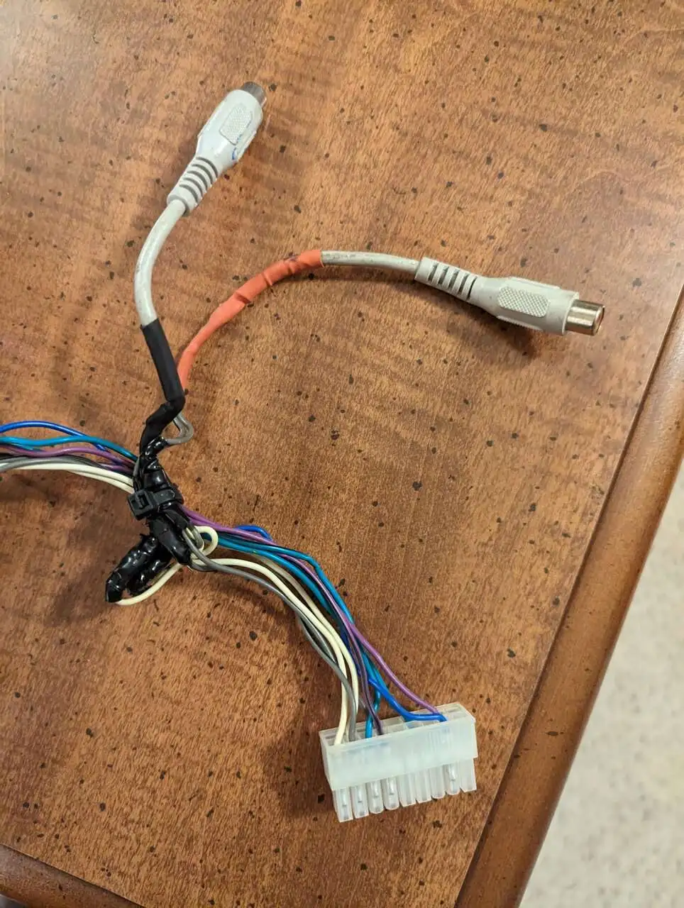

You have to slightly modify it. And I do mean slightly.
With the Bose amp, you don't use the blue breakout box. Instead you use RCA's that you have to connect *to the harness*.
The beauty of this harness is, you don't cut any factory wiring. Everything remains 100% intact.
On the part of the PAC harness that leads to the blue box, that's where you splice in RCA's to feed your amps. And then you don't use that box.
