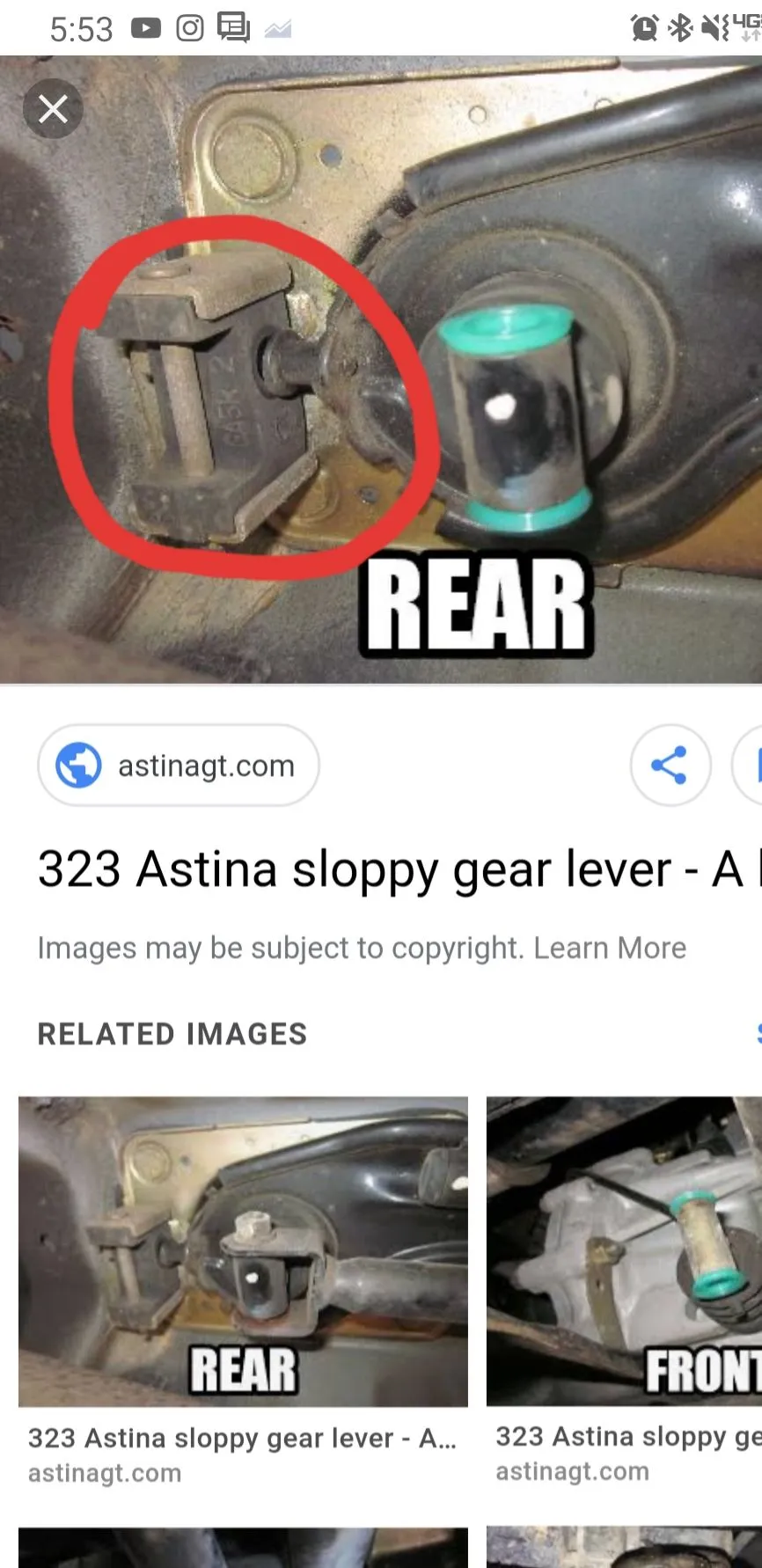

0 02ge VOLT : 2002 protege Apr 30, 2019 #1 Trying to find this rubber bushing and that pin. Can some point me on the right direction? I can find the part number to safe my life. I've tried search, parts, google. I don't see it on the manual or in the parts list I have. Attachments 20190429_204900.webp 97.5 KB · Views: 753 Last edited: Apr 30, 2019
N njaremka Wiggity-Wack-O-Tack Contributor : 2012 Mini R55 May 1, 2019 #2 https://www.jimellismazdaparts.com/...odel=14366&modelYear=1998&ukey_category=20236 Item 46-110B https://www.jimellismazdaparts.com/...e/PLATE--BASE---LEVER/1828340/BC1D46110A.html It was a seperate line item part on the earlier cars, and because an assembly part on the later cars. Should be interchangeable with your 2002.
