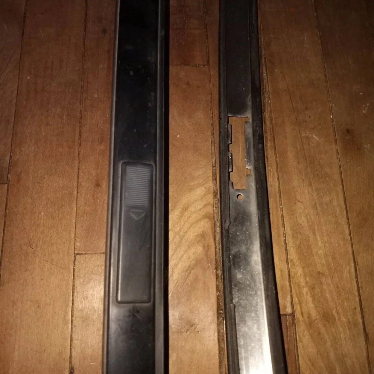

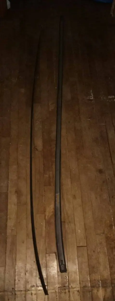

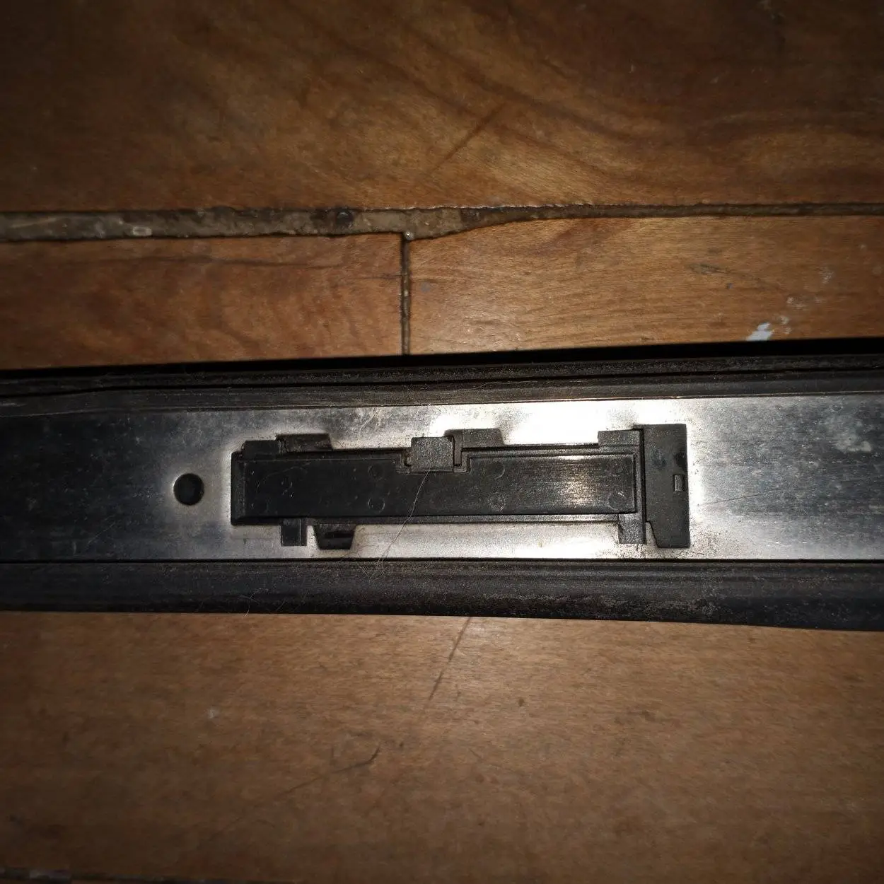

I've got the strips for a flat roof if you want them.
I've only got one "filler cap" though but you can use it to fabricate more of them.
Make me an offer.
