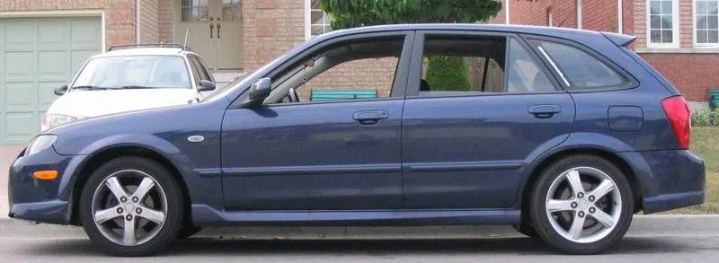

The MP3 Springs are about 27% stiffer than a stock P5 or the ES Sedan with GT package.
It makes a difference [for me] in terms of:
- during hard braking the car tracks in a straight line
- during cornering the car is more controlled
- comfort is relative since some people find the stock P5 suspension too firm.
For my car with the MP3 springs drop .75" in front and about .875" [?]in the rear. See it's not a pretty sight but it works well.

When I had the MP3 springs for a track setup, the ride height would look even. During some hard corners I would encounter "bump steer". As the suspension travels up/down, it causes a kickback in the steering wheel. It didn't affect my cornering that much though. Some people might be freaked out when that happens though.

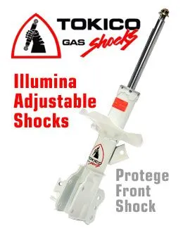

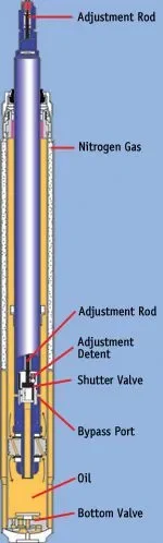

The cheapest place to get Illuminas is eBay.. I got mine for $460 shipped(US)

Let me know if you have any more question or need pics of the drop or something.

EDIT: how exactly do I adjust the Illuminas? Like is this something I can do simply by jacking up my car because I'm having trouble visualizing what I have to do.
I'm only 16, I'm sure there's other members on here with an eBay account willing enough to ask.
To adjust the dampening, you just need a screwdriver.
For the rears, you have to remove the rear deck lid, and loosen the seat belts.
OOHHHH!! So that's where it is lol... Ok ok now I know I'd just have to pop up the hood for the front and do what you said for the back... hehe thanks!
