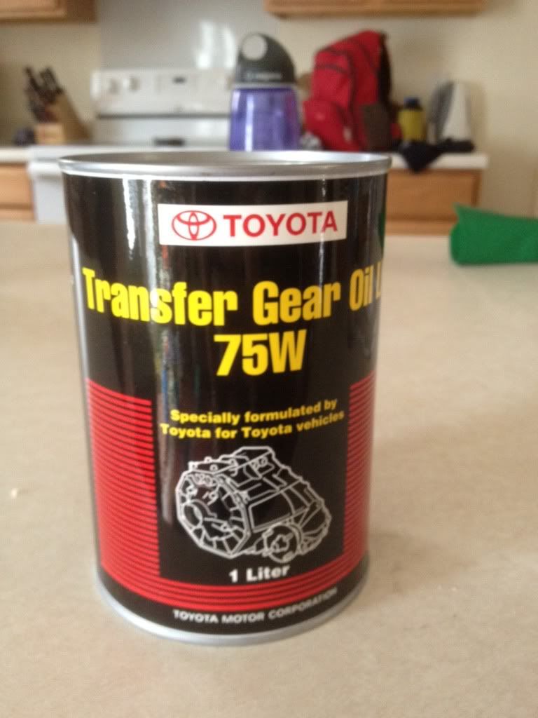

Rear is fairly easy... front isn't hard but you have to remove a couple metal skid plates so it is more difficult in that regard. The plastic shield is much easier to remove on the CX-5 from the weight perspective alone. I had the vehicle on all 4s up on Rhino ramps but used a jack stand to support the skid plates as I removed them. As with the Mazda.... rear diff was stock low and front diff was right on for fluid levels. This vehicle has a transfer case using the most expensive fluid I have ever purchased @ around $50/quart. I had to buy two and it even comes in an old school metal can. I couldn't find anyone offering alternatives including Amsoil. PT transfer cases there are options but with FT Torsen AWD too much doubt with discussions I found. I know a lot but probably won't change again for 5+ years.
⋯ This vehicle has a transfer case using the most expensive fluid I have ever purchased @ around $50/quart. I had to buy two and it even comes in an old school metal can.
Some people may have never seen those old school metal can for engine oil and ATF ⋯ :) But $50 per can? Well at least you got a little more from a "liter" can! But I'd stay with OEM Toyota Transfer Gear Oil LF 75W even though it's pricy! Do you use the same or different gear oil for rear differential?

I was able to use standard 75W-90 Amsoil for the front and rear diff. The GX takes 3 quarts in the rear diff and 1.5 in the front. As for driving up the ramps... very carefully.. actually I had my wife guide me up and I also did it while vehicle's AWD system was in 4-LOW. There is enough ground clearance with adjustable rear suspension to slip the ramps under all 4 corners. Ramps are rated beyond the load I put on them. That being said I'm always extra cautious and leveraged the use of a couple jack stands while I was under vehicle for extra safety.
