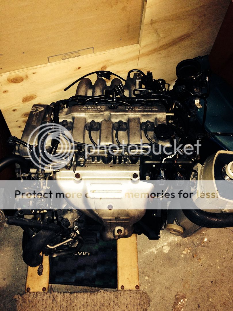

cool, I already knew that, this is like my 4th engine, i've just never done a JDM swapped one. Also the pics of the JDM engine looks like it has a different head and intake manifold, so wanted to see what the deal was with that, and if the cams are the same on the JDM VS USDM
JDM has higher compression, better cams and a similiar manifold to the MP3.

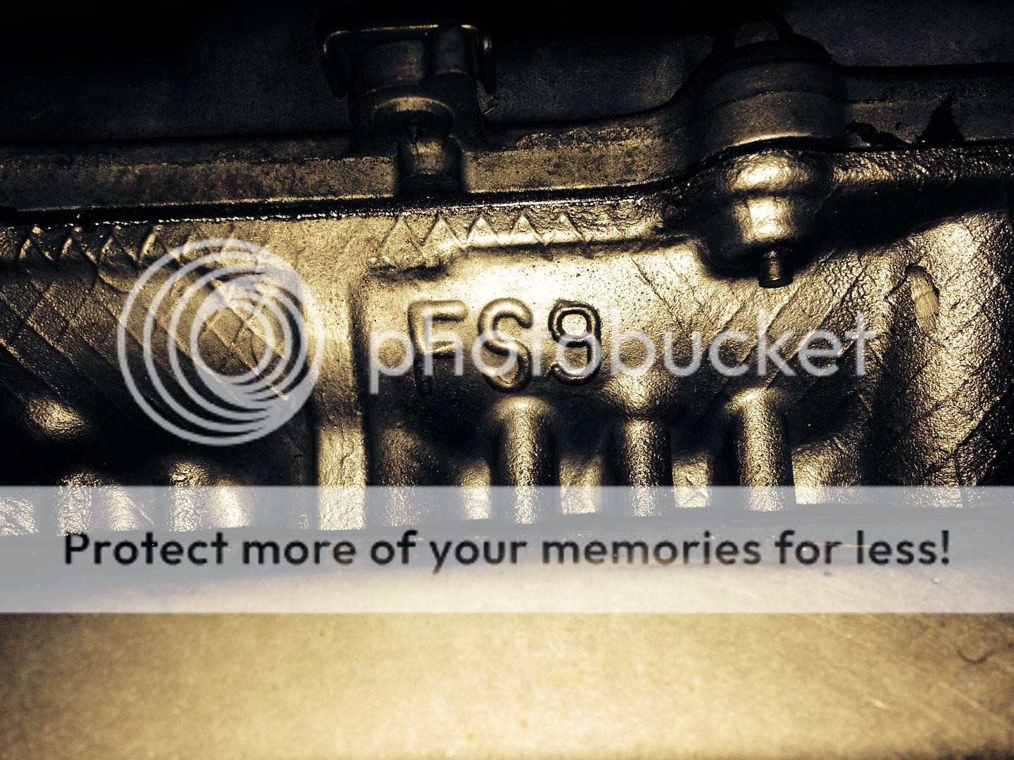

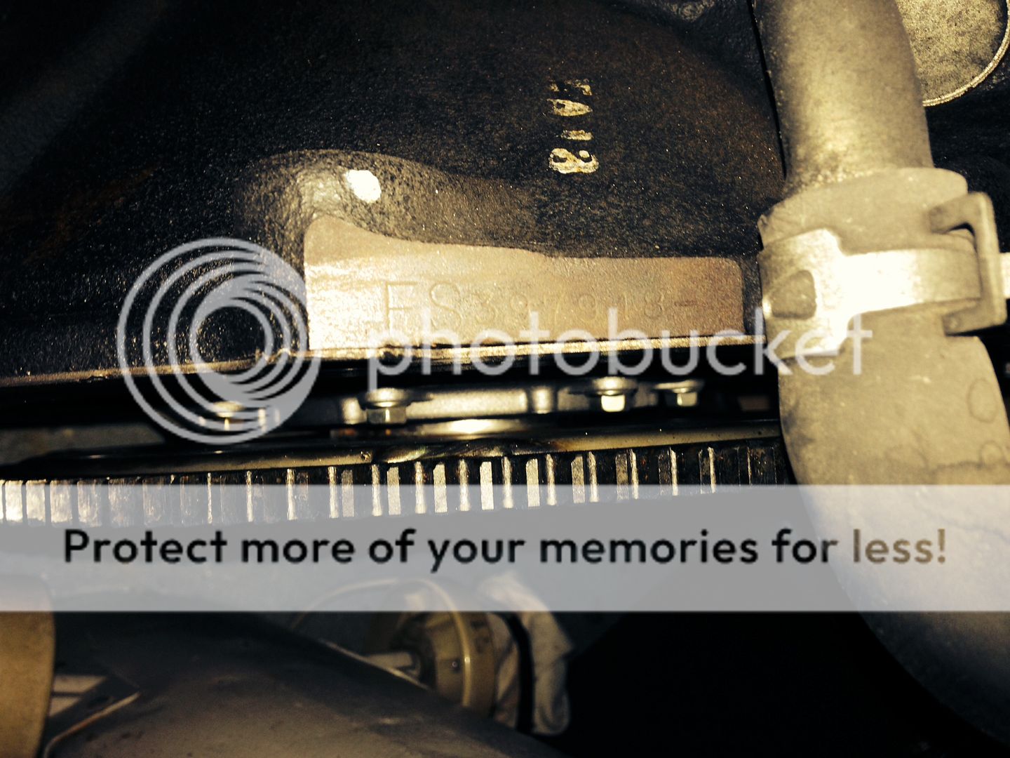

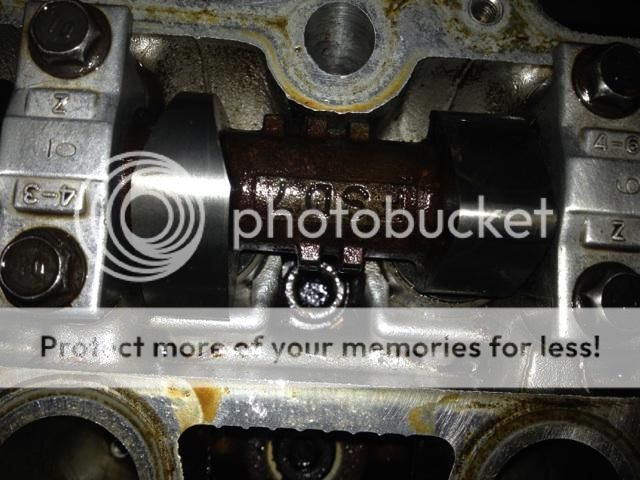

I'm not sure if this is information you have based on a search (on this thread, google or otherwise) or if it's first hand knowledge. What I DO KNOW is that the JDM FSDE that I'm getting has the FP39 intake cam because that's what's stamped on it. I know this is an FS engine because it has the FS stamp on the block. And also, not all JDM engines have coil on top, only the ZE, the FSDE and FPDE I believe have the coil pack on the front of the the engine, like the one I'm picking up tomorrow.

If it has an FP cam its not an FS man. *ALL* FS-DE/ZE cams start with FS. Whether its FS1G, FSH9, FSD7, FS9 or FS1E. The FPs came with FP39 and FP47.
Only time that it could be an FS, is if it has an FP cam. But that would be stupid so not sure why that'd be the case.
Well the exhaust cam on my JDM engine is FSD7 and the block itself is stamped FS NOT FP. That convinces me that it's an FS despite the fact that it has the FP39 intake cam.
Just because you think it would be "stupid" doesn't make it not true. So I'll take your word that you've worked with all the JDM F engines and know what you're talking about from experience. So in that case, do I have something unique? There's no way I really have an FP if the block is stamped FS
If you get the time check out the stamp on the Crank. If its a FS itll be FS01.
Ill have to check what the FPs were stamped. Think I still have a 1.8 crank downstairs.
Your misunderstanding why Im saying its stupid. The FS cam is 241 degrees duration intake on the JDM, it opens at 5 Degrees BTDC and closes 56 ABDC.
When you pair that up with the FSD7 Cam which is 230 degrees which opens at 48 BBDC and closes 2 ATDC. You get 7 degrees of overlap.
With the FP Intake Cam its 225 Degrees duration and opens 0 BTDC and closes 45 ABDC. This gives you 2 Degrees overlap.
Now despite what anyone says some overlap in a turbo car is a good thing, it decreases spool up. Your original motor stock had double this.
The major problem is that the rod ratio that these engines have mean they respond to duration more then overlap. So in effect you have either a JDM FS with higher compression and a intake cam that will make it more likely for you to zoom zoom boom, due to higher dynamic compression. As well as producing less power or an FP with a FS exhaust cam. Which is just sily as you want the FS intake cam and the FP exhaust cam as that would combine to give you 11 degrees overlap.
Should note that all these numbers are at .003 which means that your effective overlap is actually bugger all for USDM FS and your JDM FS.
It's all good though, I'm planning on using the MSP head with the FS bottom end. Clearly it's an FS head and FS block with the FP intake cam:
