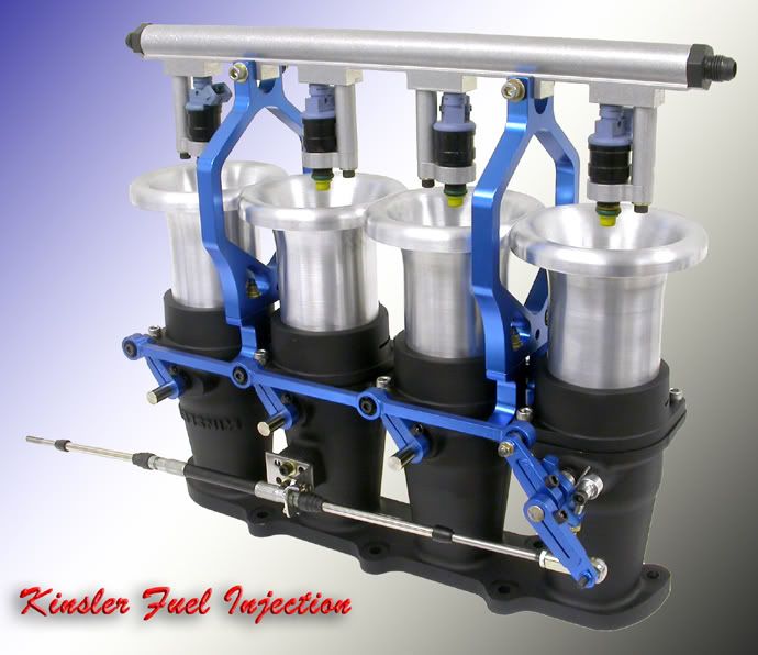

BTW anybody really serious about this may want to contact kinsler fuel injection as they make custom ITB's which i believe is going to be almost essential to making this HP goal reliably. Here is a setup from a honda with a top mount injector setup

ohh i know how a tunnel ram works but good luck fitting one in a protege engine bay
btw black top and silver tops had the ITB setup they are the same
blacktop quads have a bigger throttle bore...which is more closely matched (from what i can tell) to our engines.
