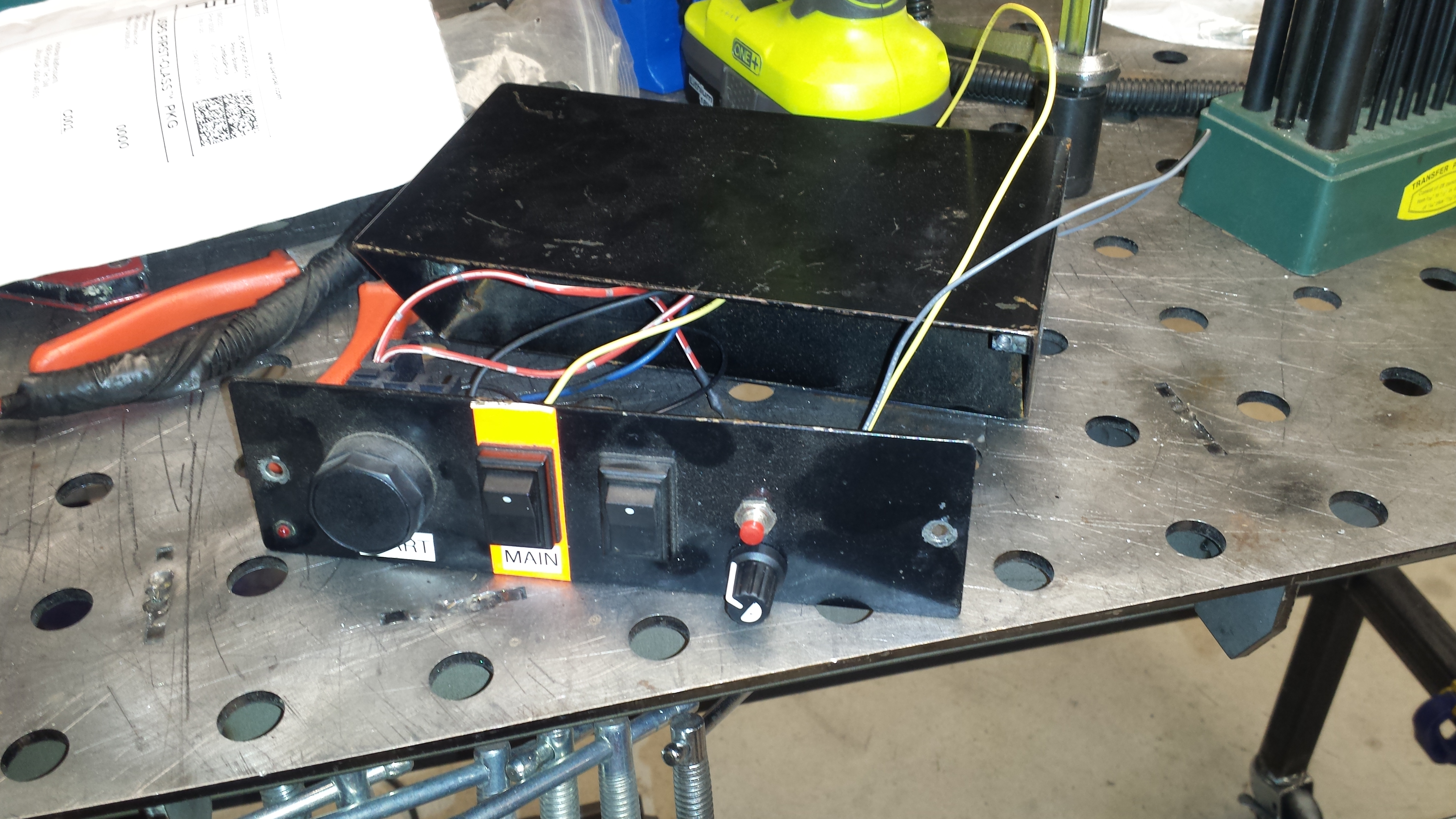

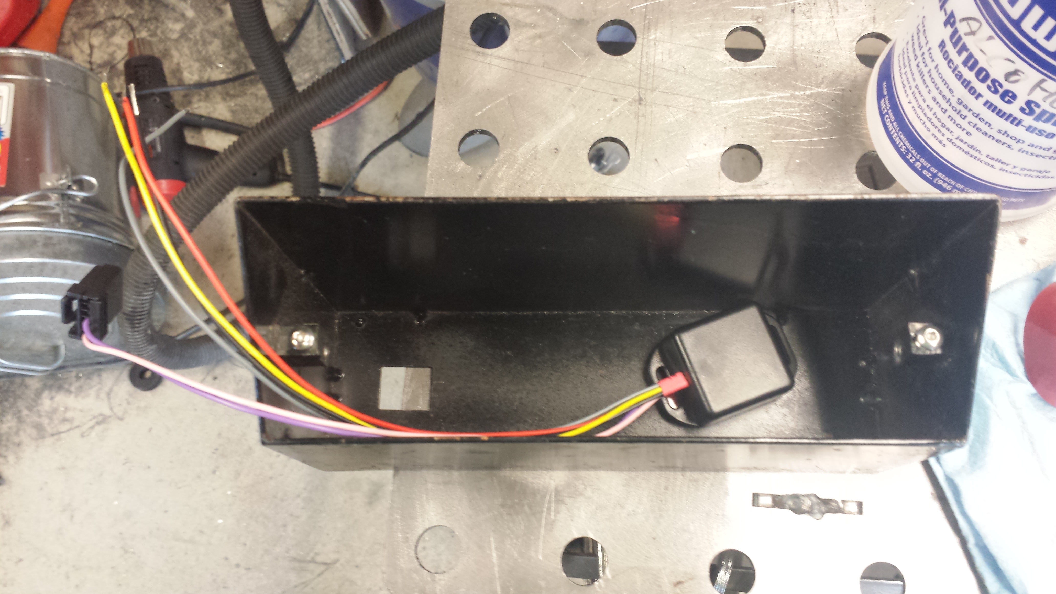

However, I found out recently about a GM electric steering column that's been seeing heavy use in Rally and other offroad racing disciplines, along with a company that sells a controller that spoofs the CanBus signal, and allows you to adjust the amount of steering assist. I've been toying with the idea for a while now, but an autox buddy had one installed in his Ecotec powered Lotus 7 clone and frigging loves it. With some direct experience and some research in the bag, the time has come to start building.

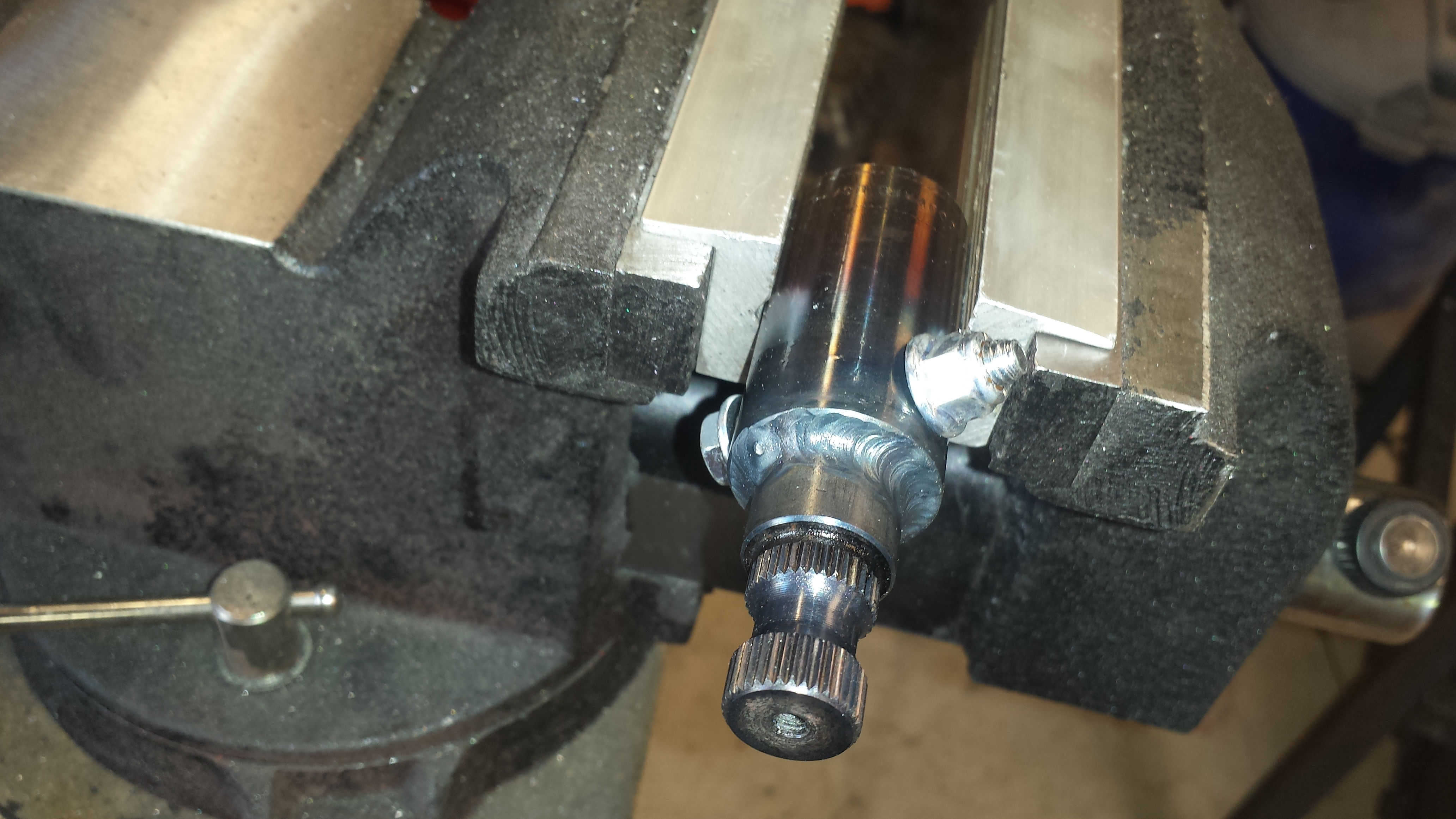

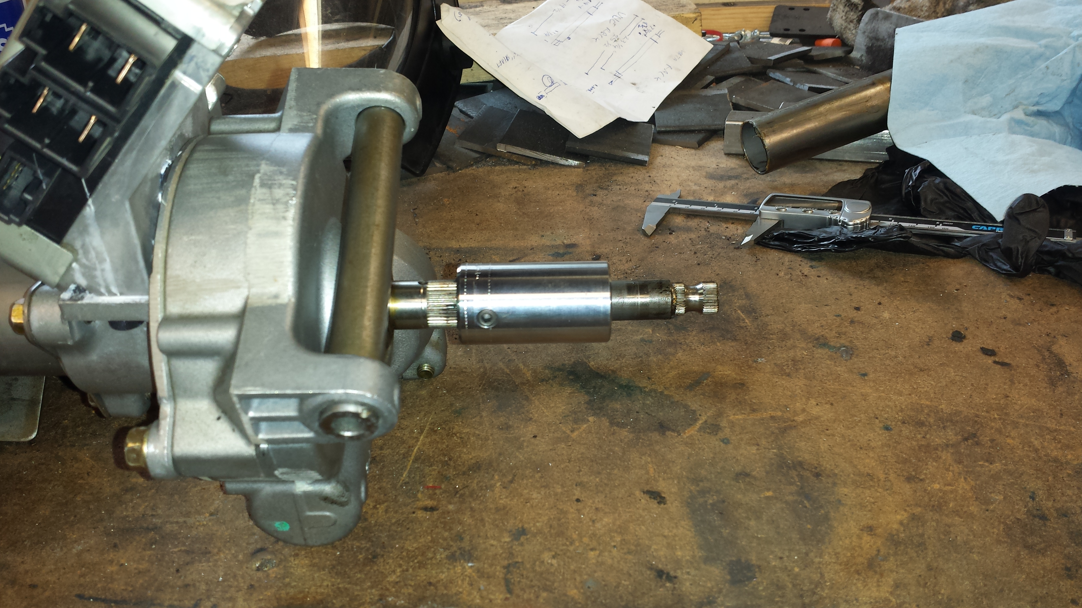

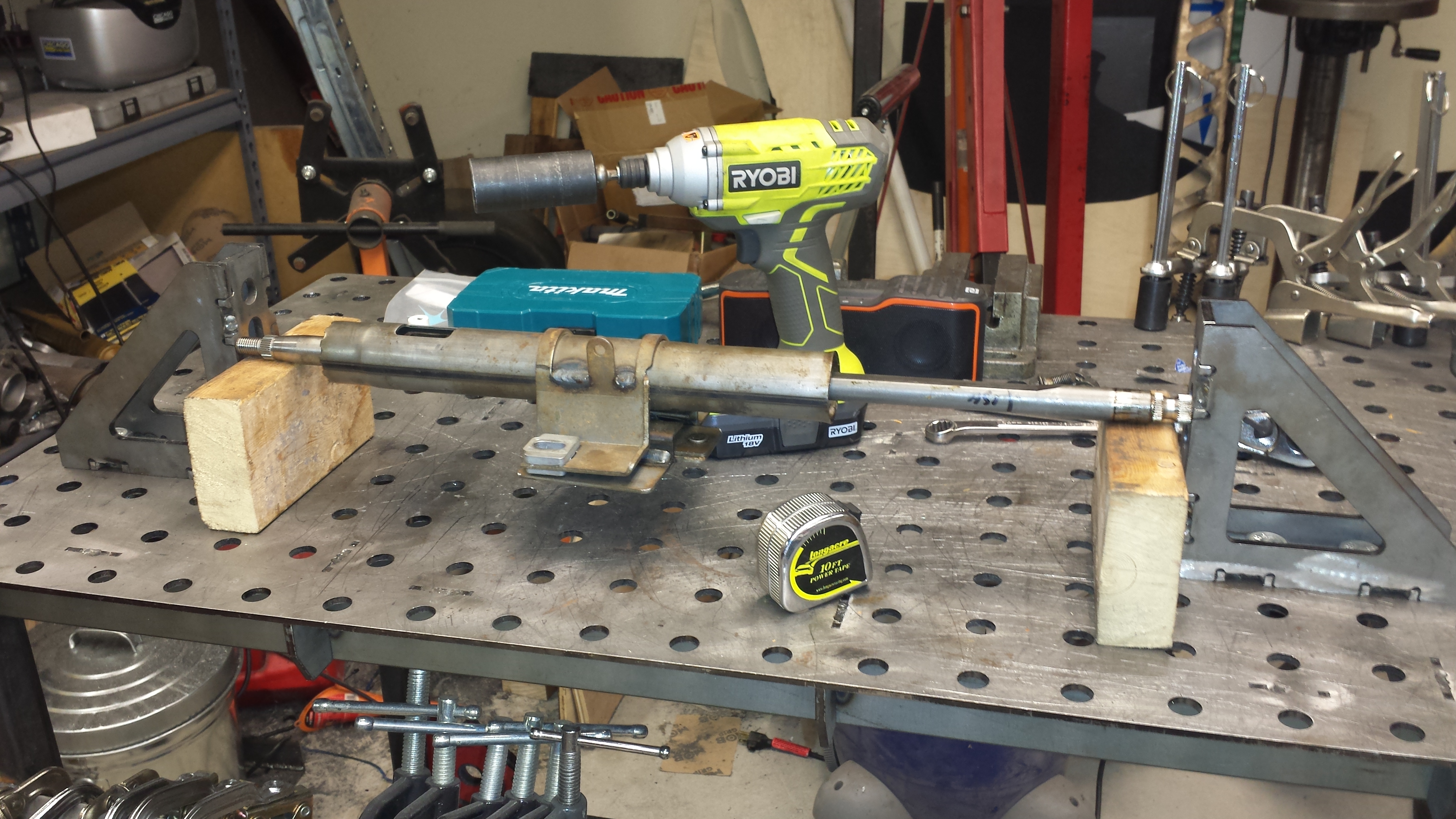

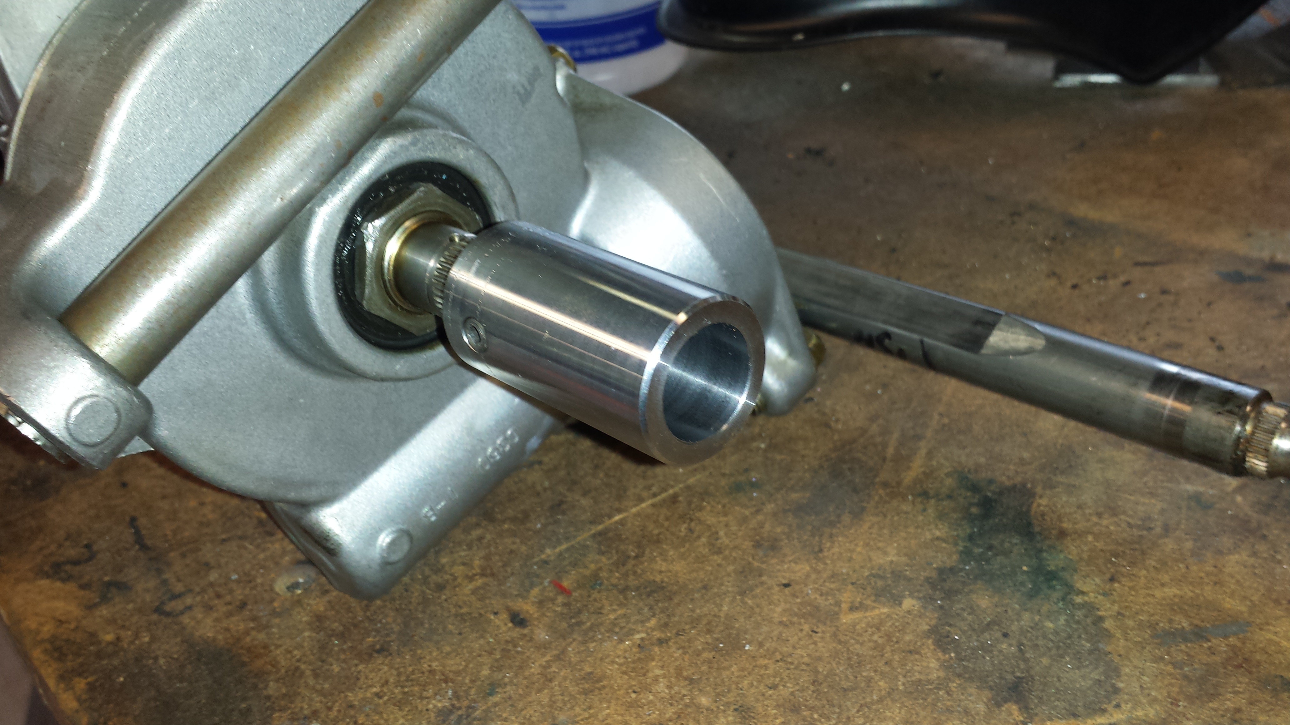

-Fabricate mounts and an intermediate "adapter" to go between the end of the GM rack and the input of the Miata's intermediate shaft.

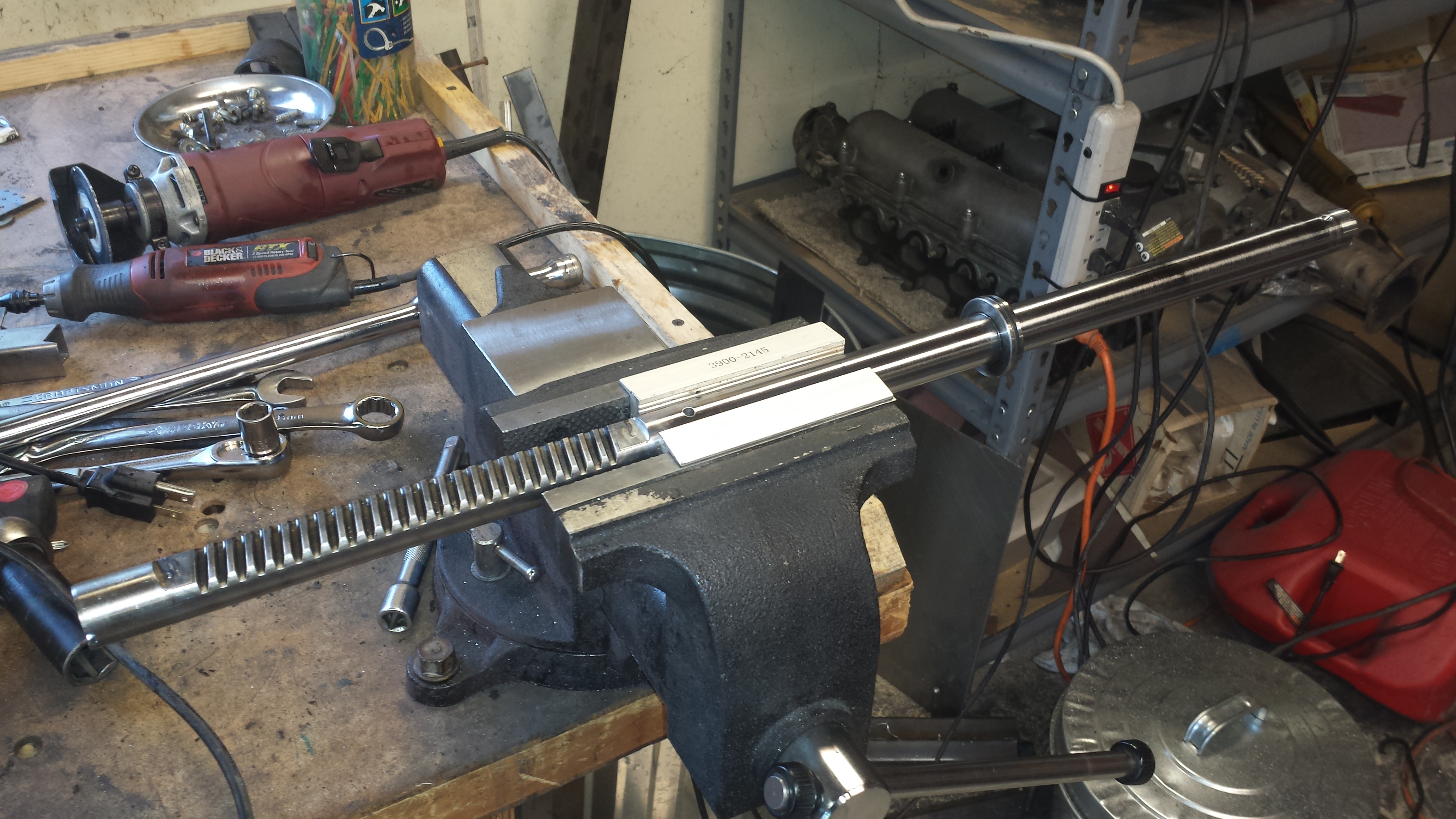

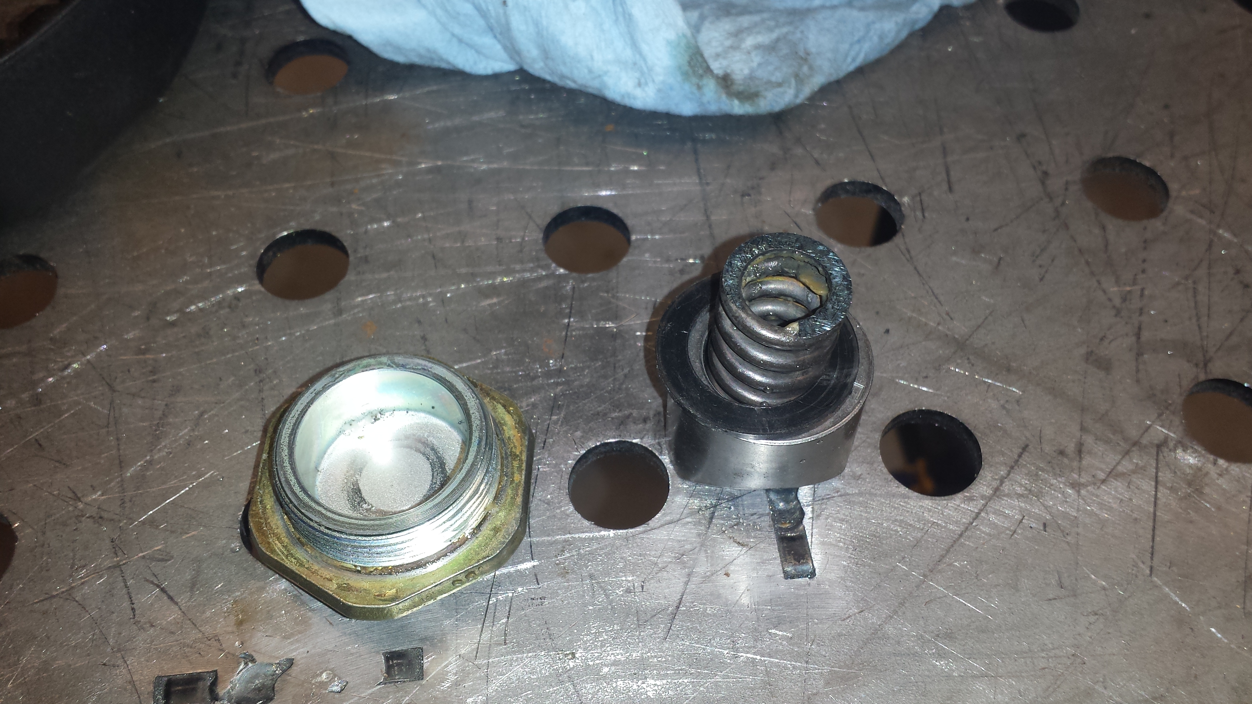

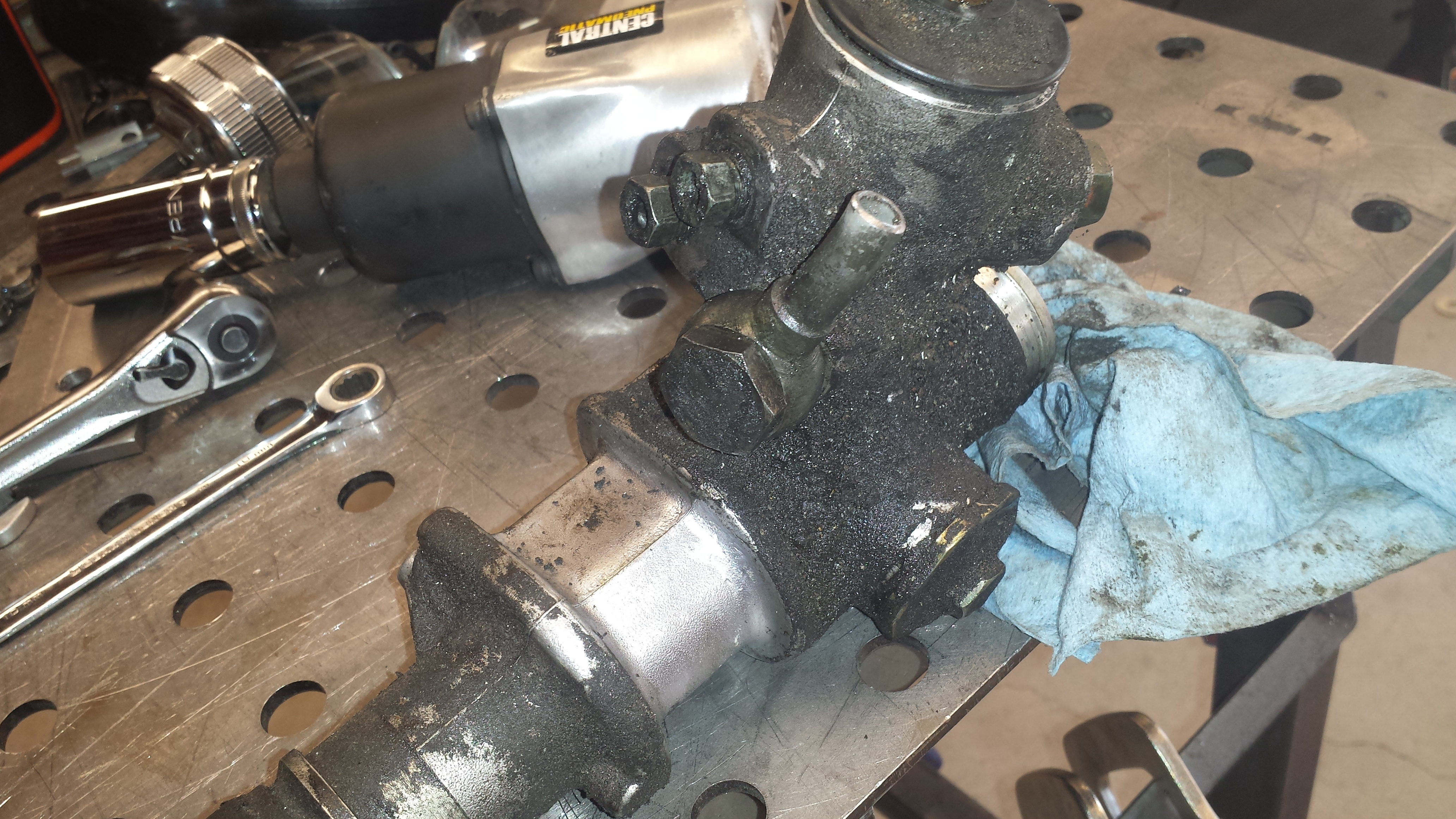

-DePower and refurb the PS rack I've had sitting on the shelf for ages now waiting for its moment to shine.

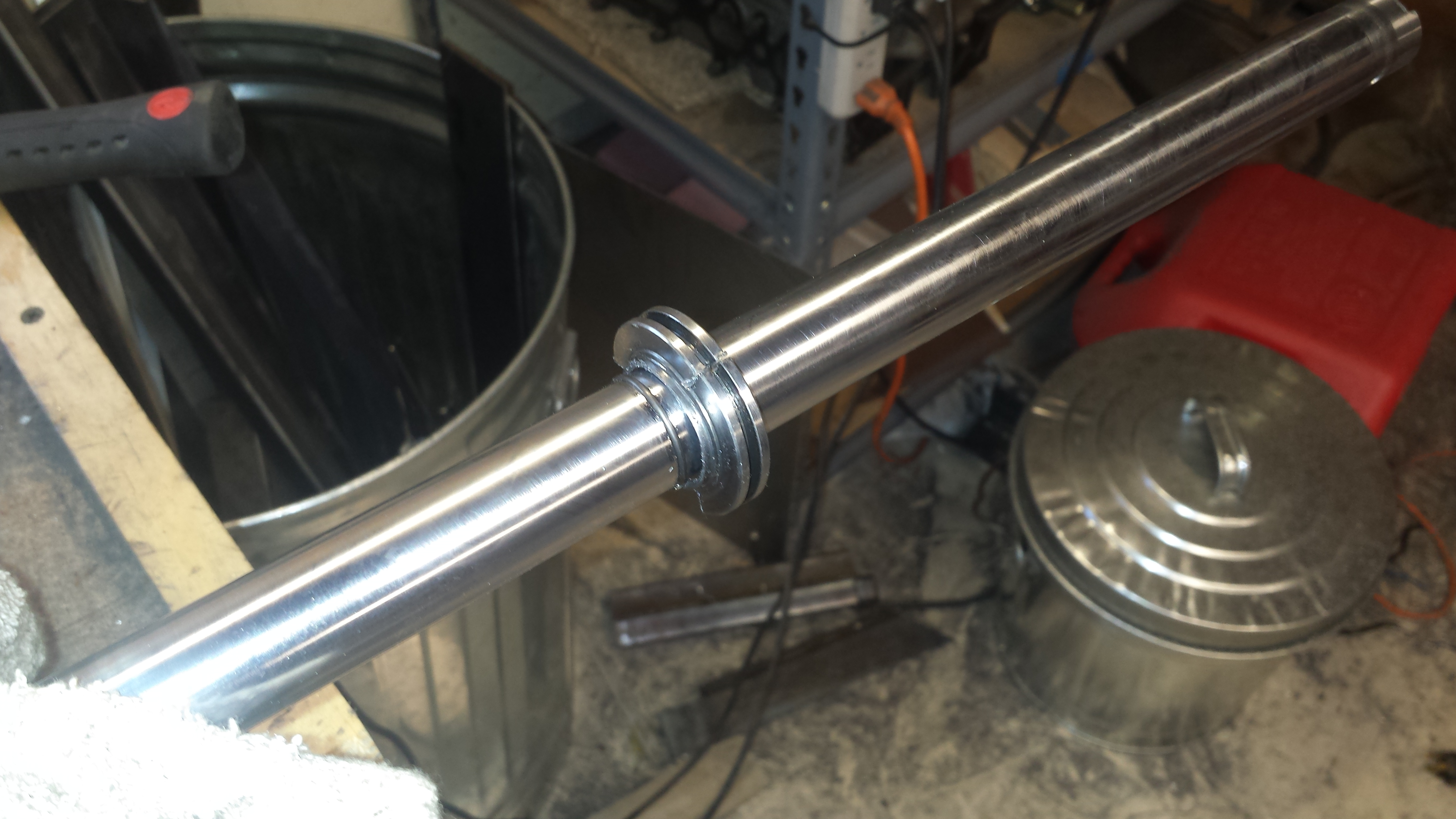

-Add steering rack travel limiters to prevent the 15x10s rubbing on the sway-bar in paddock / grid / during big spins.

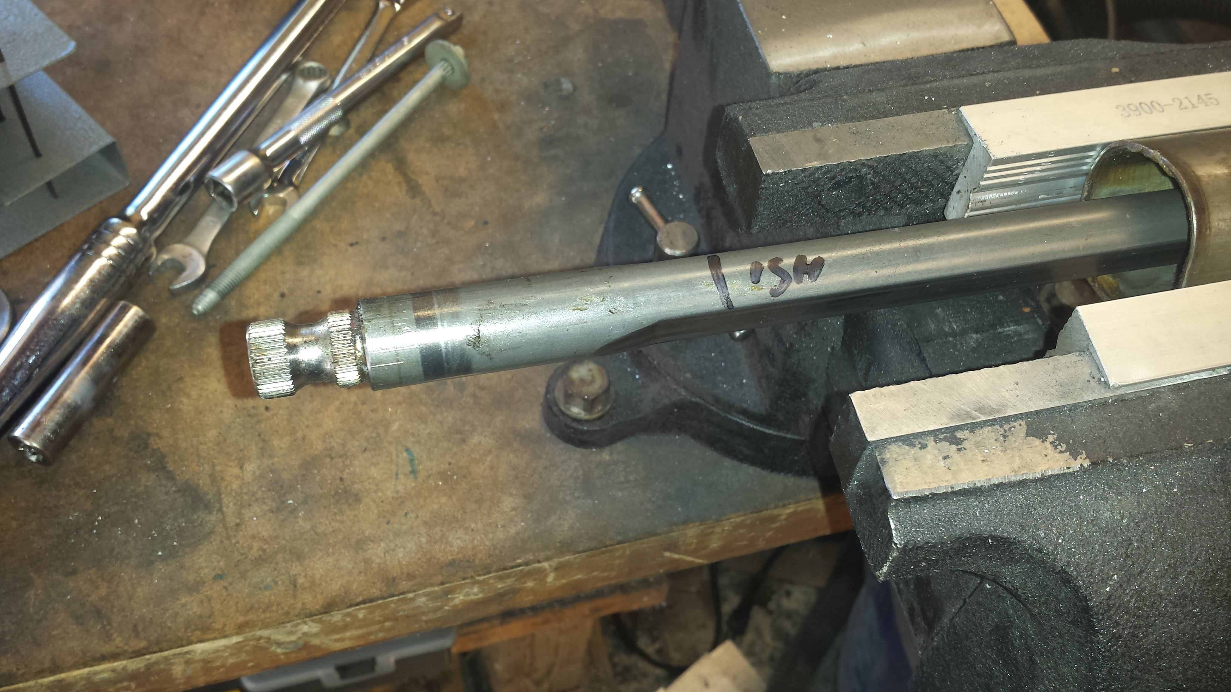

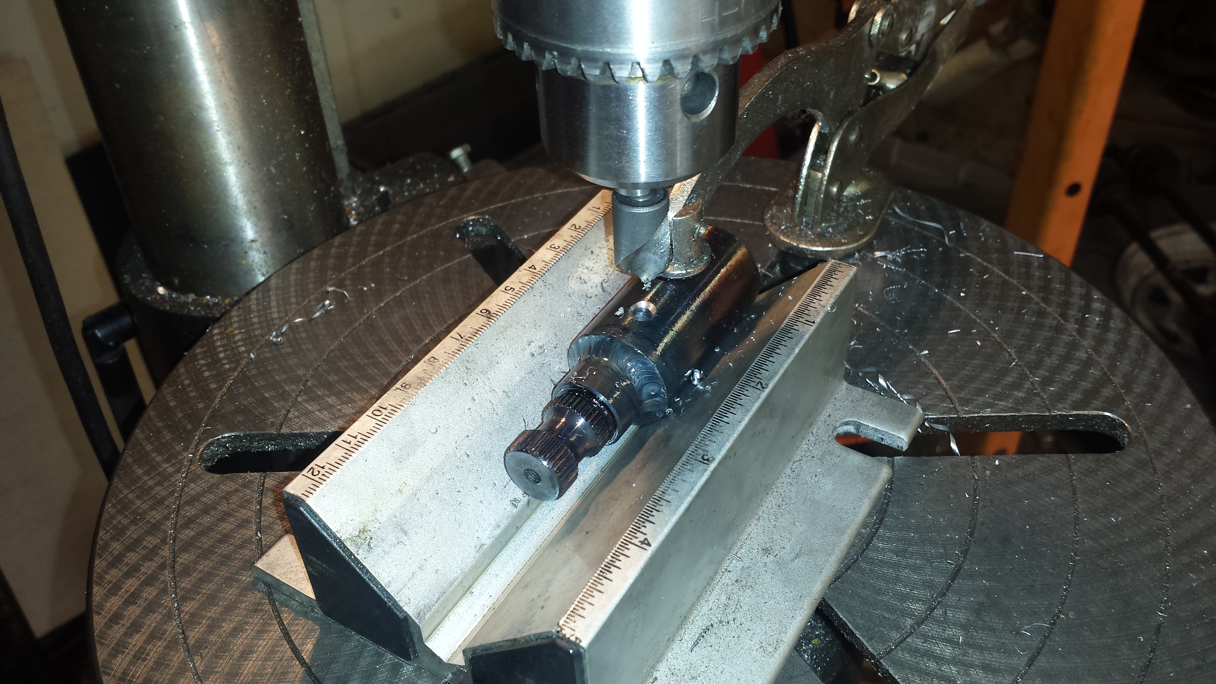

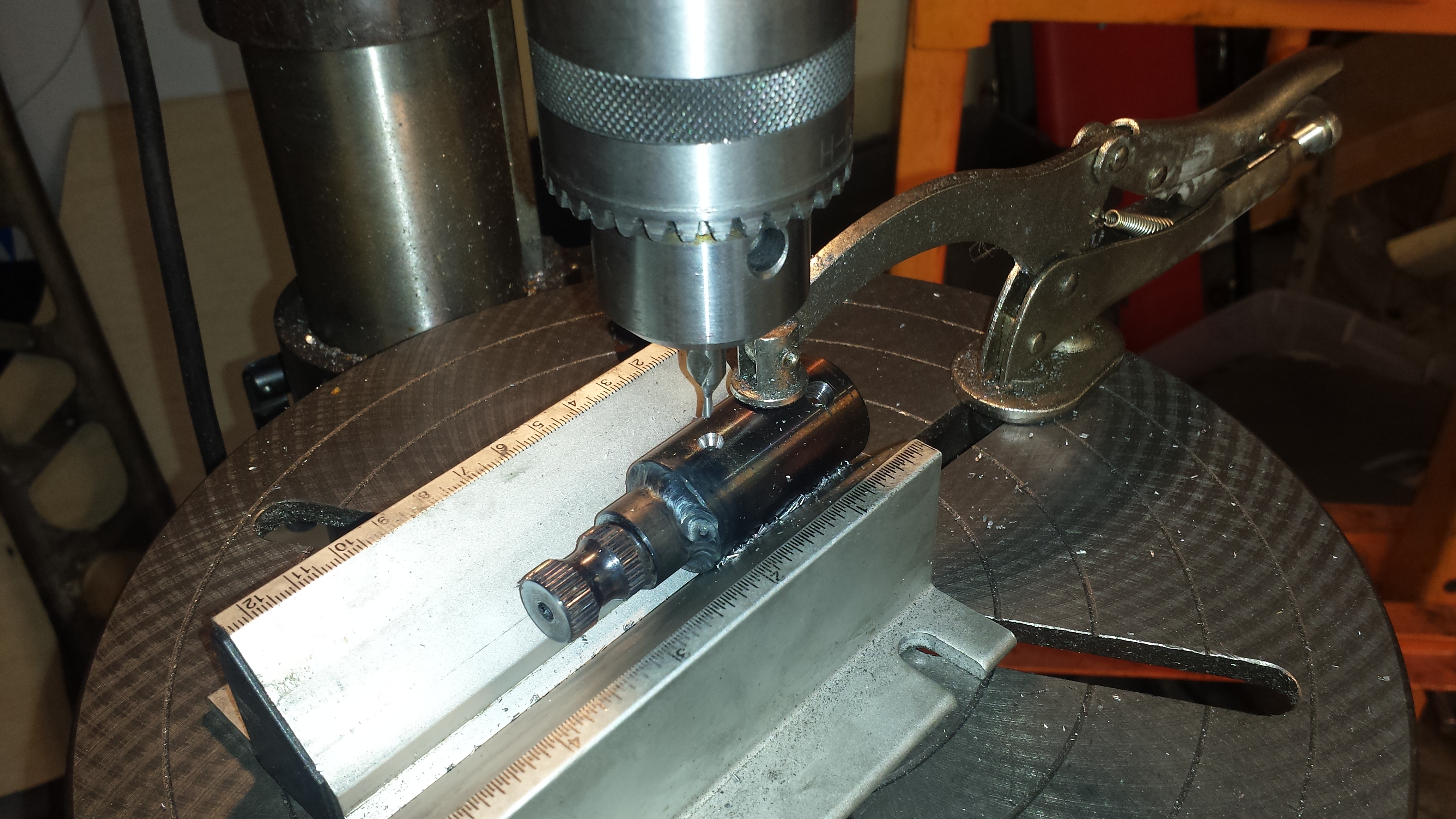

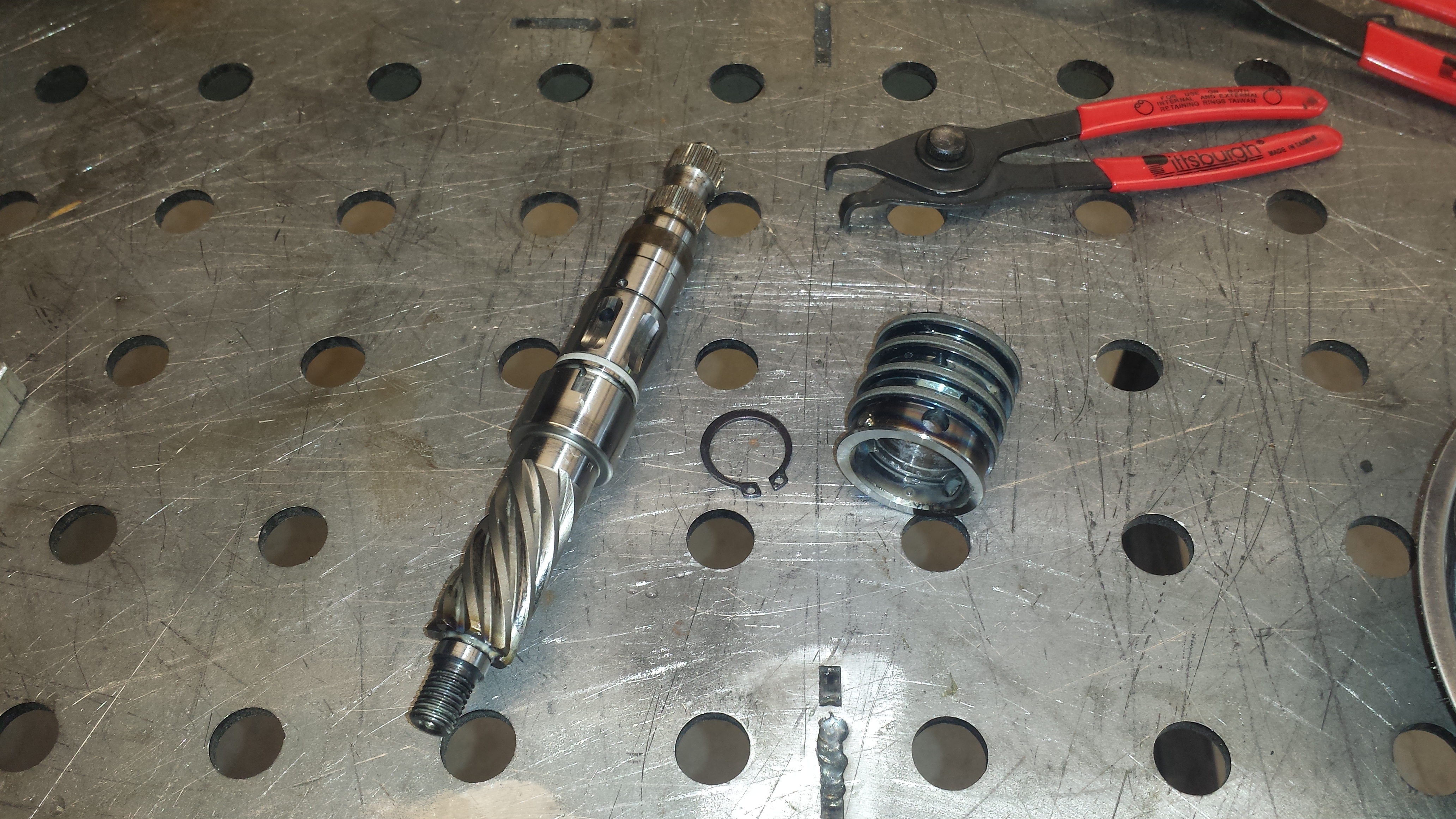

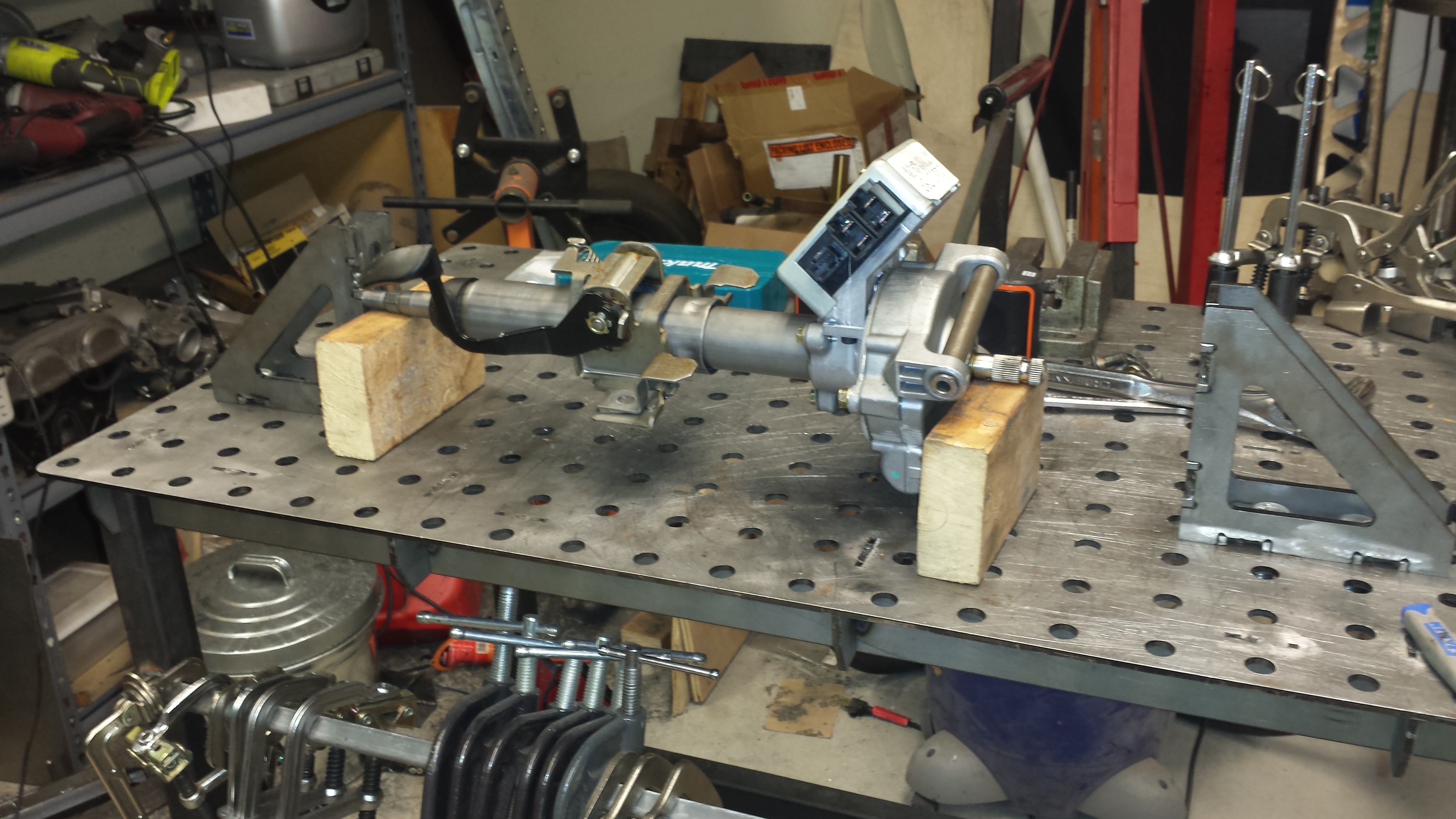

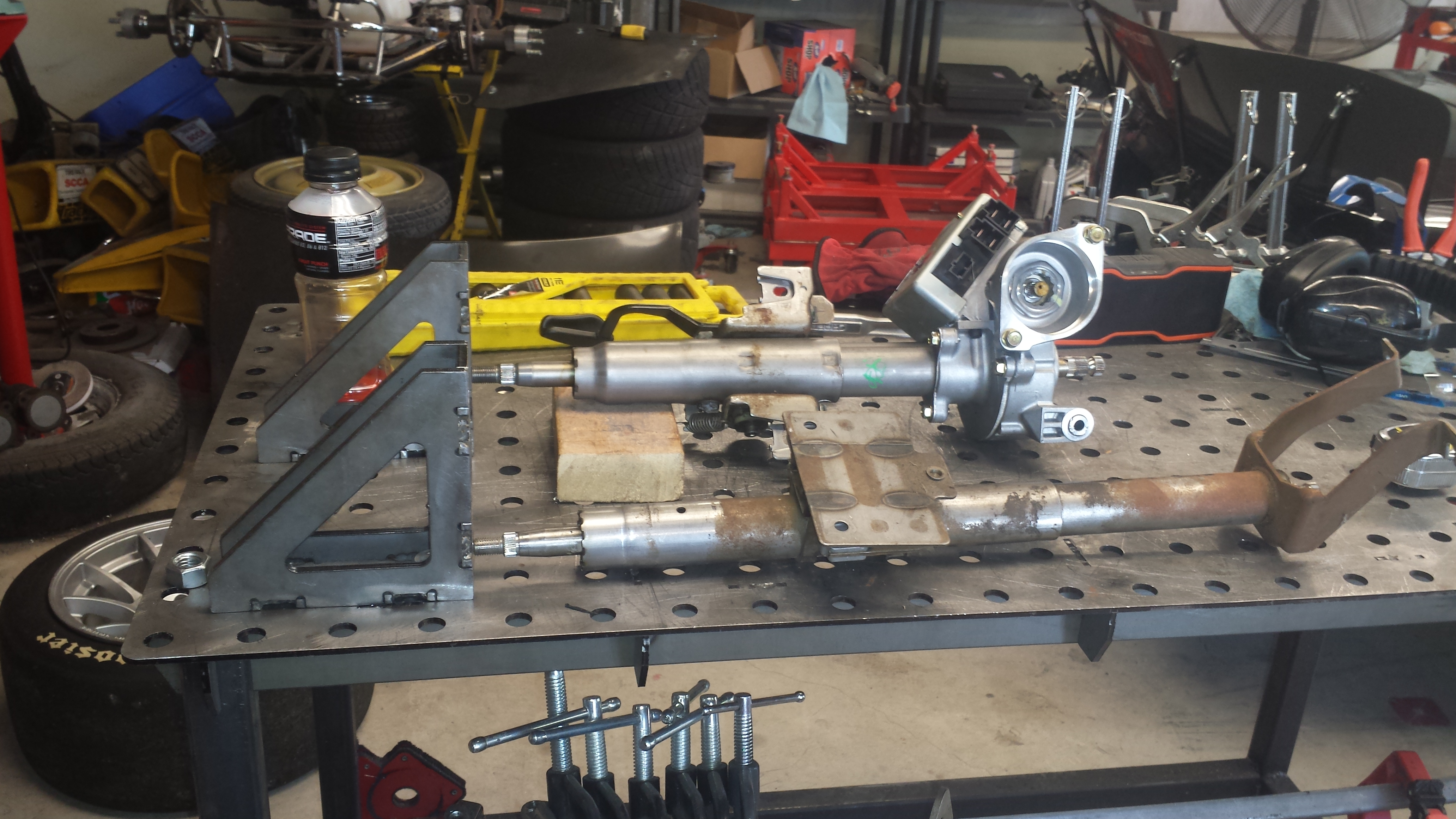

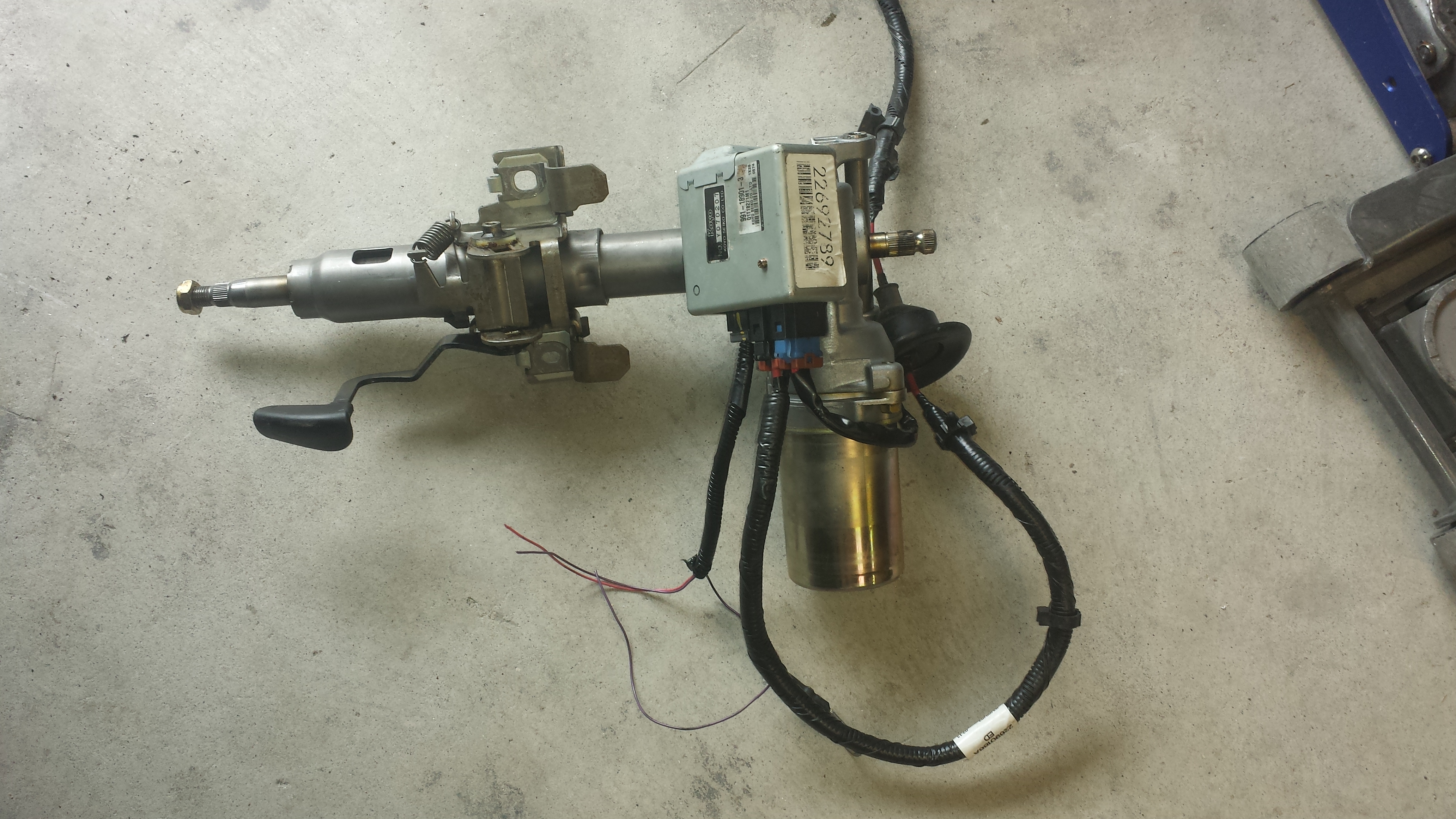

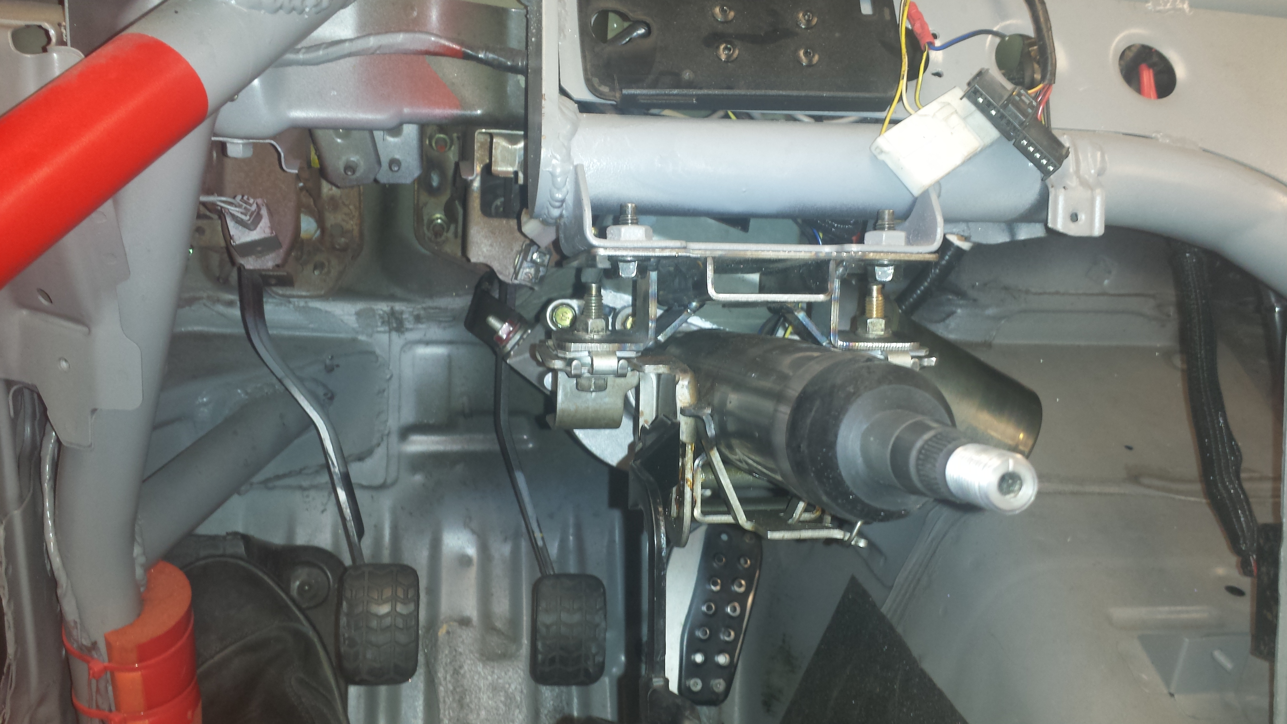

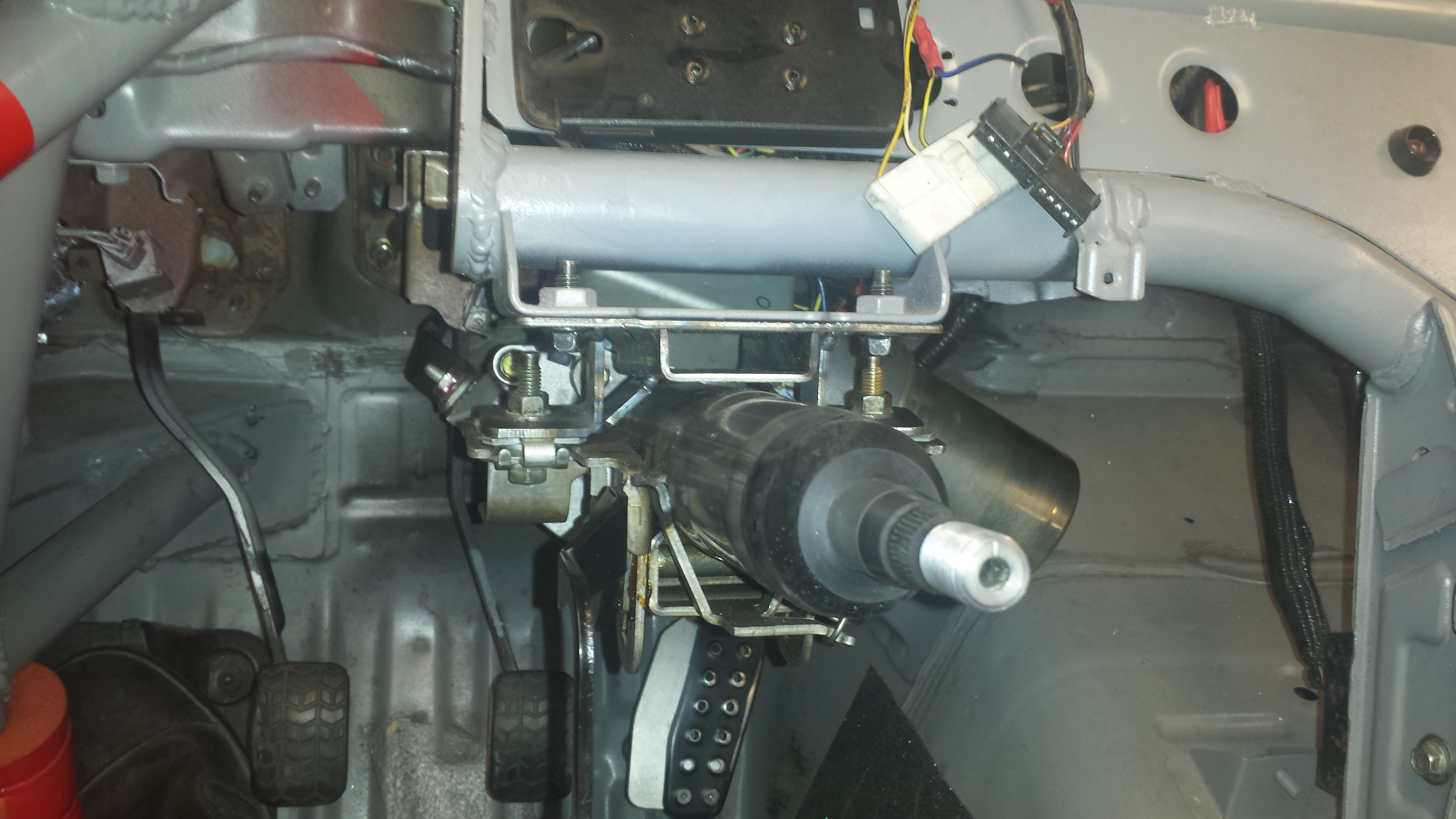

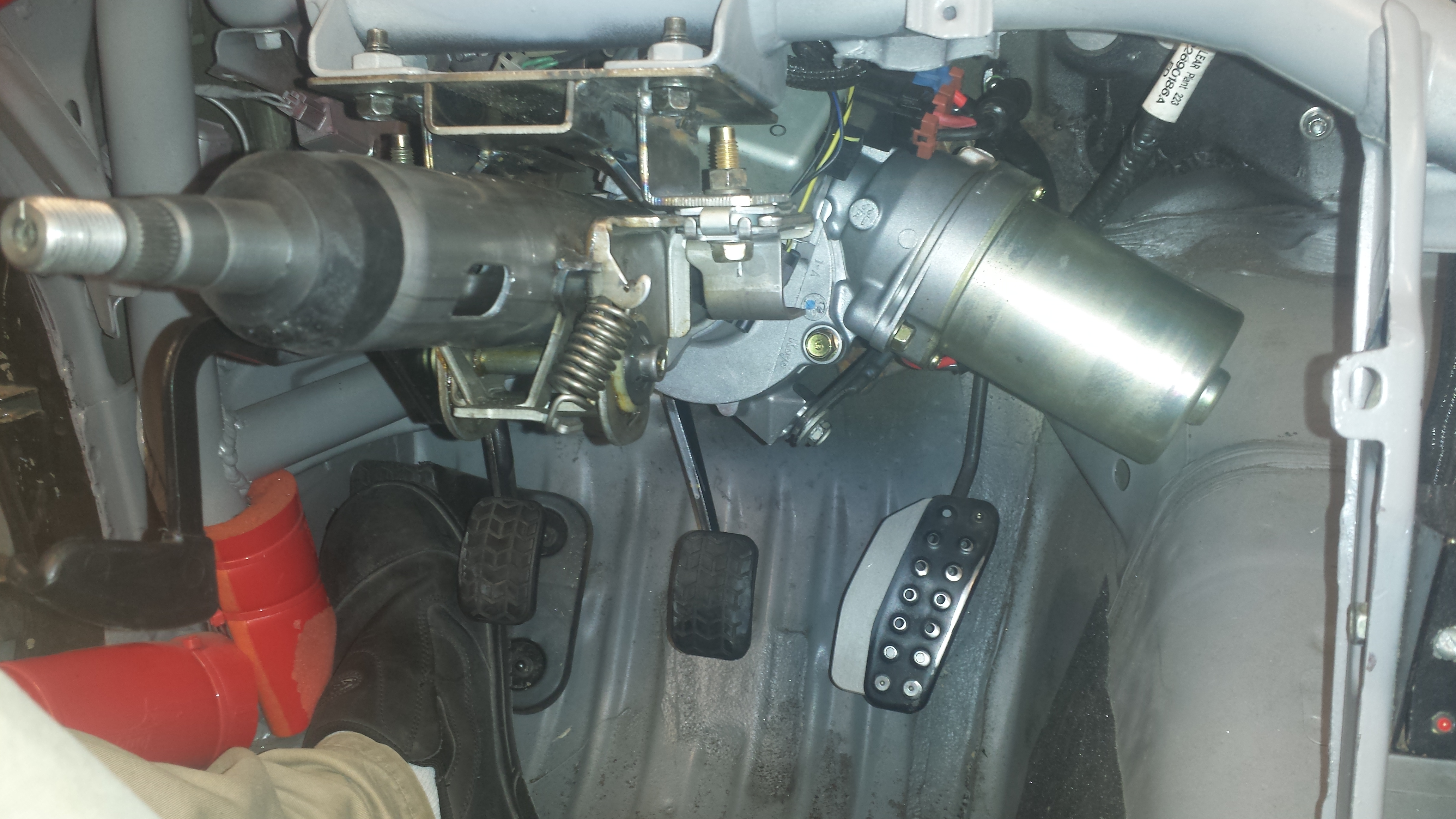

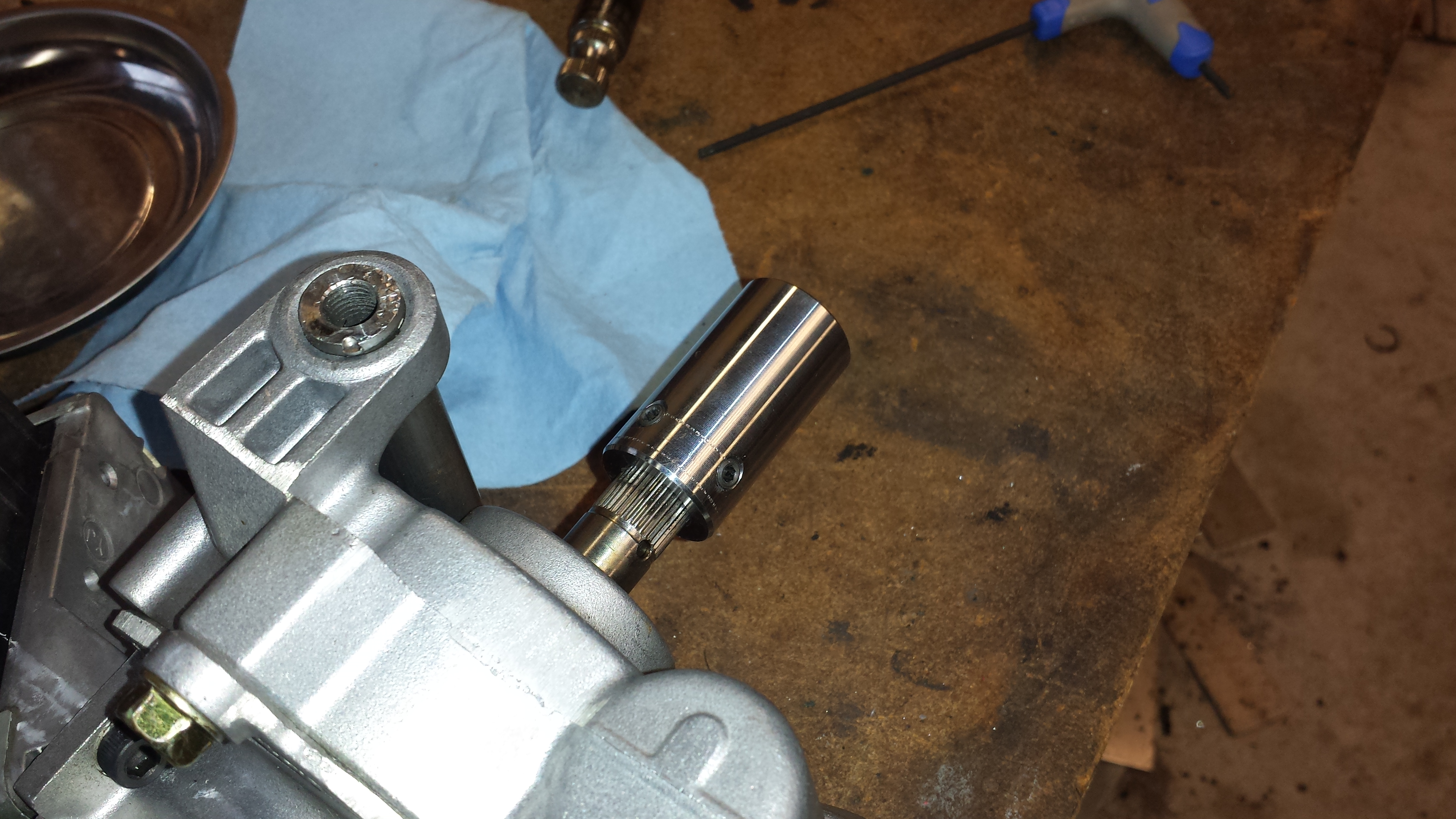

The column in question is out of the Saturn Vue & Chevy Equinox, and is a little over 3" shorter than the stock NA steering column. I went to Pull A Part North and snagged one out of the yard, along with the full wiring harness. The nice thing about that is that they're built for far heavier cars than what I'm putting it into, so it should be plenty.

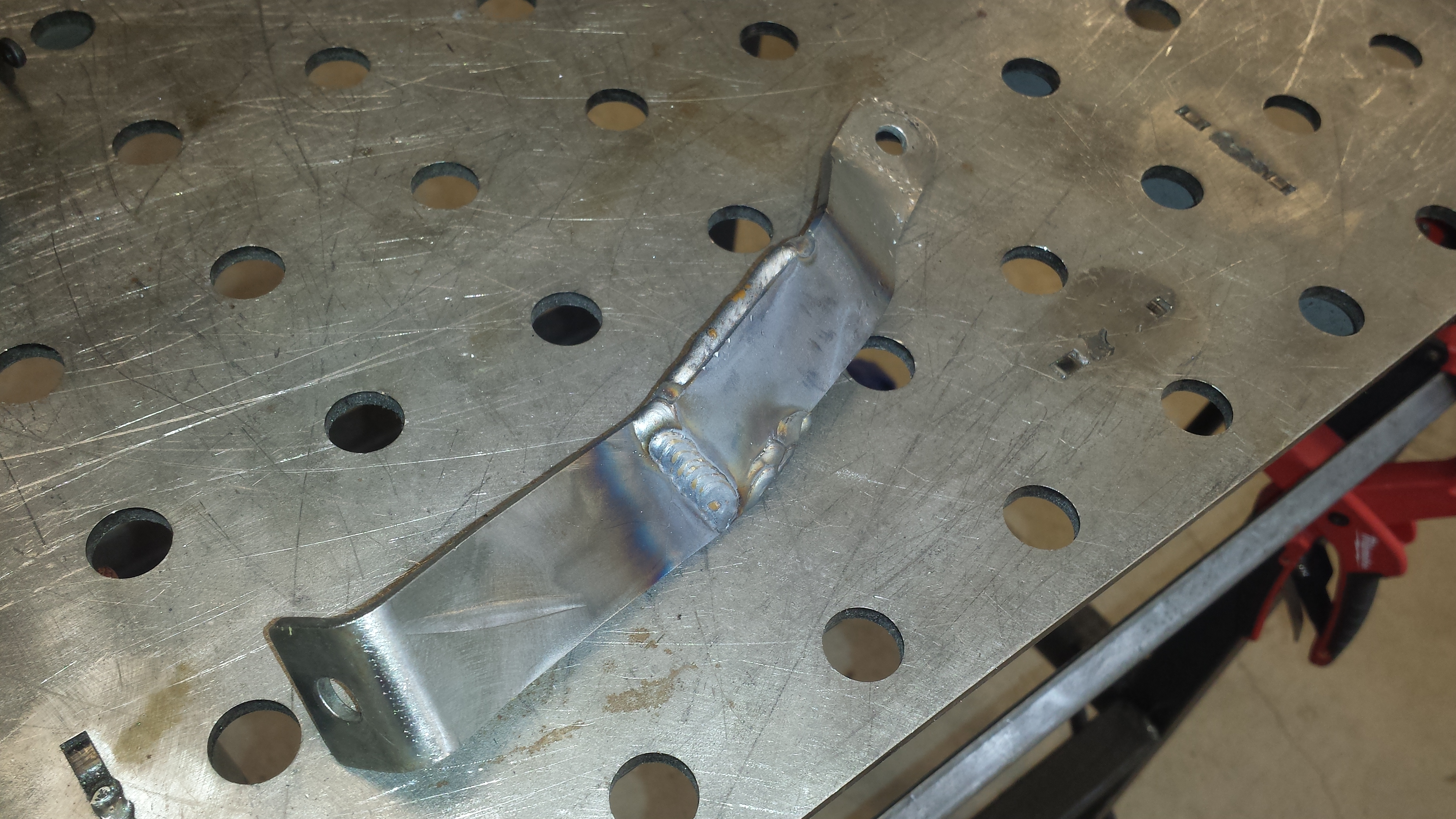

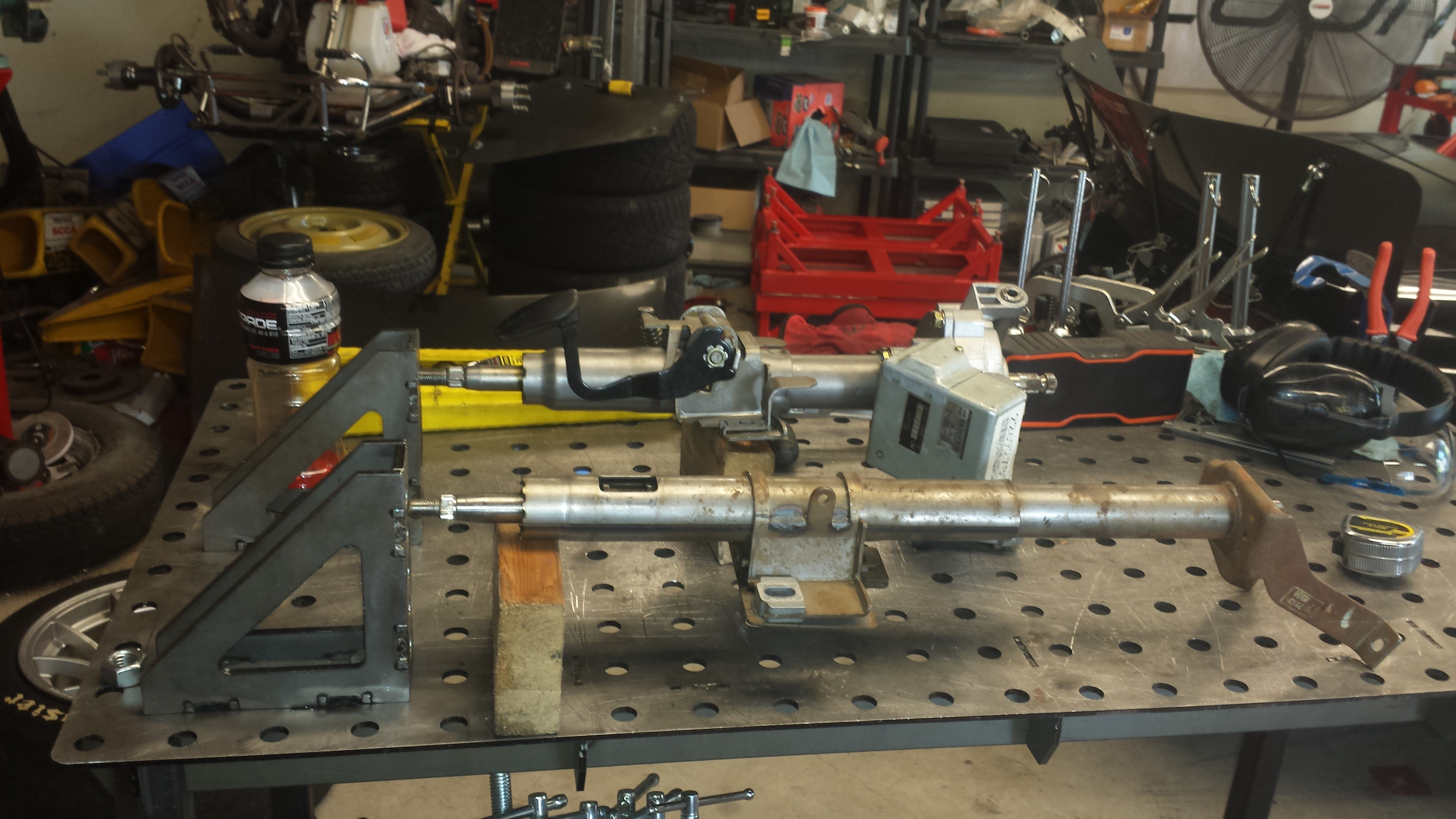

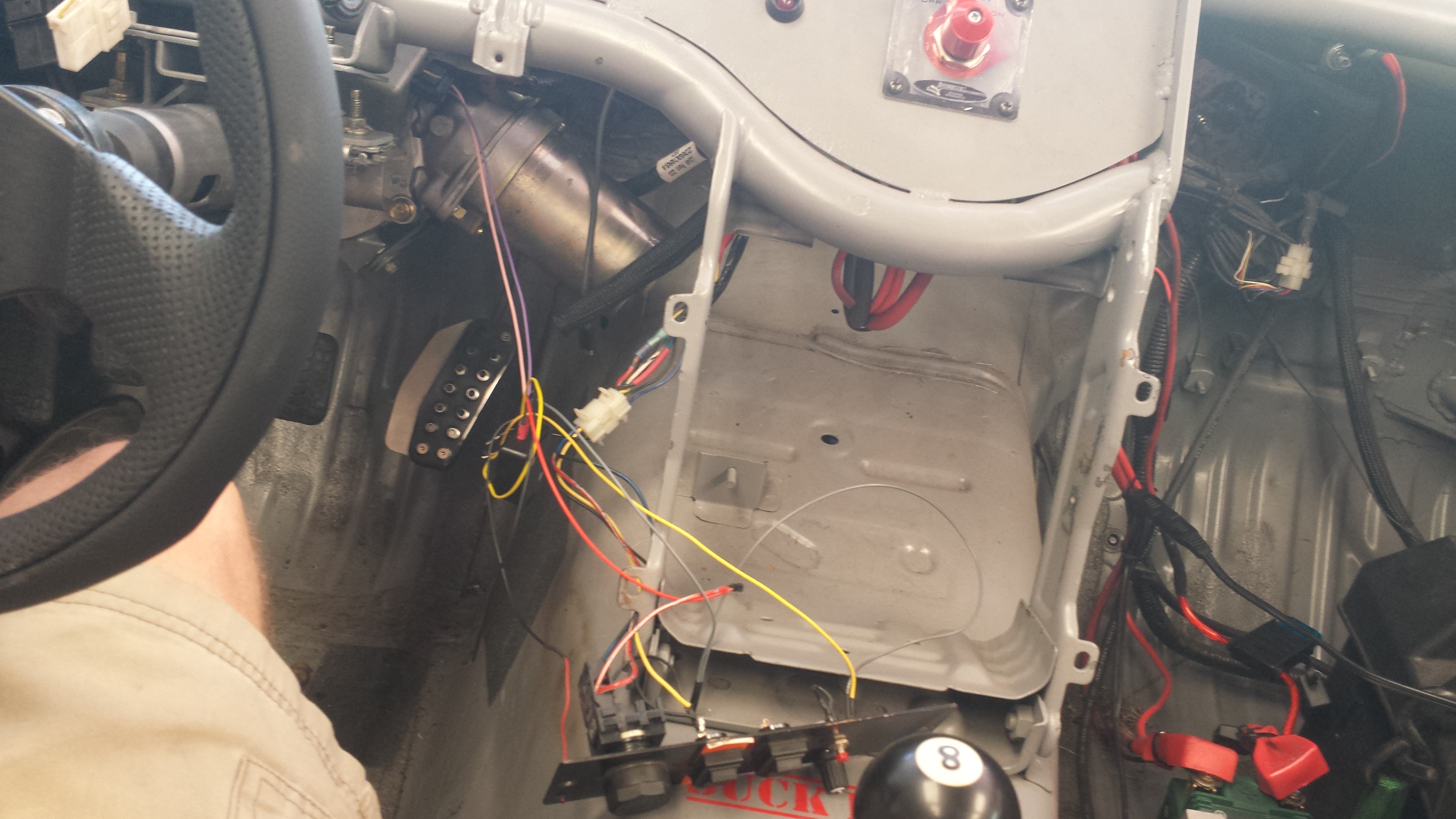

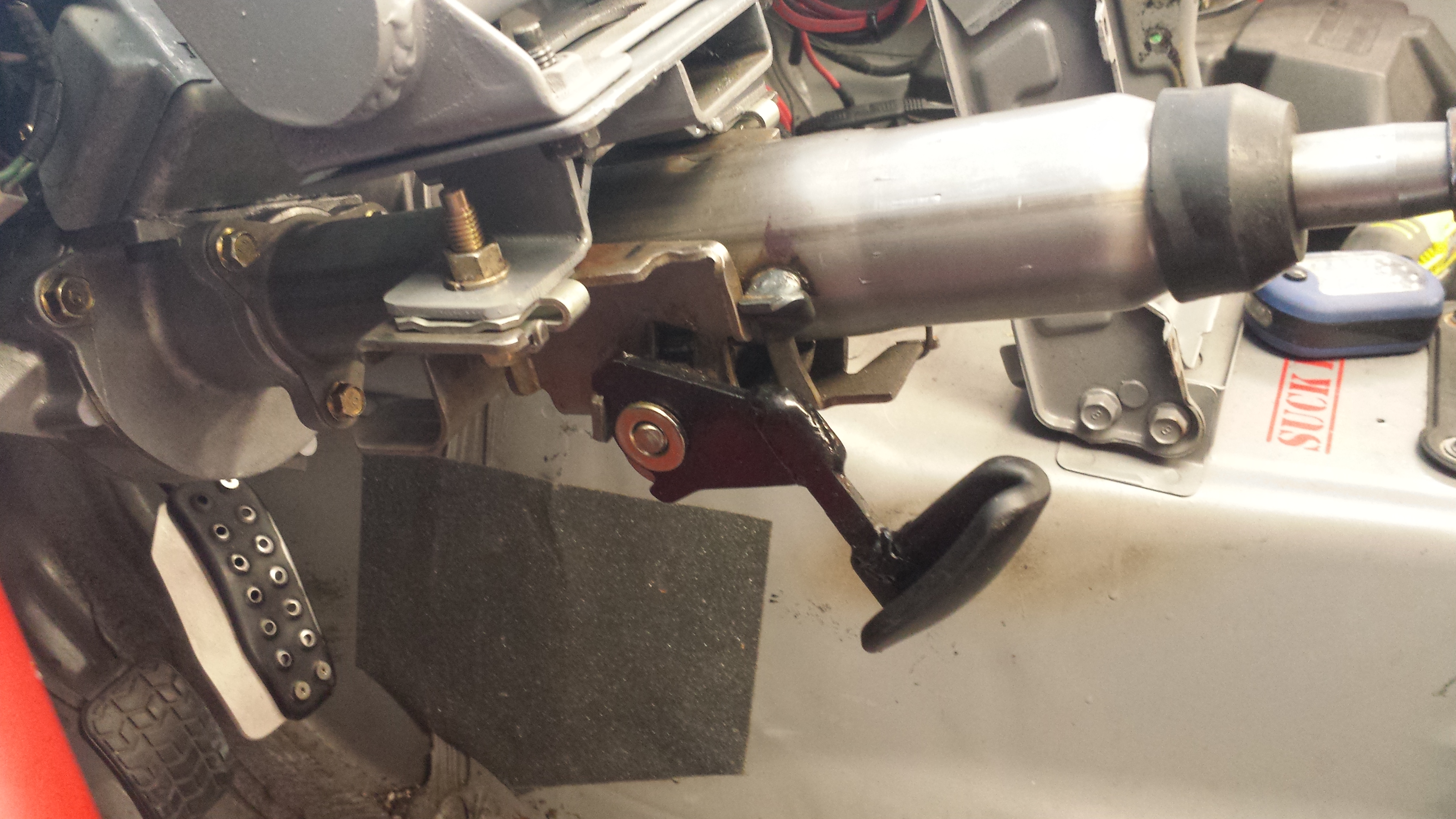

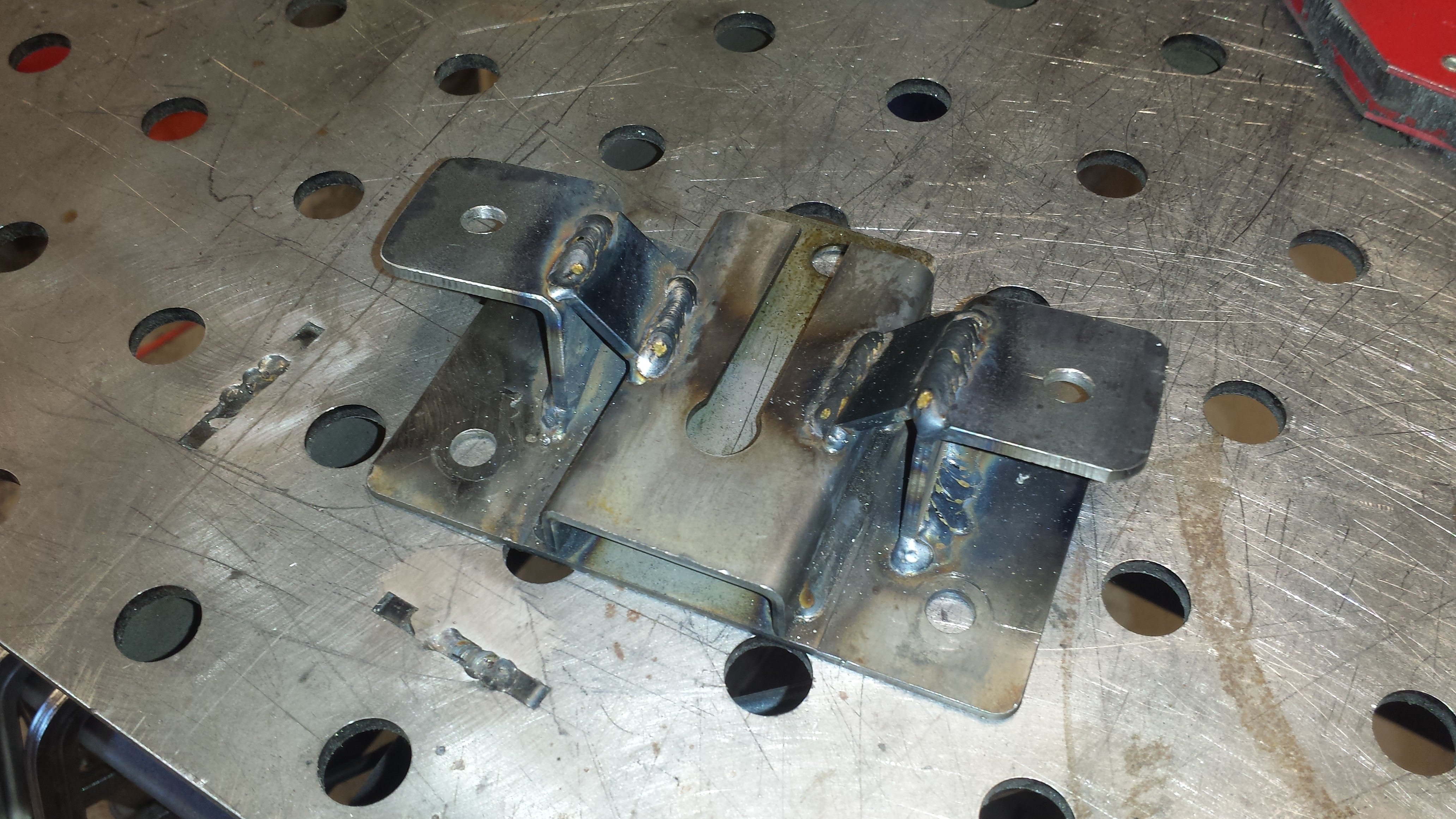

I spent some time this weekend rotating the motor and gearbox housing on the assembly to get it above and out of the footwell. I'm not sure I'm going to be able to keep the tilting functionality, but I definitely want to keep the full, collapsible column for safety reasons. It's available, no reason not to run it. Also the mounts are within an inch or so of where the Miata's mounts are. I'm not sure if I'll try and weld brand new mounts in or make a set that bolt to the factory mounts and then bolt to the GM mounts yet, it'll depend on where everything sits once it's in the car.
