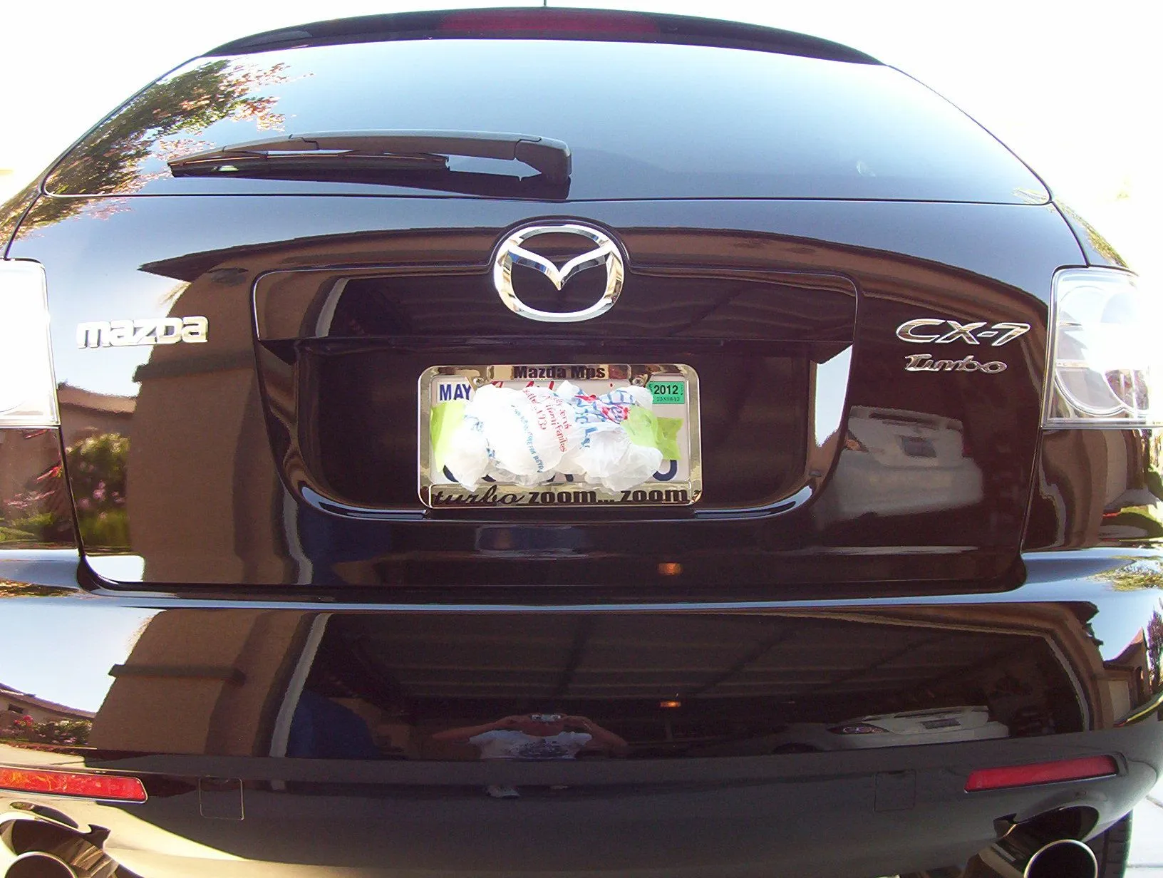

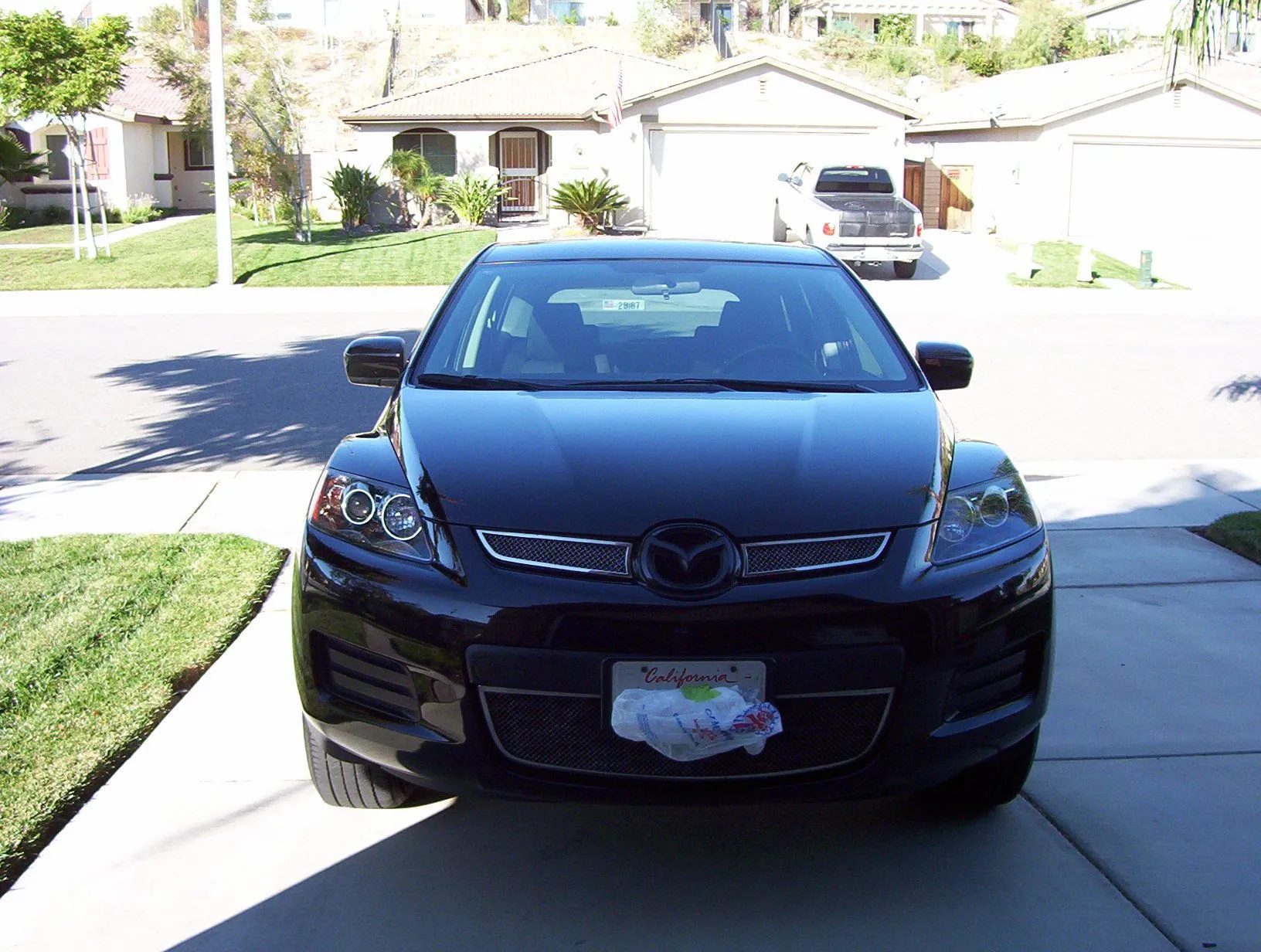

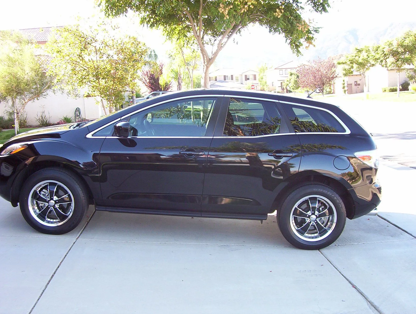

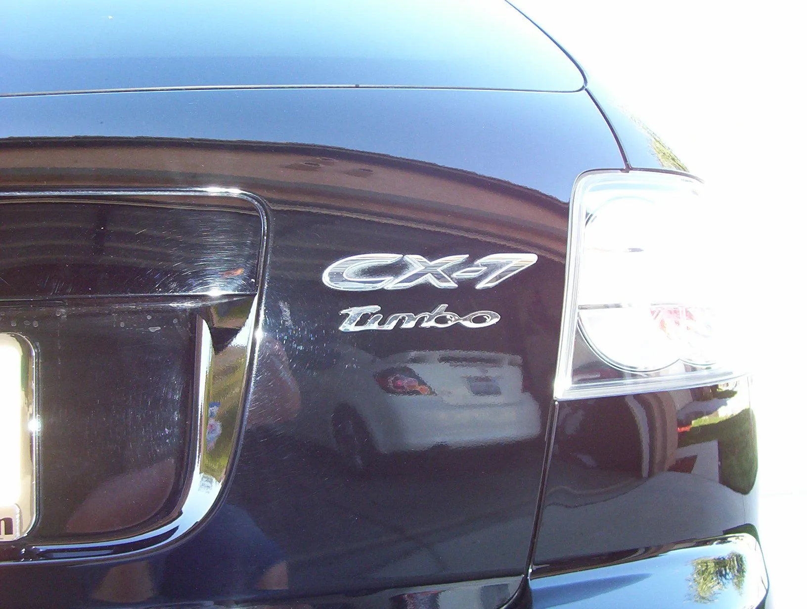

Thought you might like to check out my cx7........let me know what you think...I know its needs to be lowered.........

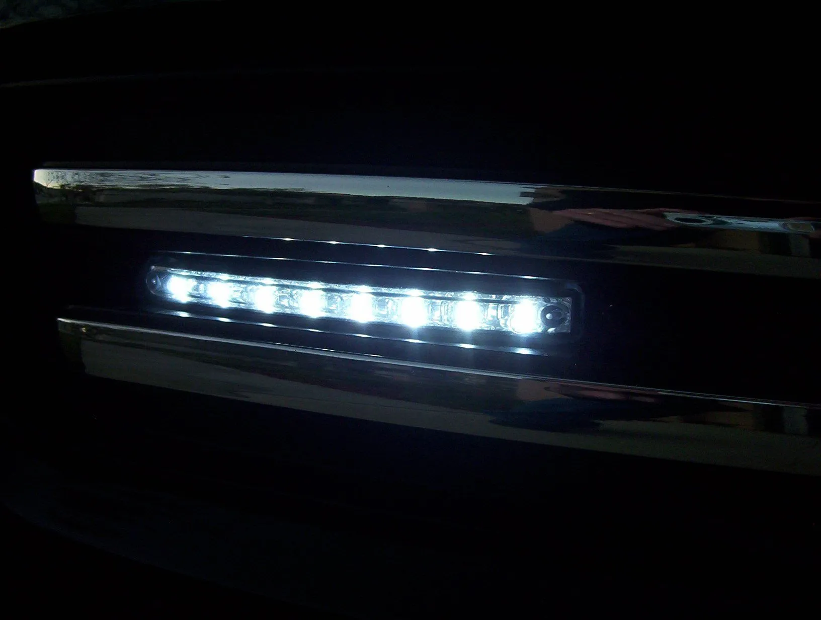

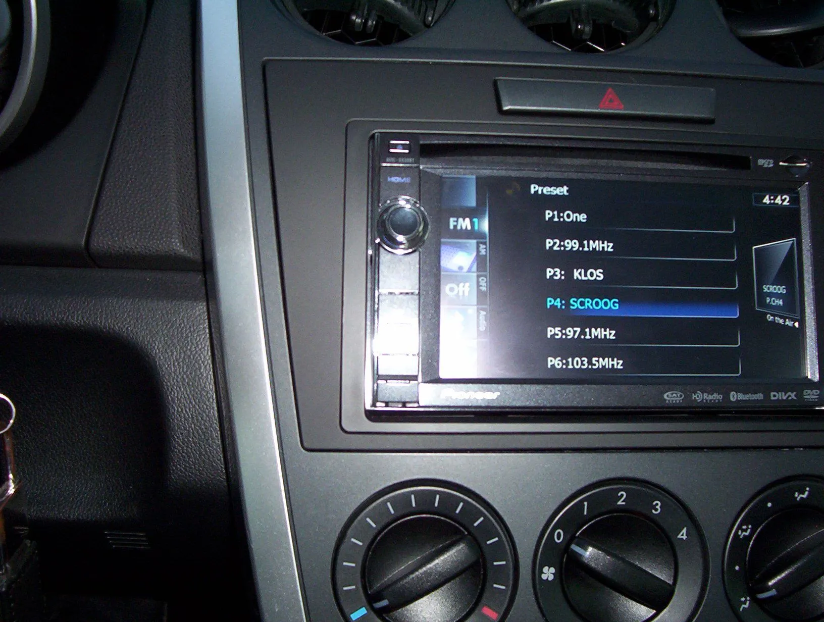

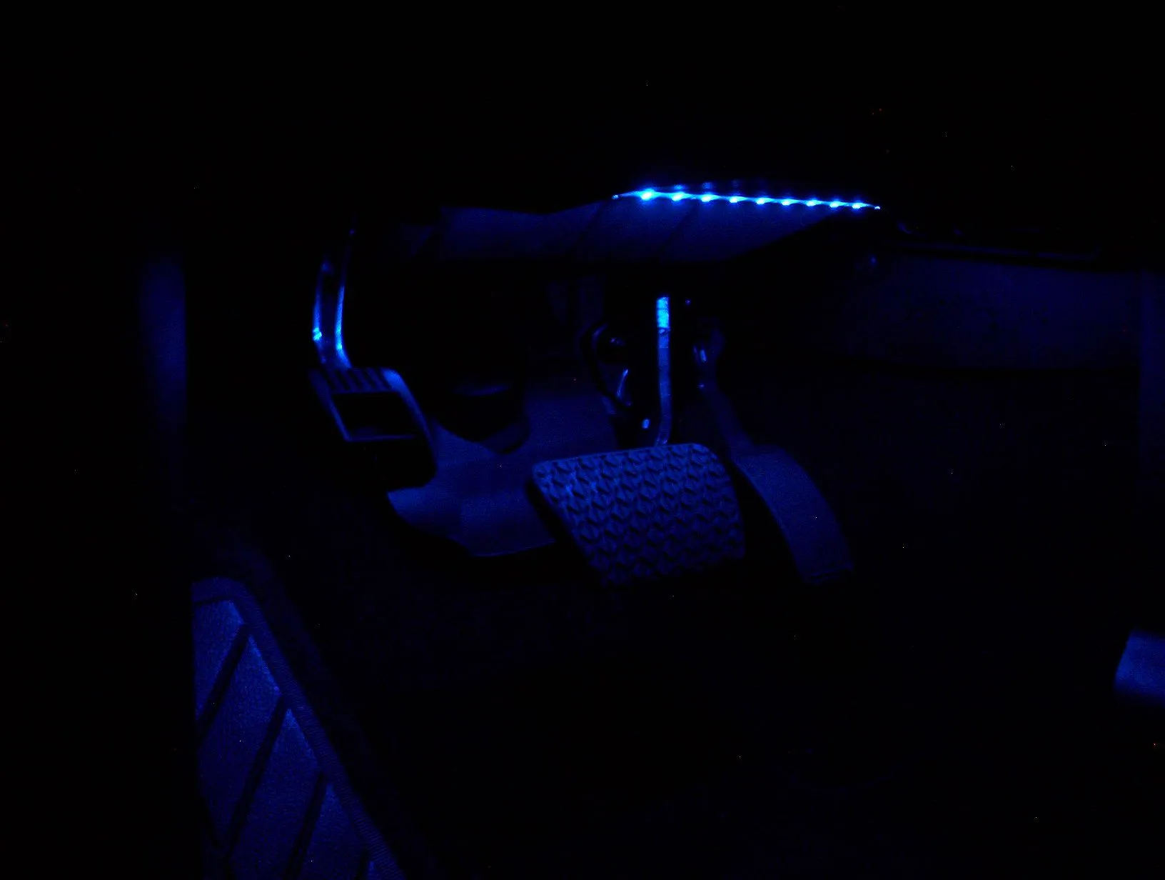

Added some L.E.D. drls and a pioneer nav system and some under dash led lights....check out the craftsmanship...I think i did a factory looking job...im 99% satisfied...

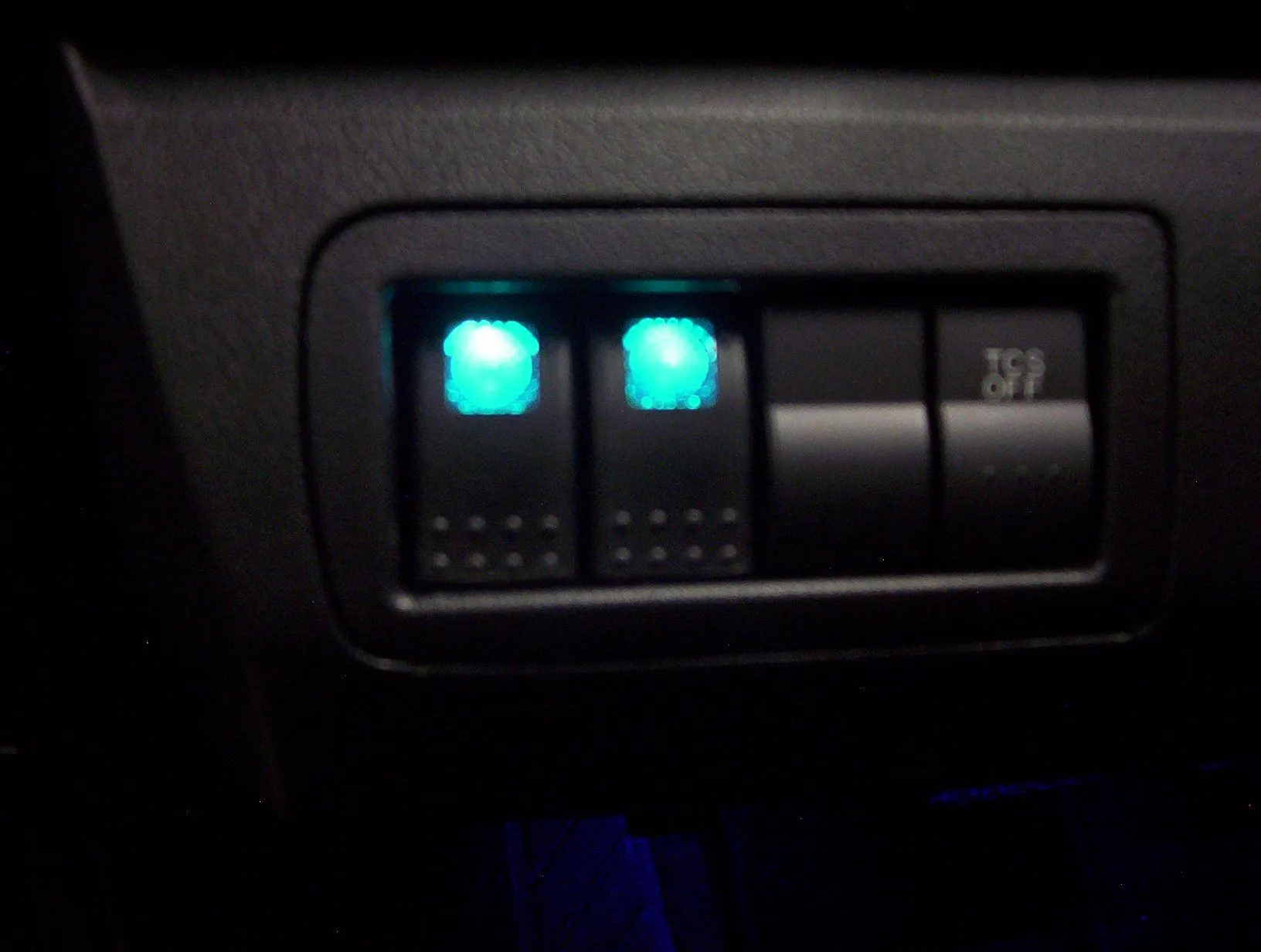

Dem switches!
Hi BLK,
Where did you find the accessory switched that fit in the little switch panel (By the TCS switch)?
Thanks,
Dave
(stash)Hey Dave,
Yeah the switches I found that fit in the dash are full size switches,I found these particular ones at Auto Zone online,You have to modify any swith you put in the dash hole because its a bit of a odd size hole,have to trim out the tabs in the corners of the hole with a razor blade and the switches you need to trim both ends down some to fit in the hole, these are rocker switches and they fit but wont rock unless you trim both ends,I recommend a flat surface and some Emery sand paper and slow precise fitting, checking, sanding etc, It took me a few hours to do it but the more patience you have the better the outcome of the job,And the more feeling of achievement you get,You can look online for something else in full size rockers that might fit better but i spent some time looking and didnt see much.Maybe you can go with factory switches if they have something but you will pay$$....See ya Steve.
