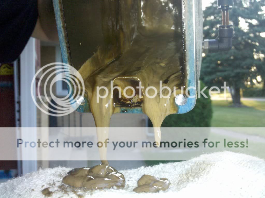

Here is an example of what its catching:

The picture shows what looks to me like an emulsion of water and oil. Put oil, water, and a tiny bit of emulsifier (possibly from blow by gasses) in a can and shake it at high frequency, like in an engine compartment, and that is what you will get. A little oil is visible on top, either separating out of the emulsion or possible separately deposited from oil mist. The more water in the intake (humidity) the more of this stuff that will form. Common wisdom is that "oil and water don't mix", but that goes out the window when you start adding unknown other chemicals to the mix and shake the hell out of it. That goop doesn't look like sludge to me, as sludge is much darker.
Edit: After a bit of research, it turns out that emulsifiers are a normal component of motor oil, so this is exactly what one should expect to see whenever one shakes a can with car oil and a bit of water in it.
Never had any of that kind of s*** in my catch can, only oil.....and it has no breather cap on it either, only a drain nut on the bottom. The motor "breathes" the same way just a longer route between the PCV and intake manifold with the can in the middle.

I have an OBX can, chrome in bottom right of pic. Car is NA & it took 8-10 months for it to get less than half full the only time I ever emptied it when the car was daily driven. It had nothing but oil in it, none of that beige pudding like in the pic above and no seperate sections of water and oil either just oil. It hasn't even gotten any on the sight glass since then due to not driving it that often. Yeah, if your's is puffing on startup then a can will do nothing.
Pudding picture looks like a blown head gasket to me.
