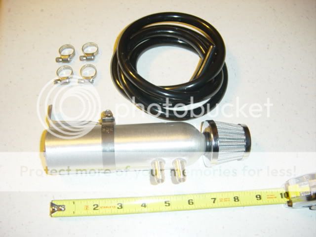

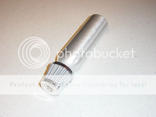

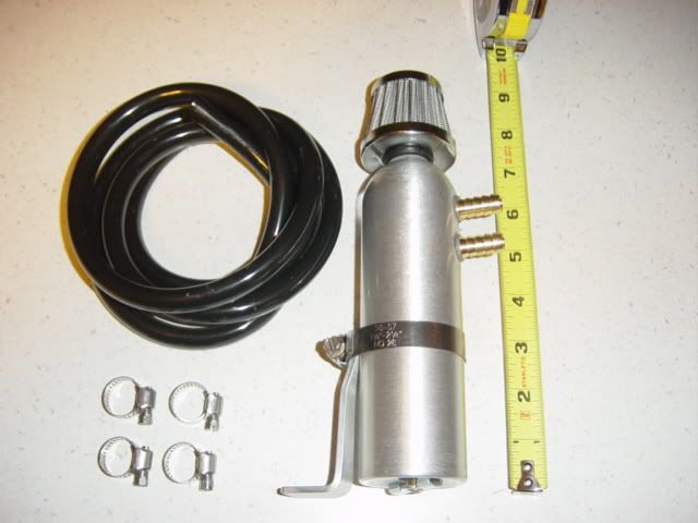

People have used the battery tray bolt to mount the can. Its a great spot since it allows proper routing of the lines. There are a ton of pictures in my thread if you want to see more. I also just designed a "MINI" if you are interested. Its one of a kind, internally baffled and just needs the fittings of your choice. For $39 shipped, it comes with everything needed. Perfect for extra tight spaces. Heres the photo of it waiting for fittings to be installed. If hooking up to the stock system, I recommend 3/8". Dimensions are 2" diameter and 8.25" tall.

Sorry for being dense, is that an oil catch can? The little one in a later post too? (A ruler in the picture would help us judge how big these are. It is not a standard part so we can't just go out and look under the hood.)
Do these need to be emptied periodically, or is there a tube that lets the oil drain back into the motor?

Yup. Its a catch can. Isolating the blow-by that our motors produce so much of is a great way to get rid of the smoking problem. The mini catch can is the only one of its kind. I posted its dimensions but here it is again: 2" diameter x 8.25" tall. It is baffled inside for greater effectiveness than the cheap eBay crap out there. Comes with "L" bracket, clamps and hoses shipped for $39.

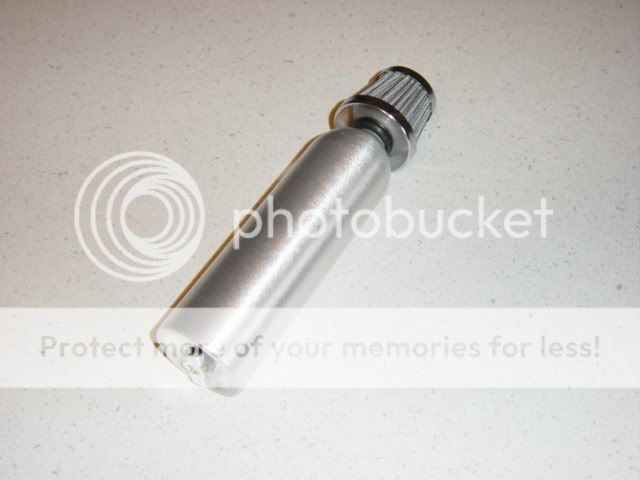

The metallic blue one was made for another customer that has a Lazer Blue Protege. He also got the matching coolant tank. The dimensions for that one is: 3" diameter x 8.5" tall. Thats the standard size. The supplied "L" bracket, clamps and hose makes it a complete ready to install kit all for less than $50 shipped.
The breather style can does not need to be emptied nearly as much as the sealed ones. It does allow the gasses to escape just as good, but doesnt collect a bunch of oil unecessarily. I put about 5k miles on mine and its collected a few ounces of sludge so far. When the motor is running after a good drive, you can see the vapors escaping the breather filter. Allowing the crap oil to go back into the motor is very counter productive. The can collects moisture as well, so letting it recirculate is not a good idea. The drain on bottom is convenient enough to just get rid of it anyway.
