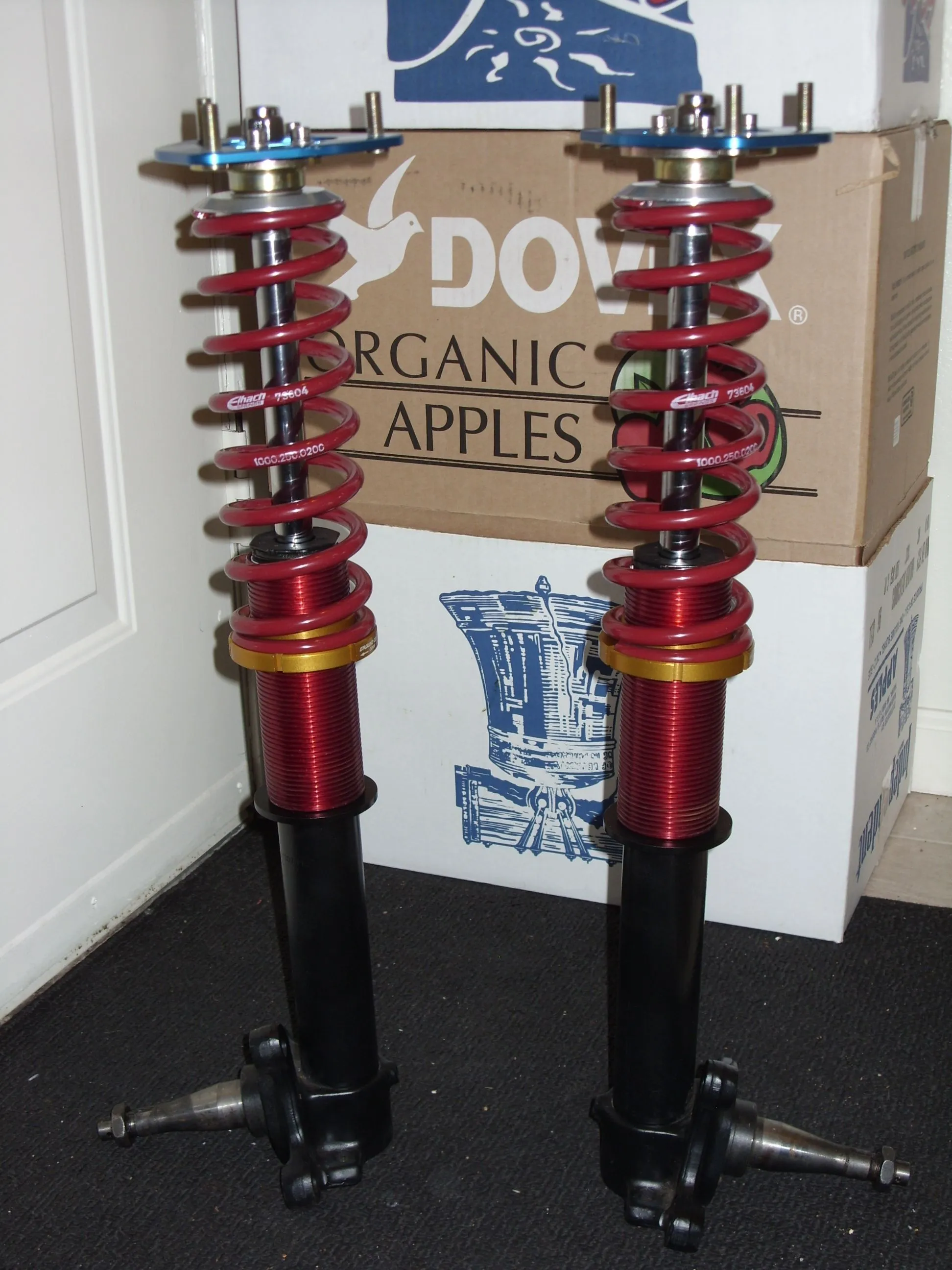

Udate 12-4-2009: Finished my coil-overs today. (Pic attached)
Now just to get them on the car....

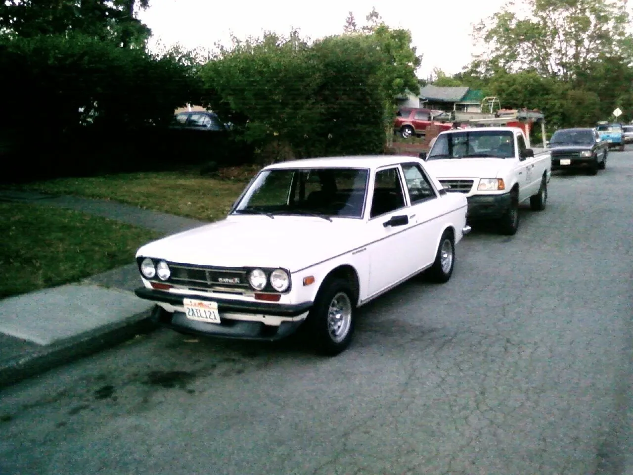

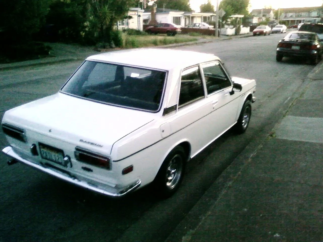

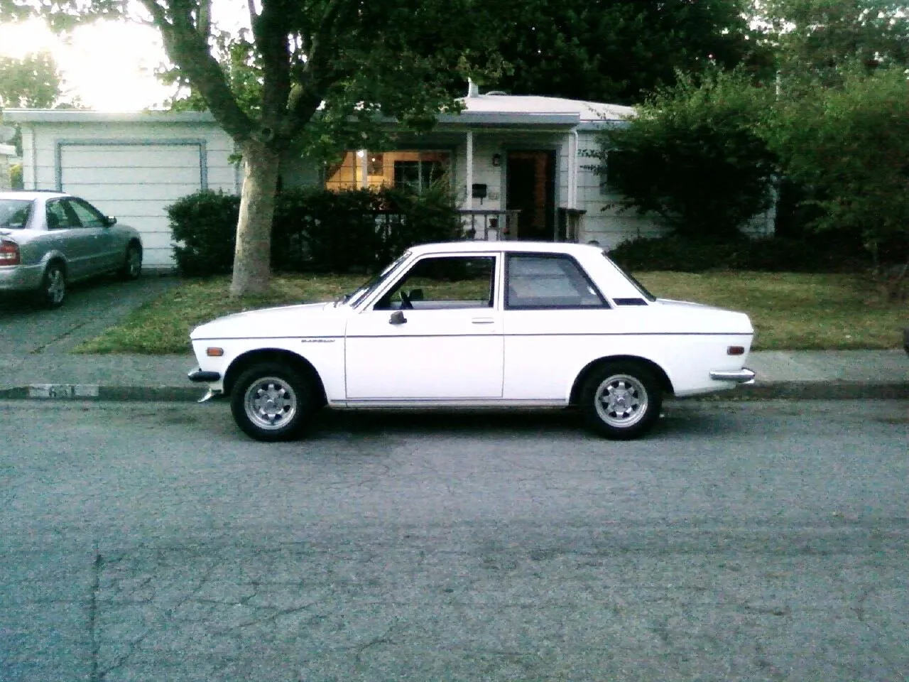

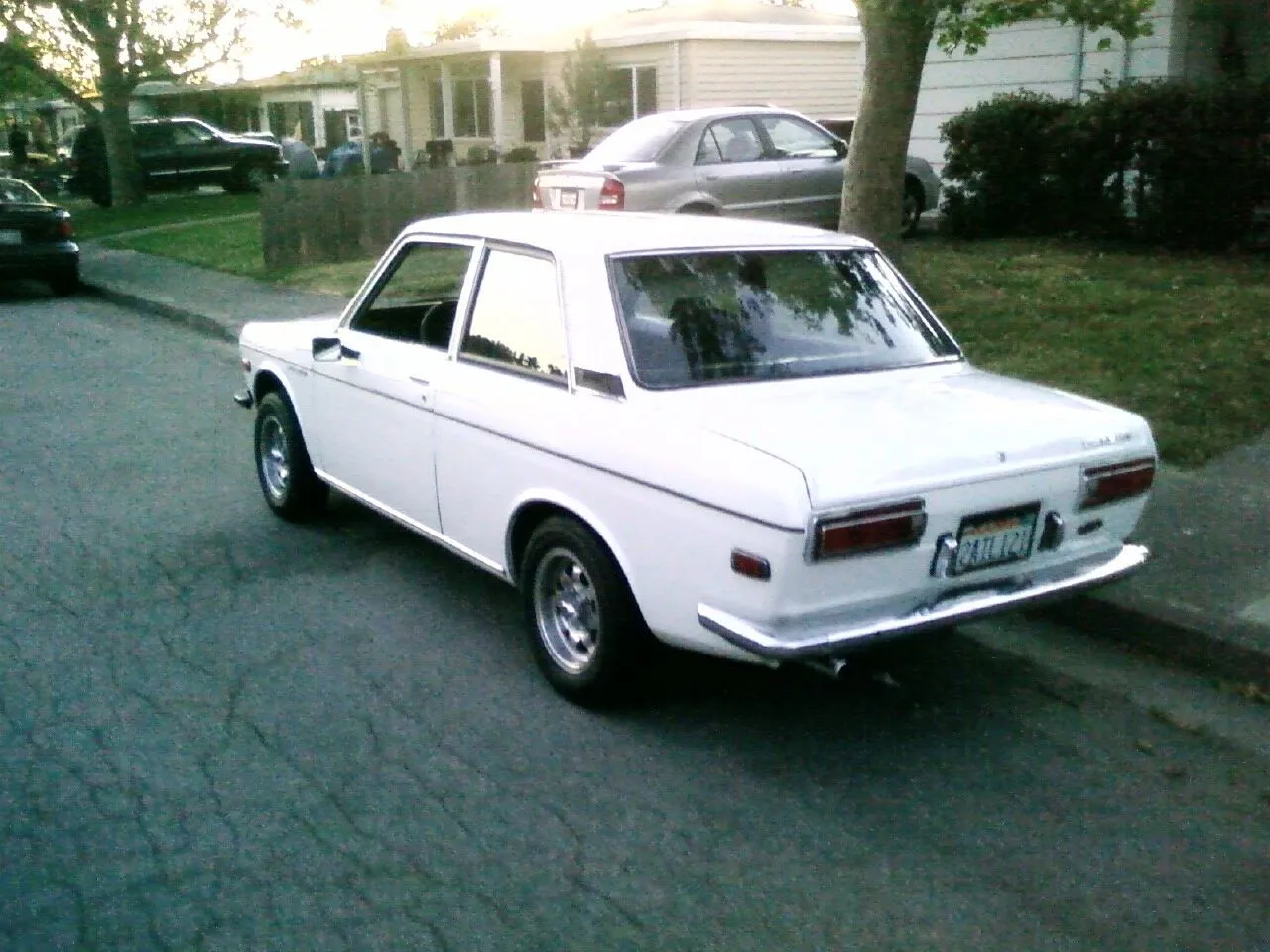

Brought it home yesterday. Took a few pics, will take more when it is not twilight.
It is so clean, you have to see it in person.
It runs like a champ.
Specs....
71 2 Dr Datsun 510.
L18 SOHC from 197(x) Datsun 610 bored .030 over with flat top pistons. Electronic ignition, 4 speed manual trans, formerly auto borg warner 3 speed.
Compression ??????
Cams????????
Engine was completely rebuilt 3000 miles ago.
R160 open rear end.
Weber DGV mechanical secondary downdraft carb 32/36 mm venturis
Factory suspension, which for its era, is REALLY good. McPherson Strut front, semi trailing arm independent rear suspension
1/2" Orange Shag carpet, keeping it all classy.
After market Panasonic tape deck w/ digital tuner & 4 speaker quadraphonic sound.
But you dont want to hear anything about that, here are some pictures. Will take more tomorrow. Pic quality is low, since the light is low, and this is taken on my phone.

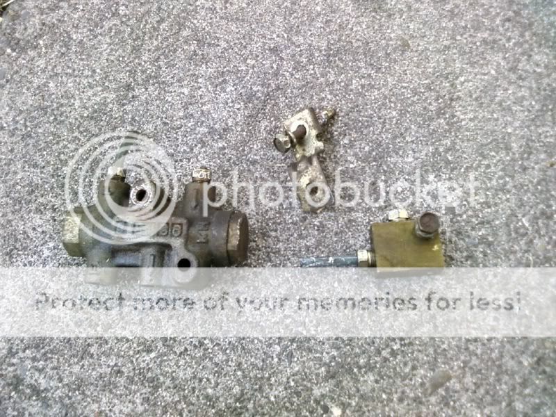

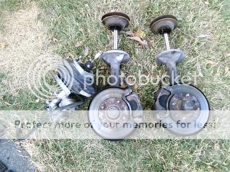

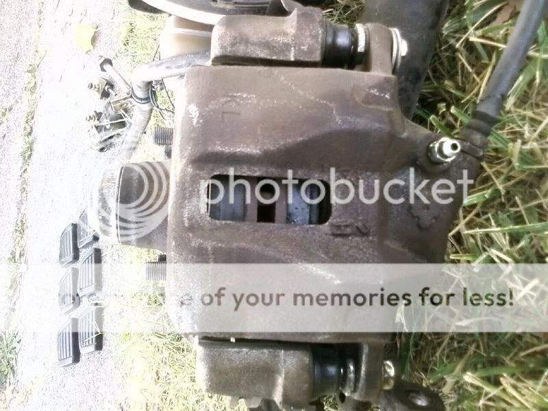

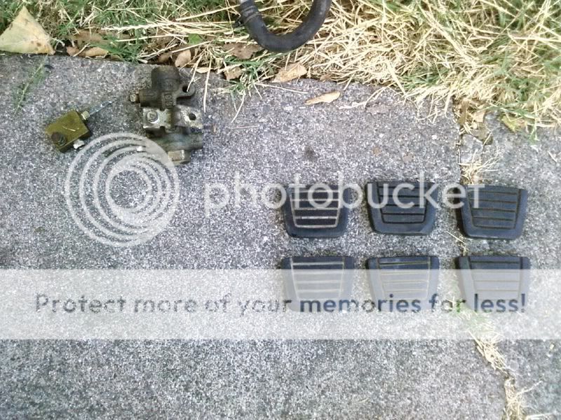

here are pics of the parts I got yesterday at Pick N Pull. Hooray for 1/2 price weekends!
<B>
I got all this for $70!!!!! YAY!

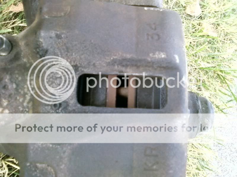

And if you look at the pics closely you will notice that the pads and rotors are almost brand new.

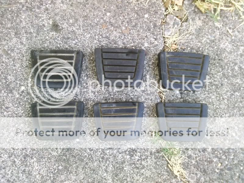

I got 6 clutch/ brake pedal pads off 280Z's for $.25 ea. A Steal, considering what the dealer wants for them.
The Master Cylinder I took apart, polished, cleaned reservoirs and ut back together. May put that and the proportioning valve in today since that is easy.
I tore the struts and brakes down to the bones to clean, strip and paint. (edit -Done 2 yrs later....)
I hope these will fit under my 13x6" wheels, I don't wanna buy new ones just yet.

congrat!! go with the SR20DET...you should be able to find a good one out there on the west coast!
Ahh another nice 510. We have a ton of those that race with us. Nice little cars!
Here are a couple photos:
Nice man she looks REALY good. Let me know if there is anything I can help with. Hopefully I can stop by when I'm on my way from Seattle to OC.
for sure. you can stop by anytime. I am right on the way if you take hwy 101
Thanks for the comments guys! I am totally loving this car so far.

hey anyone know if the struts I just got out of a 1979 280zx are the right ones?? They looked right, so I just grabbed them. In good shape at the local Pick N Pull. Only $52 for the pair.
not a bad price. Yes any year 280zx struts are good. Just get some camber plates to adjust for the add positive camber (240sx plates work), and get some bump steer spacers and some coil overs and you are good. Did they have all the brakes attached to them?
