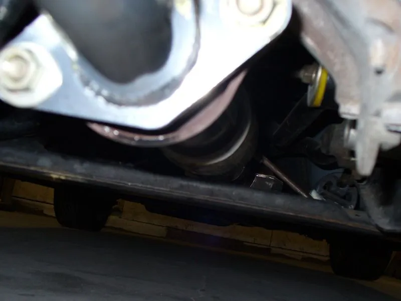

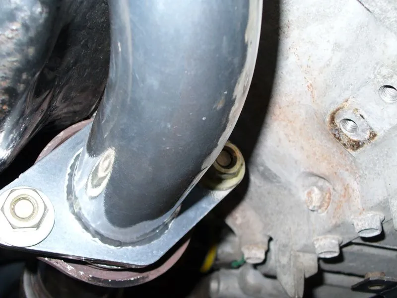

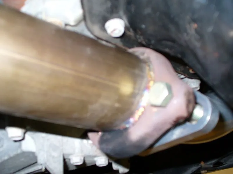

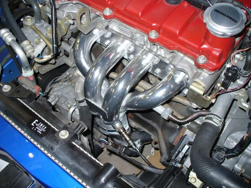

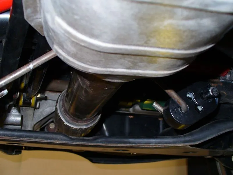

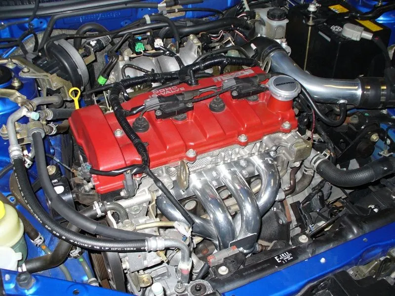

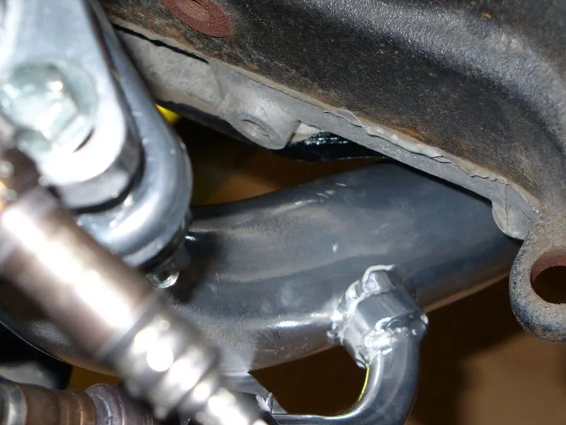

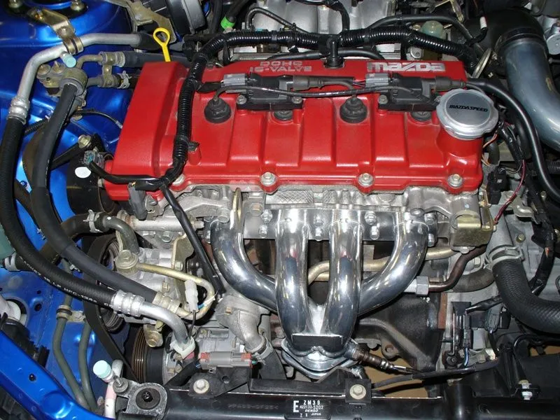

Got the header today and put it on after work. The 2 peice design kinda made it a pain tho with the mam midpipe took me awhile to get everything from touching the oil pan or the mid pipe on the cross brace. The tail pipe is close as hell to the rear skirt also I might have to do somethin about that.
2 more I will try to get a sound clip tomorrow too it sounds so much better now just the sound I was looking for with the rb catback.

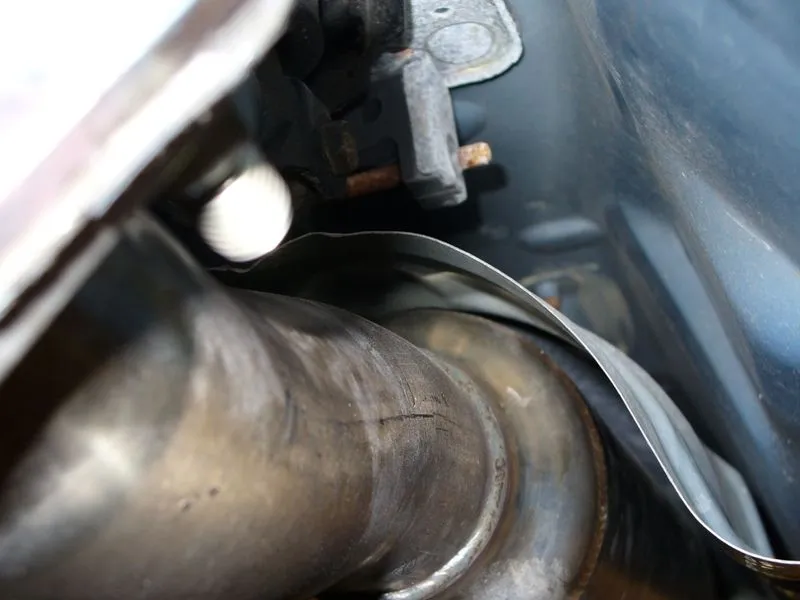

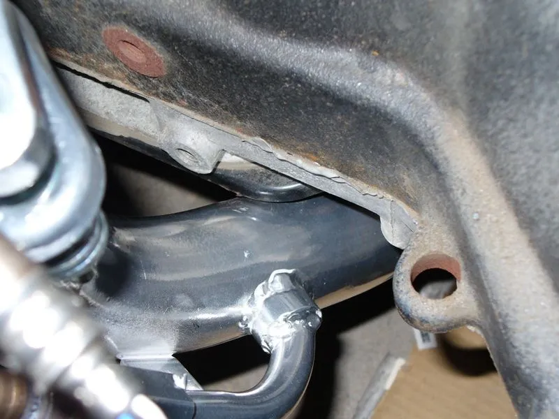

I dunno im not really liking the thunder header at all it might of took me 3 hrs. Something is still hitting I have to go jack it back up now and find out what ugh.
Oh think I got good clearance everywhere now. Took 3 people I had my dad and friend help. I pulled down on the down pipe to get the clearance while my dad tightened the nuts from underneath at the same time while his friend held the wrench up top.
Here is some shots of the clearance I have now.
