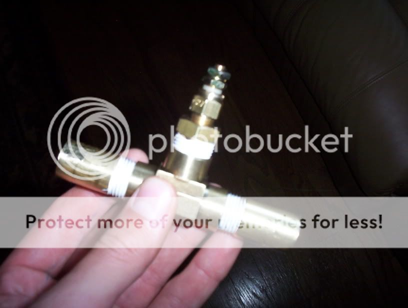

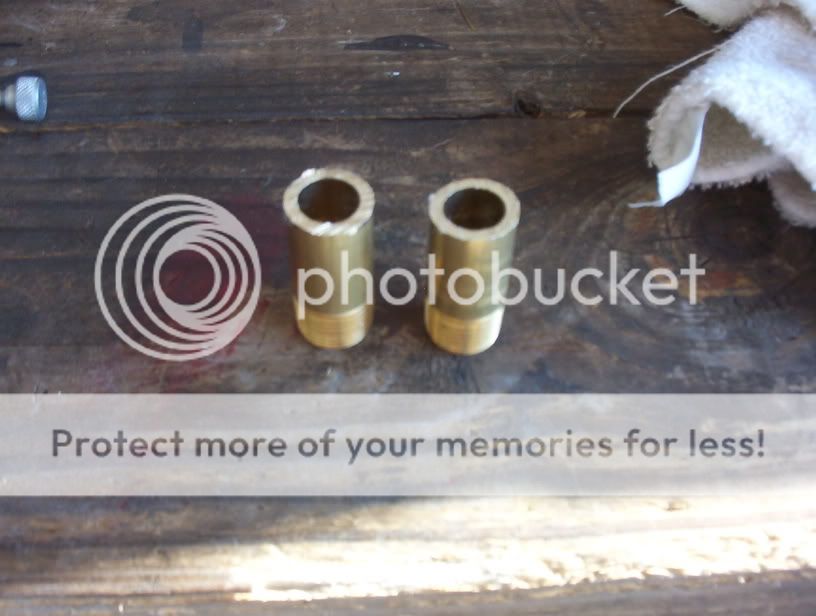

after you get the brass pipe cut it in half and use teflon tape on the threads to put it in the T. i also put teflon on the sensor threads both big and small ones.
So roughly like this:
1/2 pipe ----- T Fitting ---- 1/2 pipe
3/8" to 1/8"NPT Adapter
sensor

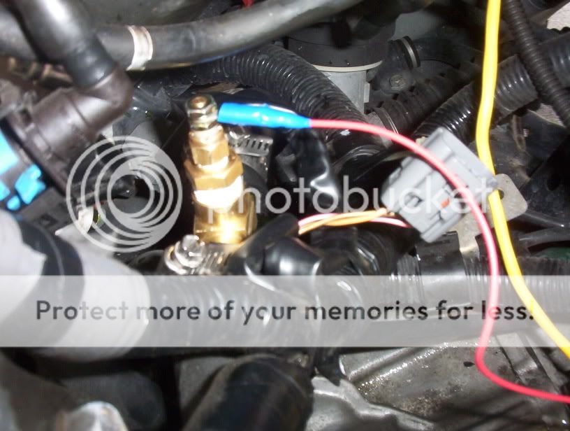

I suggest using a buddy for this part. take off the intake, i have a CAI so i popped that off and it was way easier so i suggest it, otherwise it's nearly impossible. now move as many wires as you can out of the way. i put newspaper under the car to catch most of the excess radiator fluid. take the scissors or exacto knife and cut the hose. try to elevate it as much as possible to minimize fluid flow or block the hose holes with your buddies thumbs or something else. i used my thumbs and a screw with a bunch of washers/one big fat washer with a nut holding it on and plugged the hole. now slide on one of the clamp rings on each side of the hose. put the T in the hose and tighten down the clamps with a flathead or the socket wrench. try to cover as much brass as possible so you have a less chance of leaking by more space for clamping. check and make sure everything is tightened down and secure and no leaking. the end result should look like this:

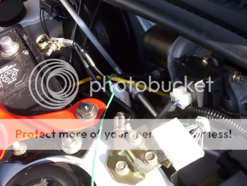

i grounded the gauge by the battery in this picture. this is before i made it all nice and neat. but touch up the hole as much as possible so no moisture or water gets in there. i clamped on a U to fit around that big screw on the stock groundwire on the brass fitting, but use whatever you can, i just dont suggest wrapping the wire around the screw.

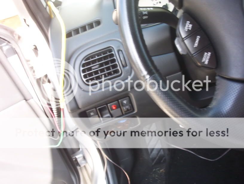

now run your wire through the firewall to under your steering wheel (i also did my A/F gauge install so thats why i more than one wire running through the wall in the yellow shielding). then run the wire up to your left side of the drivers side wall up to your pillar.
for it to come one when the car does i tapped into the cigarrete lighter (pink/black wire). and run that wire along the wall with your sender and grounding wire. also use that ignition wire to run your light and for the negative wire for the light use the other black wire from the cigarette lighter.

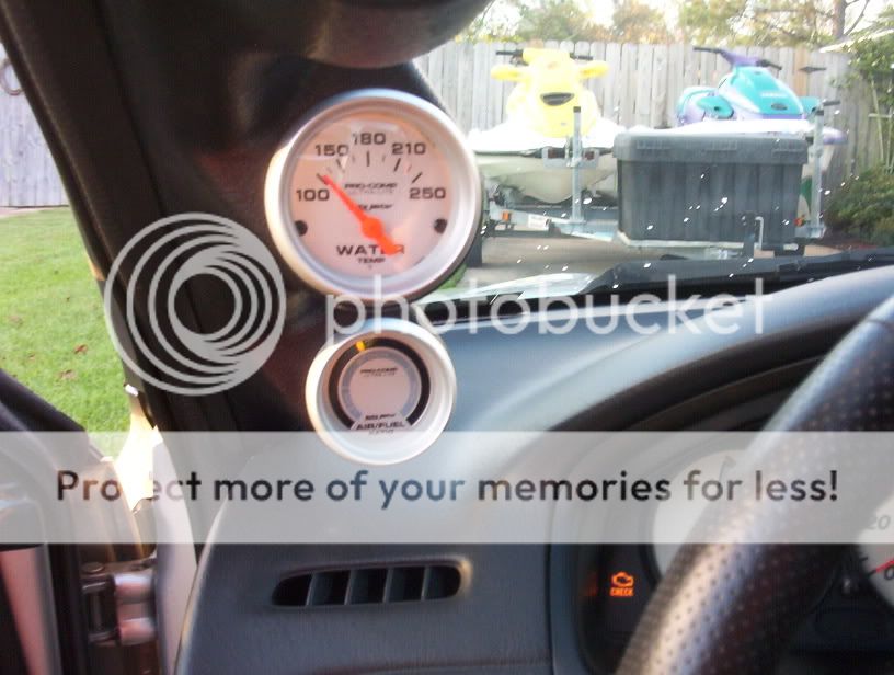

when you're finished your setup should look like this:
when you turn your key to on the everything should light up. and make sure to disconnect your negative terminal. i just did this to my car so i will let you know if i throw i CEL which i doubt, knock on wood. use the heatshrink around the wire connections under the hood. electrical tape will do fine in the car's driver bay.
