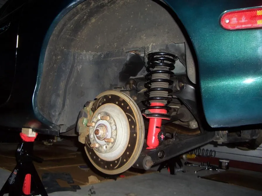

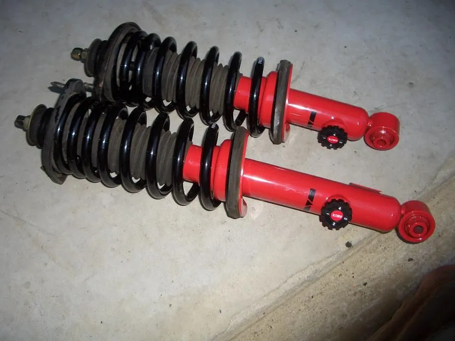

Report from the build: New stiffer engine mounts from FM are in and all the new and reused valve shims are in the right place. My beautiful new coilovers are assembled (FM springs + KYB AGX shocks) but only the rear has made it on to the car yet.
Picture: Note my little custom-wood-slab-on-jack-stand-thing. The green EBC pads will soon be removed to give room for yellow ones.
The builds first real failure:
My torque wrench must be to large to handle so low torque as needed for the cam cap bolts. When tightening them down, a bolt snapped. (shocked) (Are those bolts "use ones"-type and I just missed it?). A set of new bolts are in the mail and a friend with much more experience and tools then me will help me get the rest of the bolt out.
