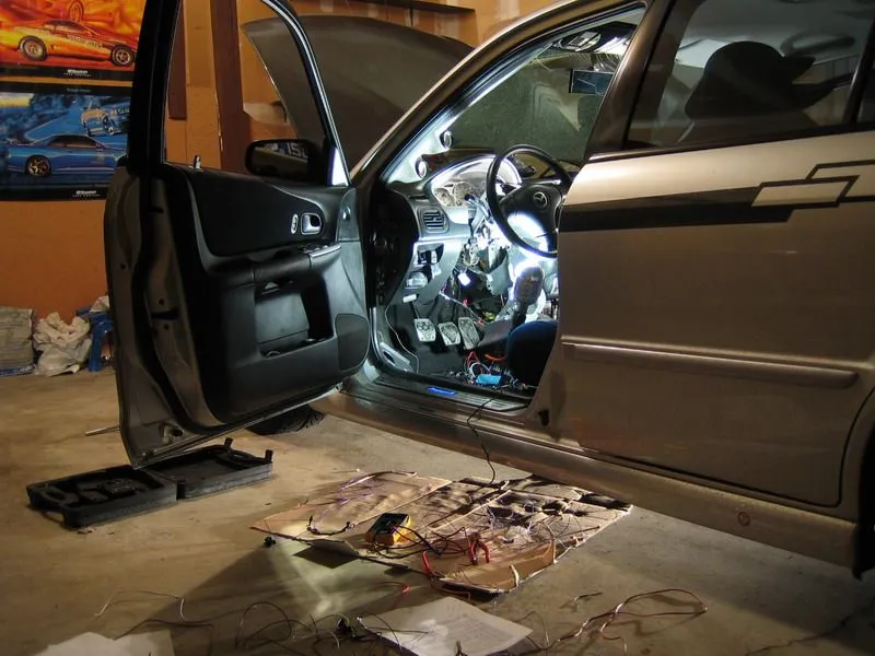

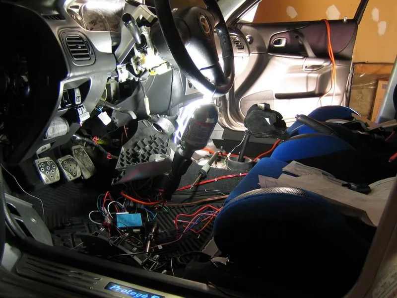

actaully i got a new car alarm!
2way Car alarm, remote starter, turbo timer, its kick ass!
installed it myself in about 6 hours (during this 6hrs i also took breaks, slacked off, chatted on msn, ate pizza) its EASY to install a remote starter on a manuel, i wonder why install shops recommend against it, i tried to start with it in gear but the alarm doesnt let me. whats the big deal?
if your wondering, no i didnt use those stupid butt connectors, i soldered every connection there was, and then some (replaced some wires with lower ga ones)

but i also knew nothing about cars before i started, if you can solder good and wrap electrical tape around a bunch of wires than its easy. i started out with car audio and now i can pretty much do anything electrical with the car. also i dont think i cut any wires, its all splicing. the only wire that i "COULD" have cut was for starter disable but i didnt install that cuz i ran out of relays
nice work, i did mine about a year ago, removeing the drivers seat made it really easy, i had to cut a wire or 2 though for the remote start, other than that i spliced everything,
been workin for 1 year no problems.. adn that is good, my dash basically has to be removed to get to the brain box of the alarm.. lol that b**** is hidden very well..

I do not know about you guys but if you ever had to sell your car or wanted to and you wanted the alarm or the alarm went bad or something, I would feel bad for you having to unsolder all of your connections. That is why most professionals (I am not talking Ultimate Electronics, Best Buy, Circuit City, etc... I am talking certified professional shops that all they do is alarms) use butt connectors and t-taps. I know me for one, I am not certified but I have done a lot of alarms and full systems, I use t-taps and I have done a remote start on a standard. 1998 Honda Civic EX/Vtec Standard 5-speed. Had to remove to sensors and tap a white and BAM, remote start. So... Just my $.02
