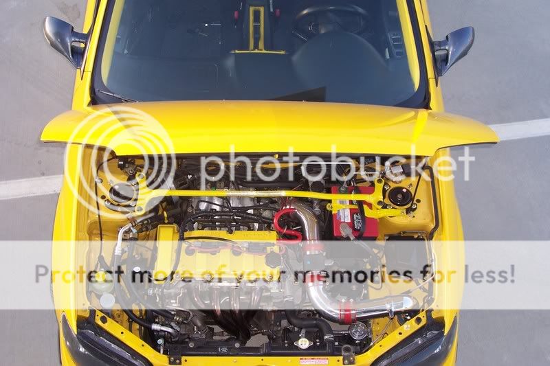

My 1st Intake Install, How Does It look?
livetoride said:
i just ordered the exact same intake less the K&N. Does the ecu have to be reset before the first startup?
You dont have too, but you might as well, because its gonna have to re-learn everything anyways, probably will end up adding more fuel sooner if you do...
My only suggestion would be to find a mounting point for the brace that moves with the engine instead of one that is stationary with the body so there's no tug of war due to engine movement. I used a wiring loom bracket that's on top of the tranny that had extra hole in it & there's also a bolt on top in the same general area. I also opted for the turn to side towards the cai hole in the body vs. down into the heated & possible rain soaked path behind the radiator opening. K&N also makes a prefilter wrap thing just to give the filter another level of dirt & wet protection. Nice job, now you have the mod bug & you cannot give it back, you're trapped in a world of tweaking & twiddling with all that can be, you're wallet is shrinking, your free time is fleeting, your girlfriend is jealous, oh no let me out, no no no........LOL, it's all great fun, you'll love it.

BKJT05 said:
Anybody Else? Does it look like it sitting right? I think i need to do some more cutting and position it better, well at least by looking at other pictures on this forum
Looks great! Keep an eye (or ear?) out for the intake hitting the brake master cylinder as the engine moves. I cannot tell from your pics if you got enough clearance. Here is mine. I added an elbow to allow for a RAM air hose.

Not bad, but if you bought some more piping from autozone you can make it a true CAI like I did and rout it to the wheel well:
wheres your antifreeze resivor?
mazdaspeed777 said:
I replaced it with a weapon R coolant overflow can. Yah I forgot to mension you will either have to move the stock overflow tank or get a catch can like I did. I bought mine from protege garage:http://mazda3online.web.aplus.net/product_info.php?cPath=281_21_31_135&products_id=632
cool, thanks. i think im going to keep mine how it is, just cause its done and i dont wanna mess with it, and now its time for the exhaust, and then i think im going to try to clean up and make my engine bay look better, maybe paint the heatshield etc, new hoses or something
hey guys, at stop's my car keeps putting, or wants to die, but it dont, any idea whats going on?
mazdaspeed777 said:
Are you getting a CEL???
no, at first after installing the intake when i started it for the 1st time, the check engine light was on, then i drove it, turned it off, then started again and the light did not come back on, and the car drove fine, but then i did some more cutting to the pipes to make a better fit and now when im a red light or something it sputters and wants to die, but then it doesnt.
sounds like an intake leak past the air meter. Check your connections. Probably getting some un-metered air from somewhere.
