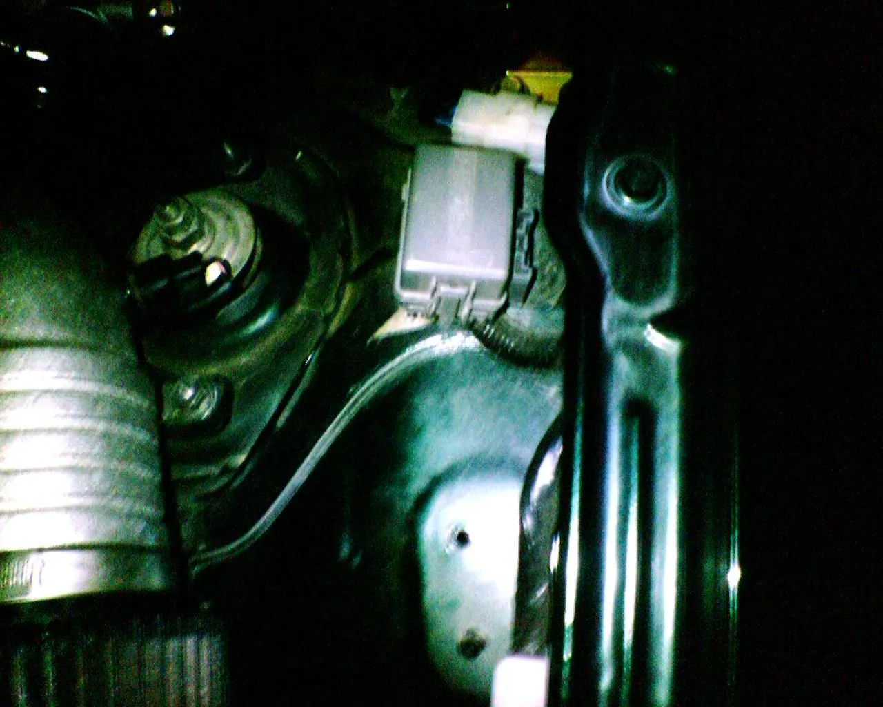

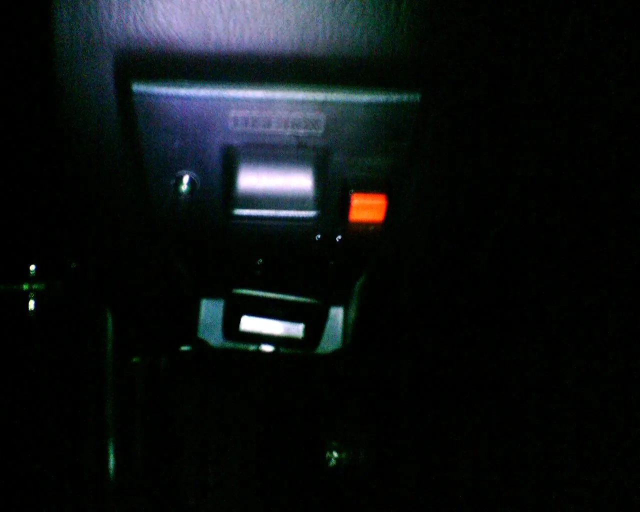

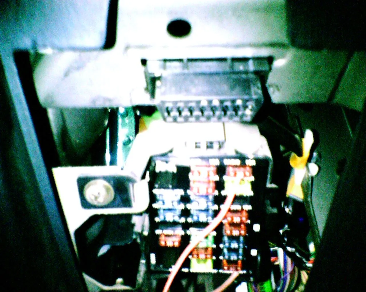

theres a 'diag' plug under the hood in my '99, but its not for the odb2... odb2 in the compartment above the hood release catch, and it always throws off the smog hut people every year... i let them look for it for a couple mins before pointing it out to them usually, cos i'm mean.
got bored, and took pictures of the offenders.
first pic is the cover the true odb2 plug is hidden behind.
second pic is of the odb2 plug. its the blurry black thing at the top.
third pic is of the diagnostic plug in its gray plastic box under the hood (aka, not the right plug)
sorry for the crappy pic quality... the camera on my phone isn't very snazzy... and trying to find light under my dashboard in my garage at night wasn't easy :)
Oh, and you wont have the red button or led on your fusebox/odb2 cover, those i added myself for something completely unrelated to this thread.
You're awesome! You saved me some bucks. I owe you big time. I was dreading having to go back to the dealer.
Thanks for the info and the pics really help! I will check it out, as you described.
