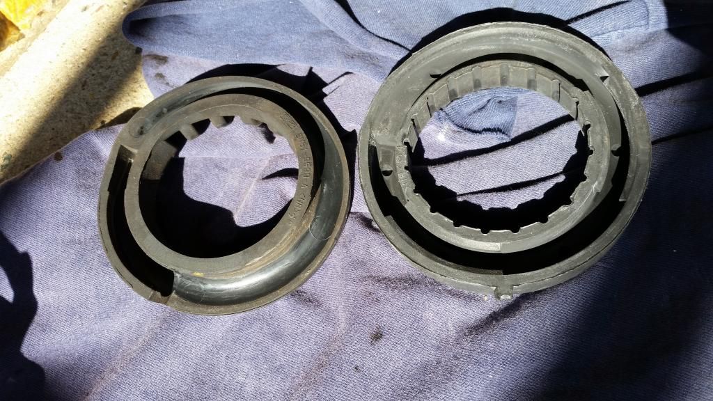

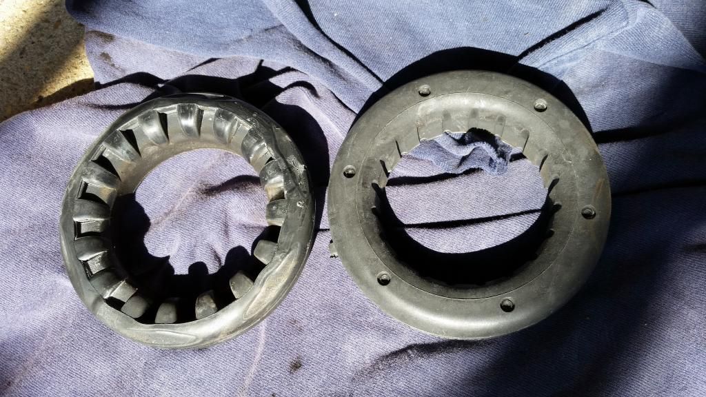

I'm putting together a parts order. Does anyone have any idea why the rear spring seat part number referenced in the TSB (c2Y6-28-012, $30.87) is way more expensive than the spring seat that comes up as a direct replacement part? I'm using the parts diagrams from various sources and it even has a different number(BP4K-28-012A, $8.12).
Because of this...

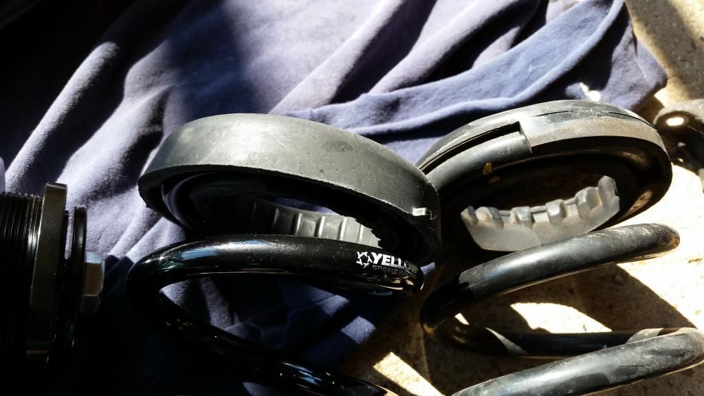

You WANT the revised one. My rear end was not making any noises (knock on wood) but I figure I'm nearing 80K and since everything is apart during the CO install (top of the YS springs are wound and seat in the perch like OE springs), why not?.. No noises still (knock on wood).

It seems there are THREE of the same (sorta) part numbers! Same in terms of fitment and purpose but VERY different cost structure and design.
BP4K-28-012A this is the original inferior piece that came with <10 cars. (~$6)
c2Y6-28-012 this is the revised part Mazda added to the TSB. (~$22)
C27328012C this is the OE part for >12 cars. It looks IDENTICAL to the revised TSB part but cost half the amount. I bought this one. (~$13)
Do part# search on Wholesalemazdaparts.com. The revised TSB part, while it exists, has NO details attached to it?

Im guessing the original part# and revised TSB part# are technically for an older generation car so they dont cross reference the parts to the newer car you end up paying more. That said, I must put the disclaimer that using the >12 part on a <10 car is at your own peril (rolleyes).
