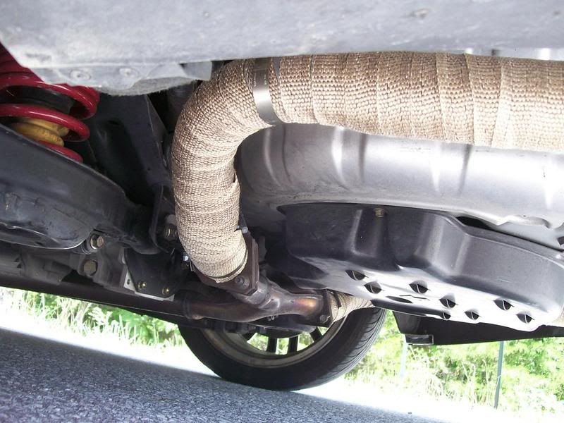

Researched for awhile looking to see if someone made a bolt on kit for us...only thing I found was for an existing aftermarket exhaust....this it was cpe? For an option on rear muffs...I did my own, and was thinking about making a few kits....but Not really sure. Love the sound with it, not loud, not raspy at all....very smooth and on long drives it doesn't bother me at all...I can get better pics later, just kinda messing around now.
Using the factory flanges on the stock mufflers, I created a "axle back" system with 2.5inch. Wrapped it up, and reused the factory hanger points and rubber mounts.
the wrap is unnecessary. i had this exact set up with no heat related problems.
Most likely yes, but I had it already and aesthetically I wanted it over the raw pipe (I'm under it a lot).
Write up? Never really done one....

4. Take to your favorite exhaust shop, or exhaust friend in my case and have him reconstruct an "axle back" using the flanges. In this case, 2.5inch piping and a mandrel bender. Getting the bends right was kinda tricky..not gonna lie as you can see, the pipe comes away from the T pipe, and makes an upward bend to a 45ish bend. Took a little work....
Other then that....not a lot to it. I can get better pics, these were kinda on the fly. Fitment is great thanks to an awesome friend, from the back of the car you just see the 2.5 pipe in the "faux" tips. I did wrap it, not needed Im sure but oh well...

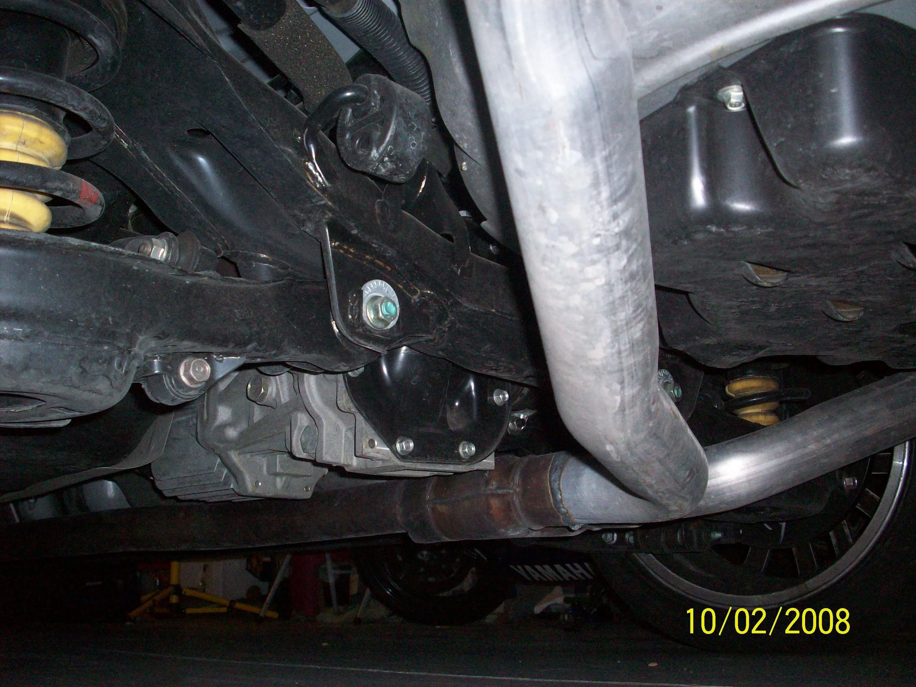

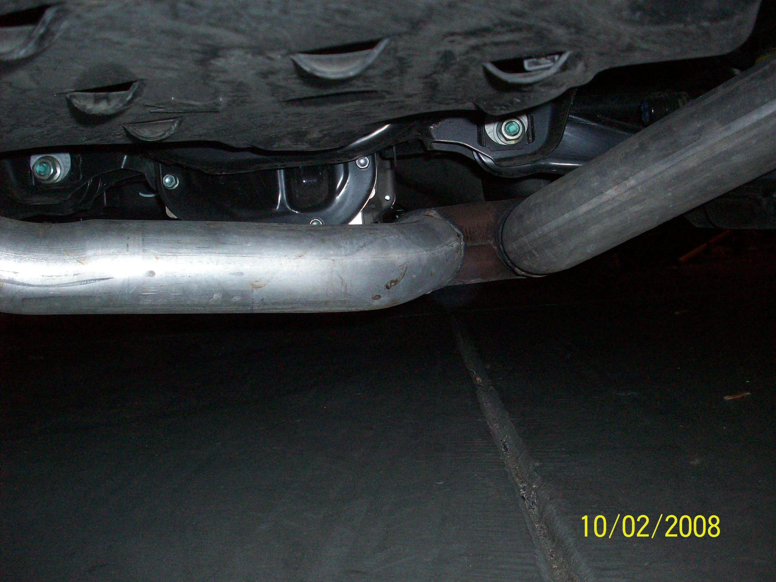

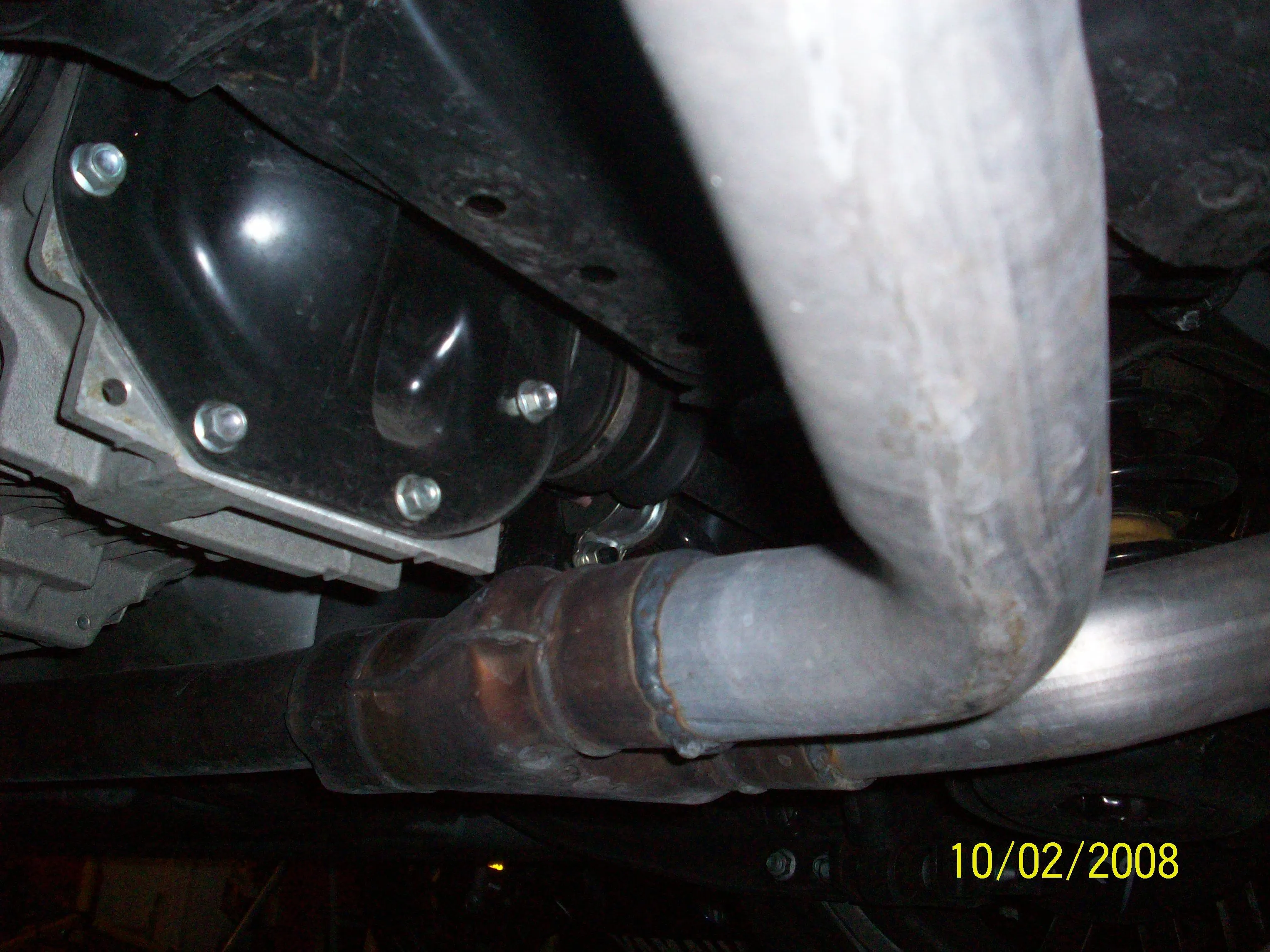

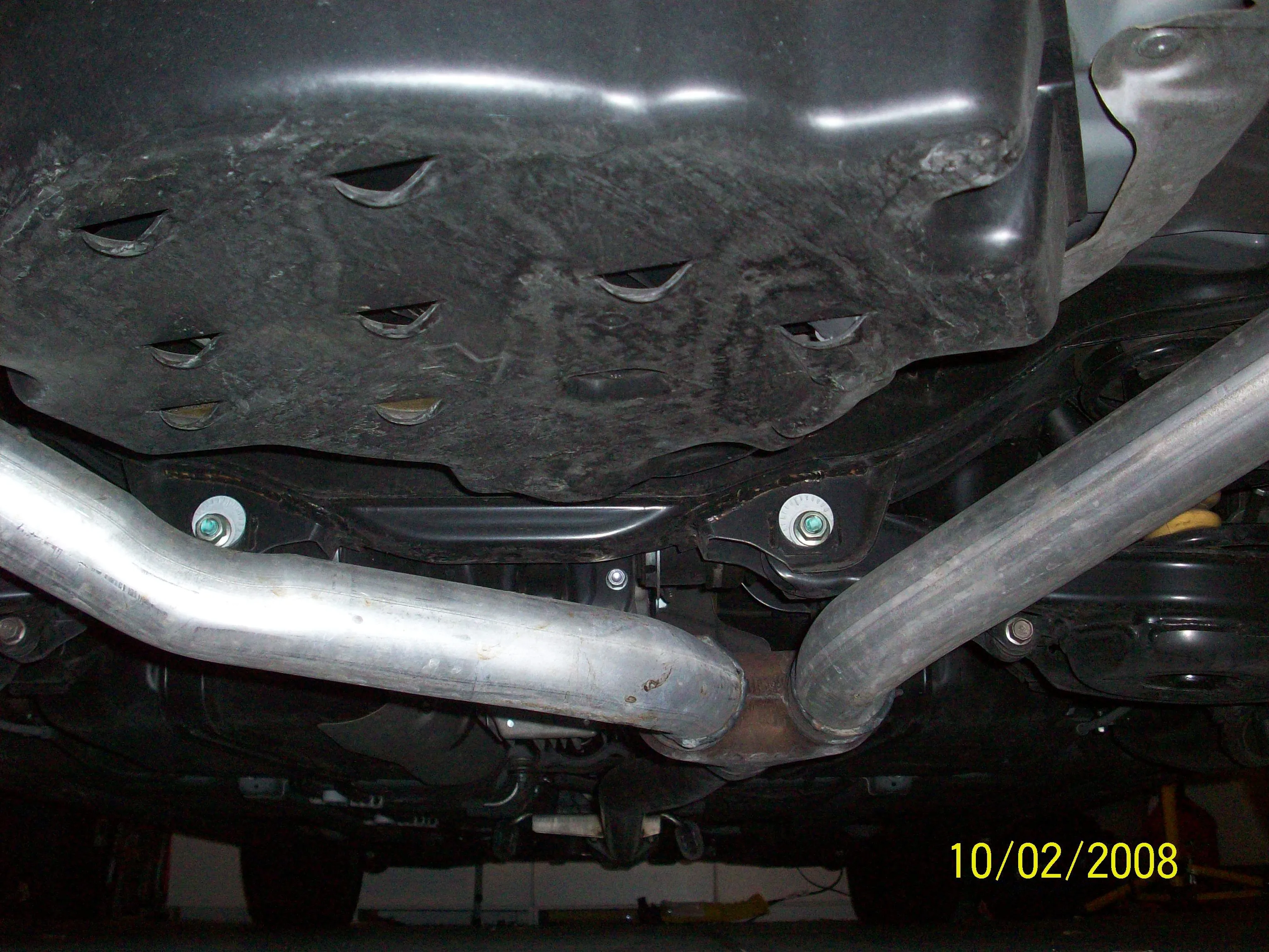

here ya go , this is what my Exhaust System is set up like and btw its just a little bit quieter then on video...... The reason i didnt just take the mufflers off is because the piping that goes right to the mufflers is really small compared to what i have on there now , you will see what im talking about
