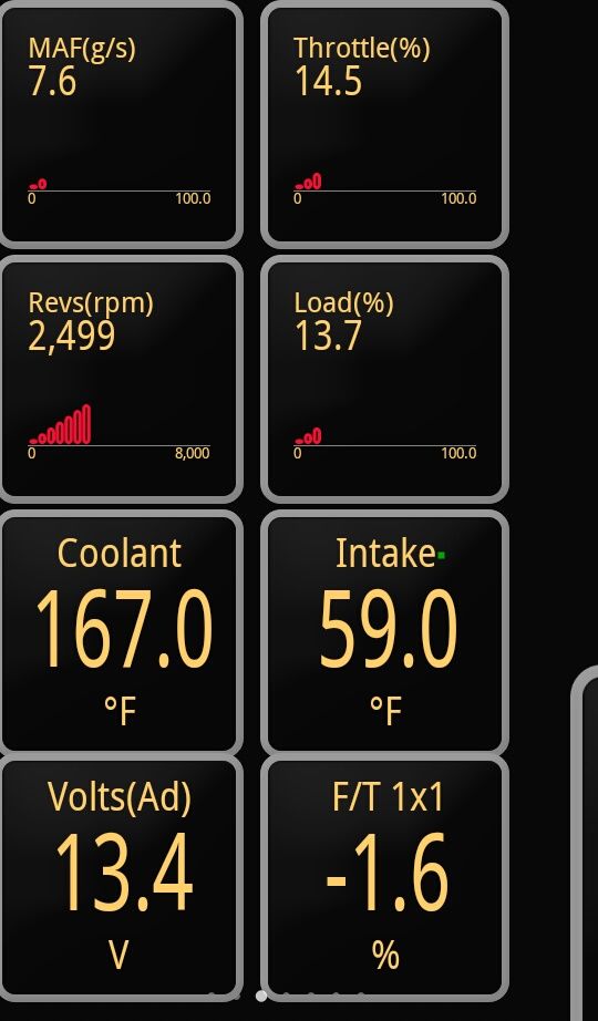

@ 2500 rpm
STFT bounces around zero ish
LTFT - 7.8 % (spec ? )
MAF 7.8 to 8.1 g/s (spec1 5.1 to 6.5g/s or spec2 6.2 to 7.4g/s)
Spark advance: 23deg (spec ?)
Load : 14% (spec1 11 to 17% or spec2 12.5 to 17%)

here are my stats
yes but I have supper short piping so relocated or not signals should be the same. My idle was a little low due to i had reved it and it dipped a little. I have a feeling everyones having coil problems..

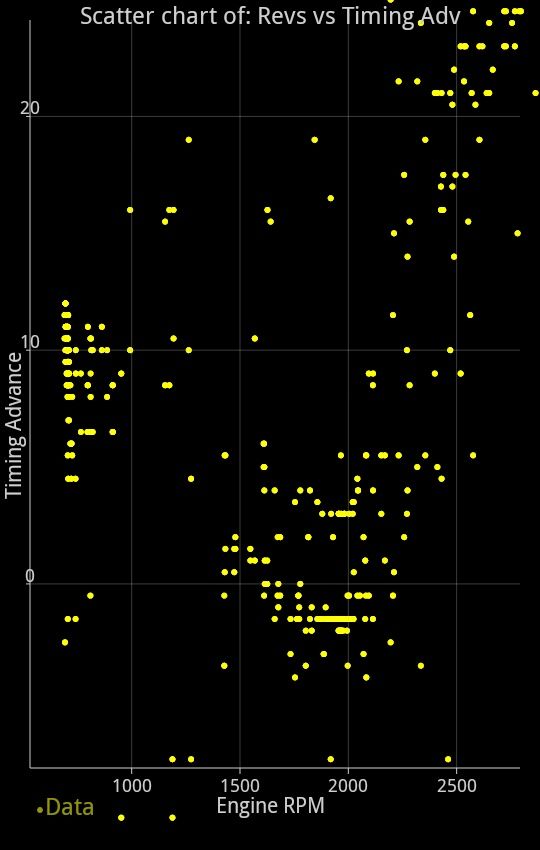

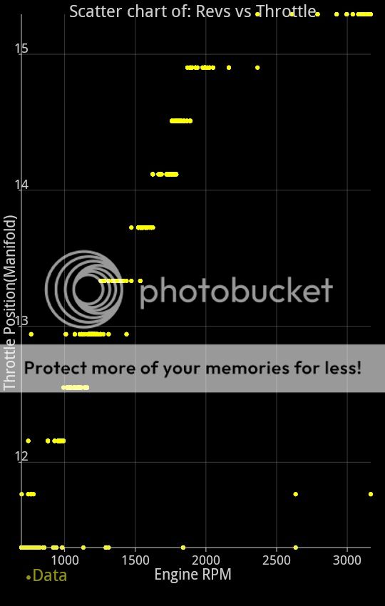

I also checked my ignition advance vs RPM in neutral.
This might explain why I was having such a hard time arriving at 2500 rpm.. because its retarded below 2000 and advanced above 3000 and a very large slope between them.
I am assuming the 2 curves at the bottom is the ecu "trying" to advance the timing, but being bumped back down again.
Soooo If anyone has access to that fancy Torque app like me, (or If your local to MKE I could hook up mine as well, in exchange for some beers!) maybe I could see if this is normal or not.

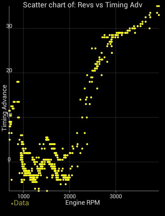

hmmm Crap CHIQLES, your graph is all over... ha. Did you try going super slow from idle? Just go up real slow, then stop logging and the graph should look cleaner. I think you might also have the 2 step in there.. but it looks like your still more advanced than me :( as you are just below 0 advance.
I started to blog my graphs, you can look at them there, it has load vs advance in there.
