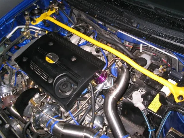

here is a pic of my piping.. im sure the finished product will look similar (not in design).
Wow look like some real qulaity Front mount. But it doesnt leave much room in the engine bay. I was thinking of buying the equal length manifold from Husker so I dont think it will fit. But this is good stuff. I like the size of that innercooler.
