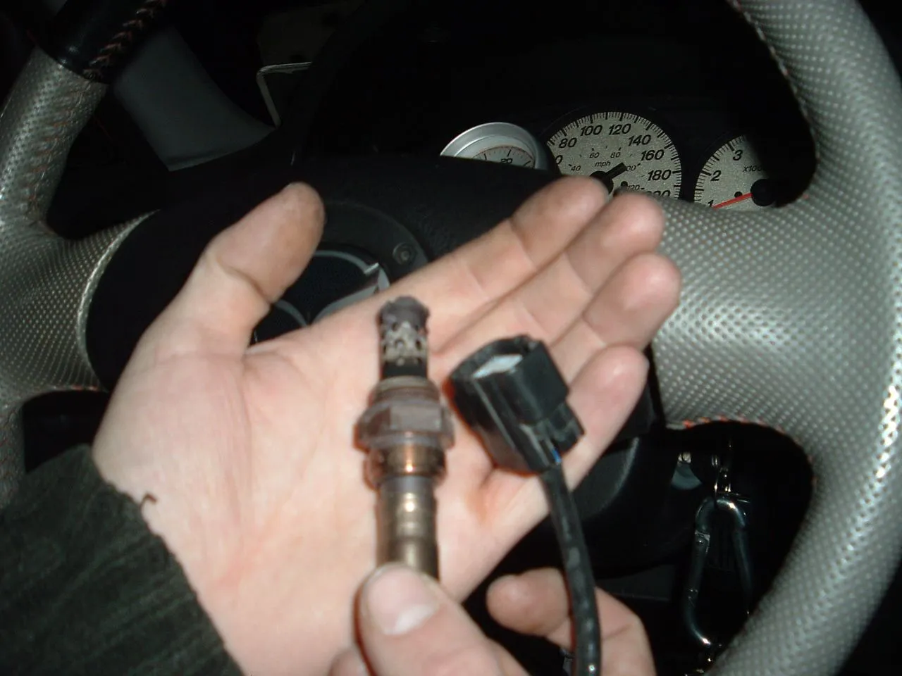

well my check engine light came on last night. I had a hunch it was the primary 02 sensor since i am at 106,xxxkms. ~5000+km on the new motor using the old 02 sensor. I pull the 02 and it looked like it had been through hell and back. Several large pieces of it destroyed and not present in exhaust, im assuming they are in my muffler now since i have no cats. I replaced with the 02 sensor I got from the n/a motor (they were nice enough to include manifolds and sensors) reset the ECU and the car is back to running great again. It is so cold I am spiking 9-10psi on stock boost, but still down to 7psi at redline. Gotta love the cold.

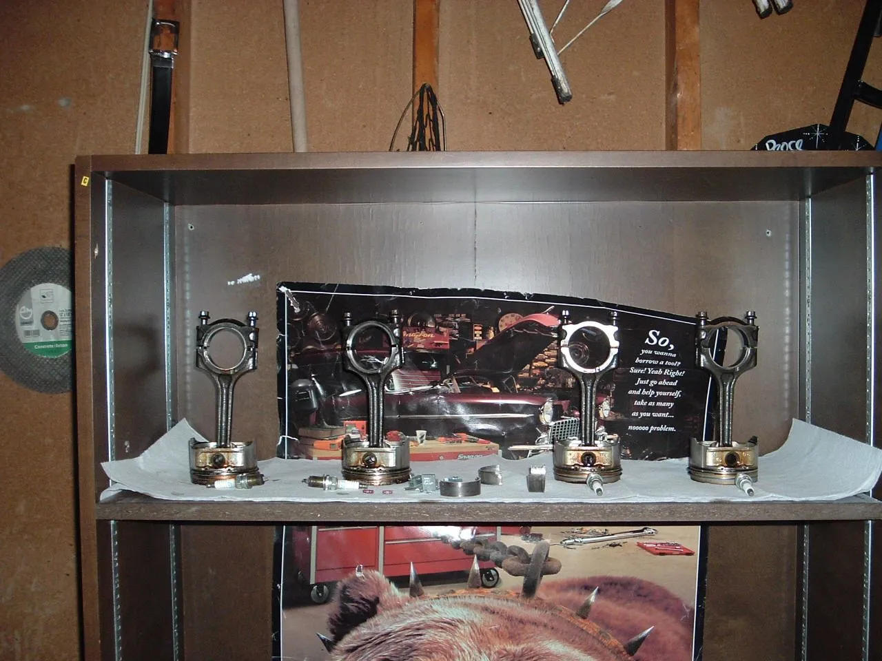

Here are some new pics from the new gf's camera. still not the greatest.

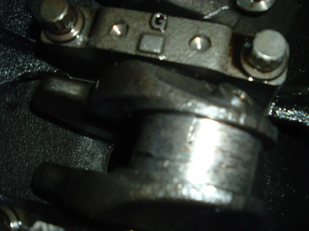

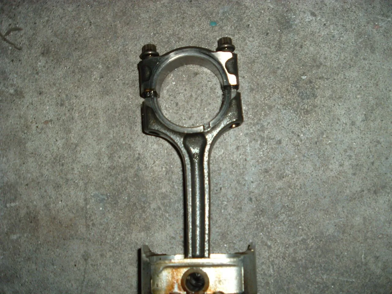

as you can see the rod is not bent very much, hard to see but its definately bent when you line it up with the other rods its easier to see.
The second picture shows my roasted 02 sensor.(guess it didnt like me adding 5 litres of methenol + 94 octane that already has 10% ethenol in my tank on fill ups and the methenol i was injecting in the intake charge lol )
The last picture shows how the two connecting rod bearings fused together (however still can be spun on the crank and are still whole) and the section of the bearing that is completely worn through in the middle of it exposing the crank. I tried to get some better shots but with the flash I couldnt get anything decent and I have poor lighting so I can shoot without it.

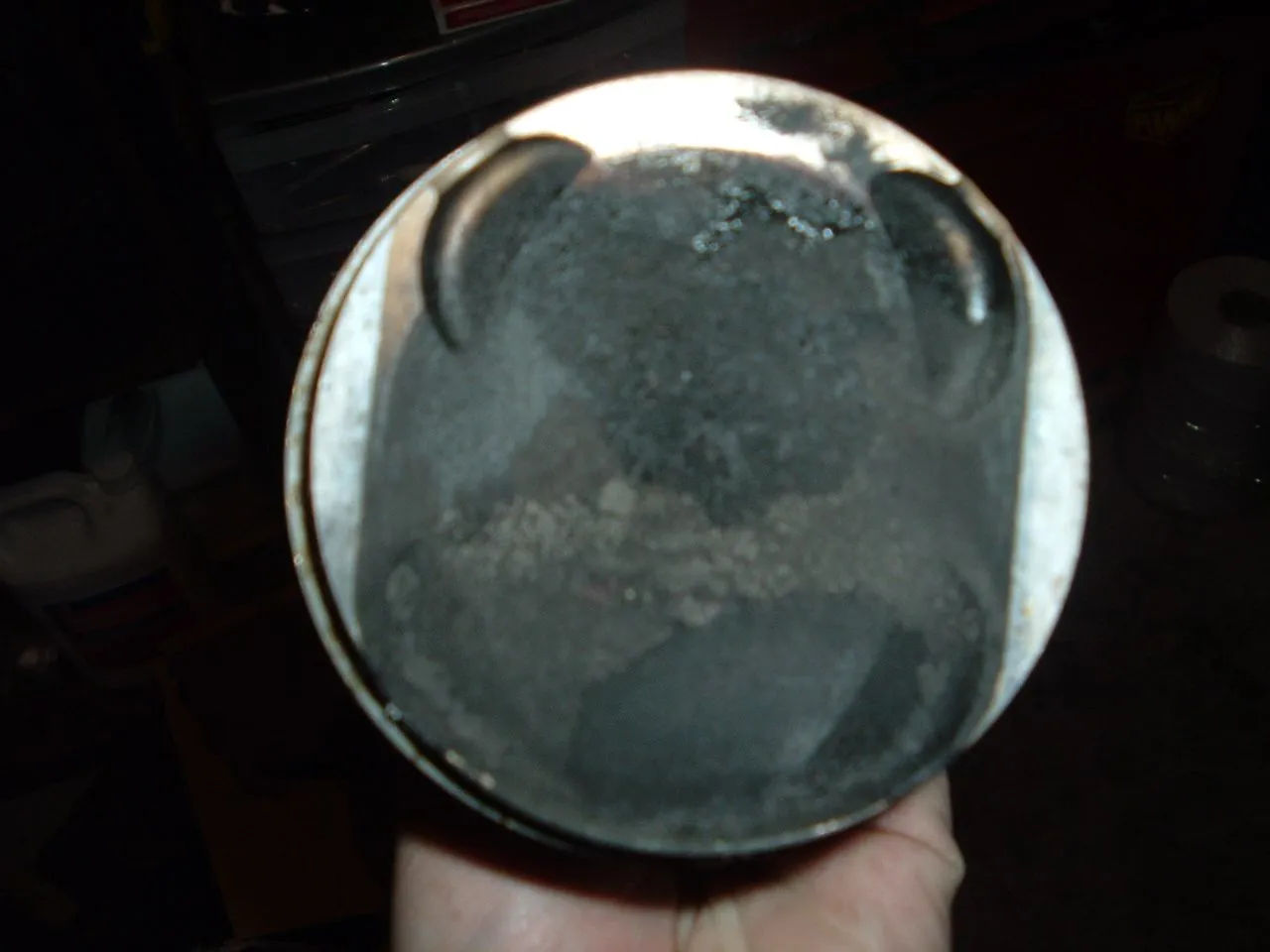

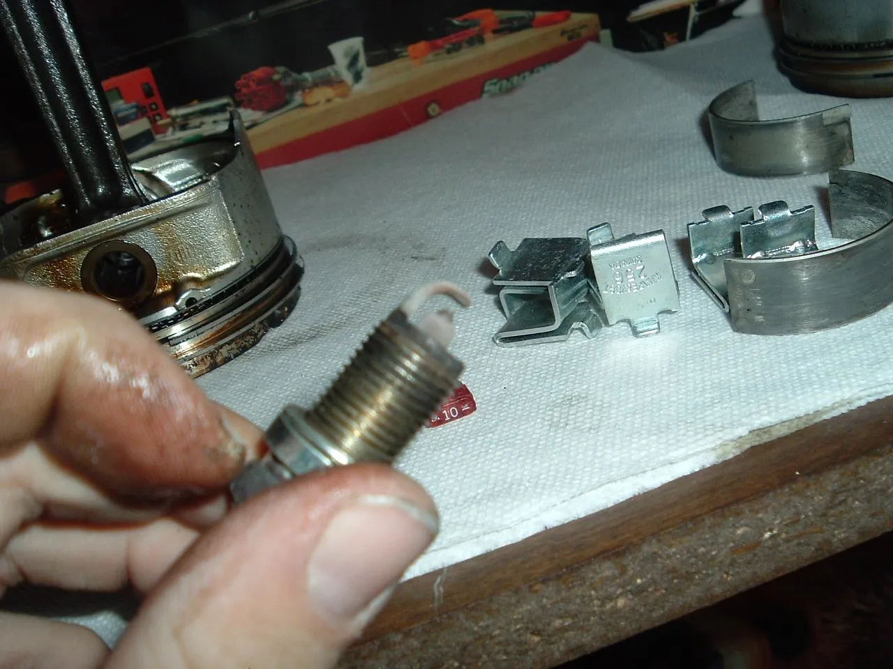

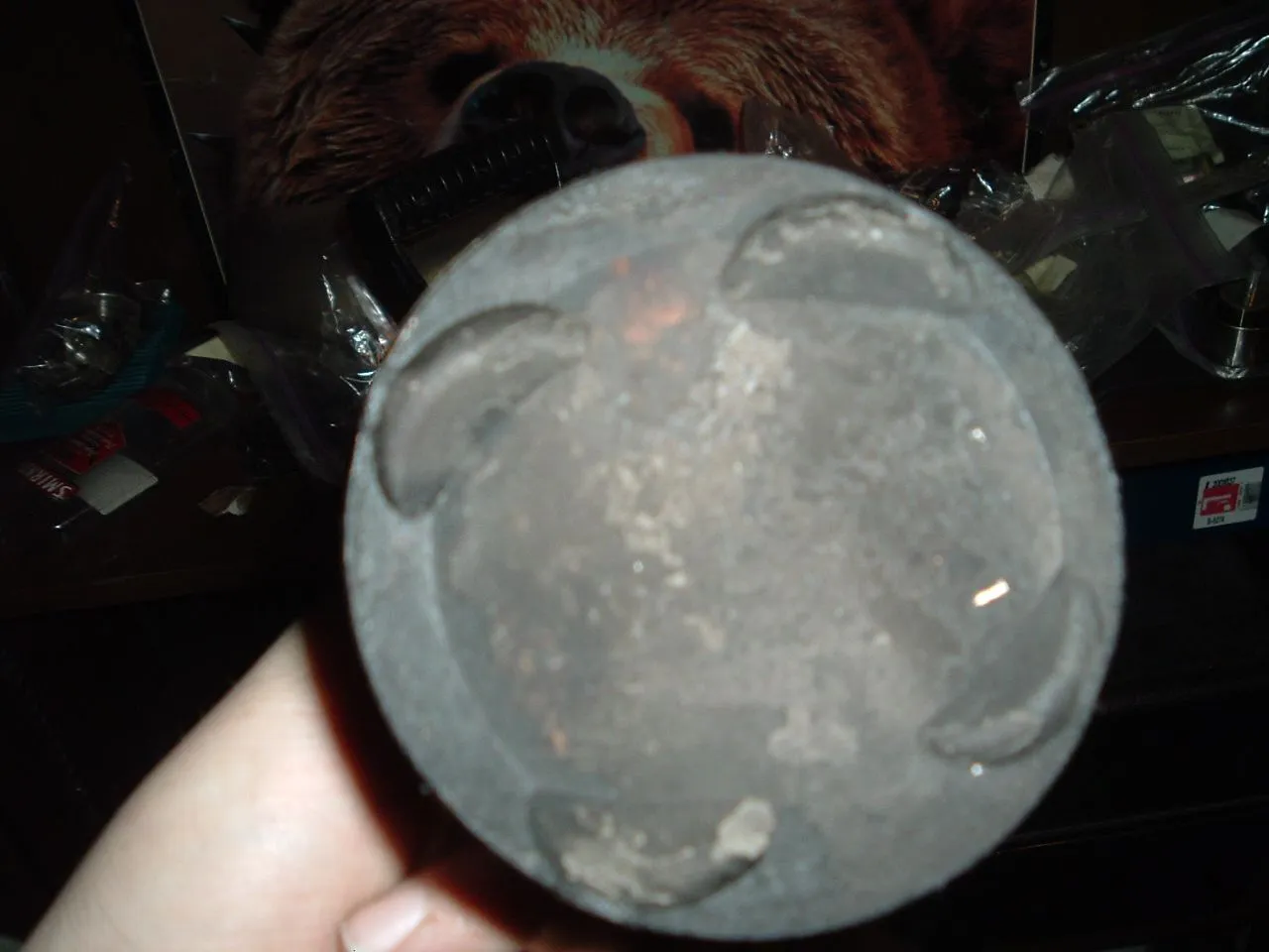

here you can see the difference between the piston that was in the "variable compression cylinder" compared to the others which are all still covered in carbon. None of the pistons are damaged, just have carbon buildup. The rings look fine but Im guessing a micrometer will probobly reveal otherwise. Here is a pic of the spark plug from the "variable compression cylinder" lol

I dont think so Im thinking it was the bearing got worn out from lack of oil from the pan not having baffles which caused the rod to bend in the end. I dont think I ever leaned out, I managed my s*** nicely never had a lean engine code before and people put down much higher numbers then I did on stock motors. Im one of those guys that checks his plugs daily and compression every week, I looked after every last part of the motor always making sure I wasnt ******* something. Plus I never had slicks or crazy sticky tires on the car so I doubt I ever actually hooked up hard enough on a launch or a shift to overload the stock rods. If it can last 200 hard runs at the track on sticky tires with blkzoomzoom driving the s*** out of the car I sure as **** didnt bend them from 14psi-10psi on street tires, heck I was I was making that kind of power. I doubt I was making over 250whp. I was always side by side with my buddies civic that runs 13.8-13.9 consistantly, Im thinking I was only at like 220ishwhp on a good day with lots of torque since it was at 14psi until like 4800rpm dropping down to ~10psi at 6800-7K.
has anyone else bent a rod and had the bearings ****** up or was the rod just bent?
