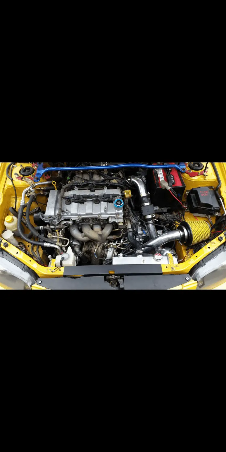

Hi All,
Going to attempt to make a thread on my build, it's going to be a big overhaul. Built trans and motor is the goal.
Goal is 350 to 400whp
Been doing research and trying figure out all the weaknesses of the drivetrain, I do know the transmission is horrible, so for the transmission portion I've ordered;
Mfactory gear set
Mfactory lsd the stage higher version with 75% torque engagement
Solid all 4 mount 3 hydra , 1 awr transmission one
Trans saver from exile motorsports
upper plate from hydra
lower case weld in plate.
That's my basics of what's being done to the transmission, I do have all the parts already for that.
Engine wise more of a mystery, I hear the oil system is bad, I'd love any the feedback!
So im process ordering all parts i need for this car, question is what pistons are good that wont yield me issues ahead, heard some ppl have weisco some arias, and if yall could help me with pointing out all weak areas of motor so i can adress all issues, gonna try do it right so that im not throwing my money away

The major weak point in these engines is the pencil thin connecting rods. Crankshaft is forged and strong.

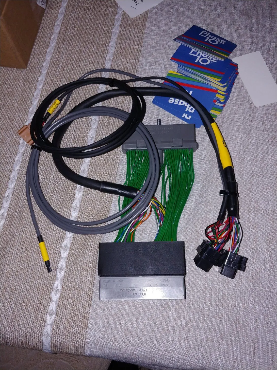

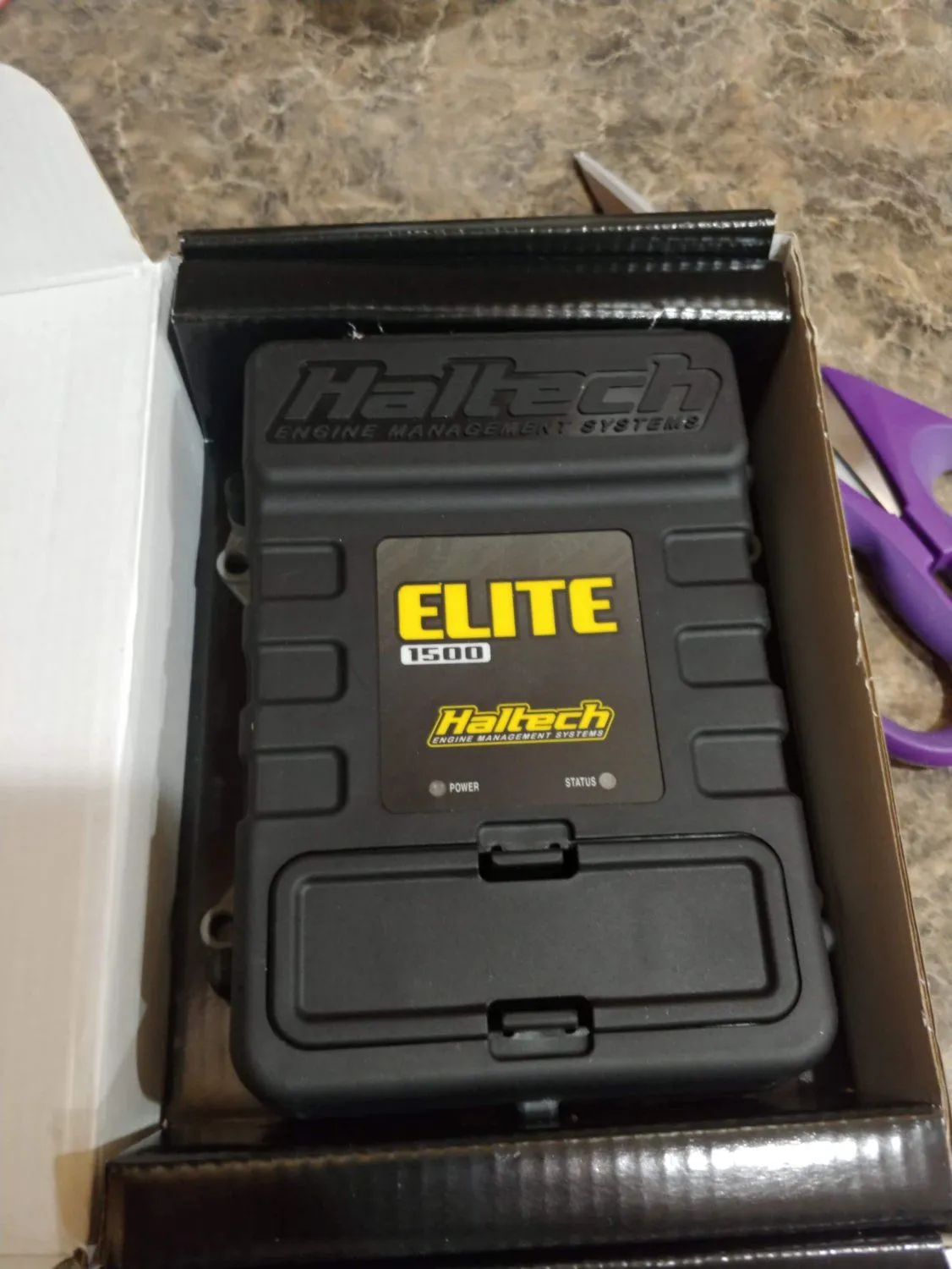

The haltech elite is fantastic, be careful when setting up the crank trigger though. Select the FSZE trigger setting. If you select FSDE, the tooth profile will be incorrect.

Current turbo is t2871r with a pope 3inch down pipe
