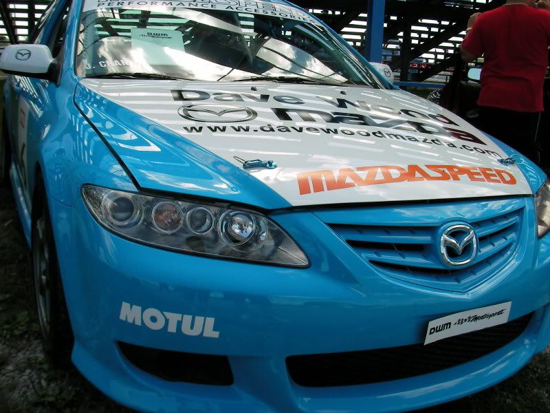

and regarding the pic...... that is ONE ugly blue color to paint your MS6......... yeesh

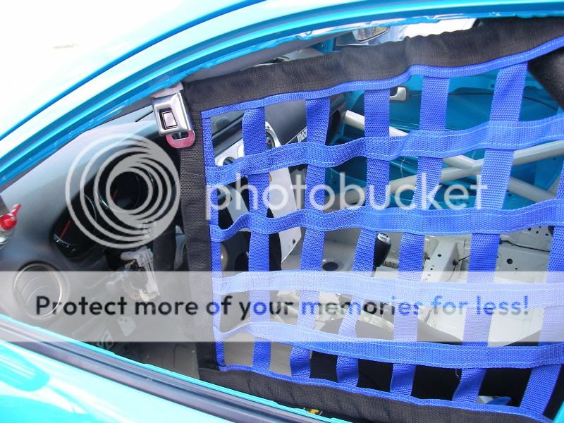

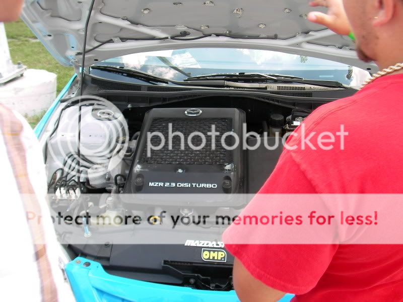

Oh, maybe I wasn't clear in my post. The baby blue 6 in that post is not a speed6 it's a regular 6 with the DISI engine and using a built standard I4 transmission. The car does the 1/4 in about 12 seconds I think from what they were telling me. The car weighs about 2500lbs with driver.
oh nice, it's one of those racing ones.
so 12 seconds and weighs 2500 lbs with driver eh?
Is it an entirely stock engine? or have they modified the engine at all ?
is it still FWD or did they do a conversion on it?

The car is FWD, and I think it's a totally stock speed6 engine. The transmission, clutch, and flywheel are all lightened and built to handle the power.
I didn't see the car run but it's most likely like 12.9's or something like that. You're still looking at around 10lb/whp + LSD with race slicks. So I guess that's like a Speed6 with about +350 to the wheels.

in that picture.........is that not a speed6 hood on the car? cause it looks like it.
also, I feel that 350+ to the wheels on a mazdaspeed6 would garner it faster than 12.9s, when you consider looking at MS6mike and jcegmt (or something's) cars running less than 350 and doing 12.8 and 12.9 respectively.(boom03) who really knows........
aside from that, the hood likes like the speed6 hood, but I'm probably wrong...... I like the speed6 bumper anyways, with the foglights and such.
That is not a speed 6 hood.
yeah thanks, I saw it on MY monitor, I was looking at it at work on a crappy monitor, the paint and light reflections on the hood plus the crappy monitor was playing tricks with my eyes.
