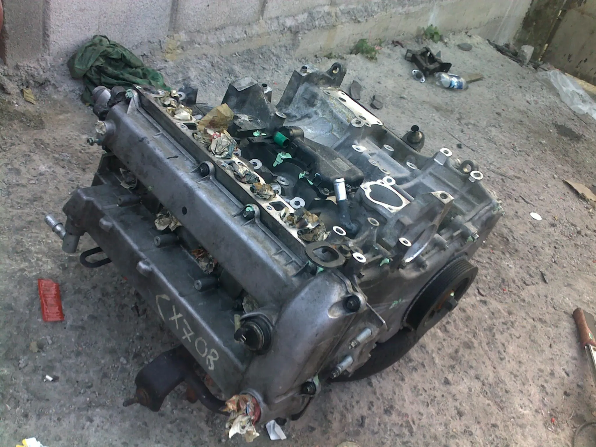

Hi guys, i have or had a Mazdaspeed 6 2006, last saturday i was driving very normal arround 60mph going from 3rd to 4th gear and suddently a f4ck*ng noise like a rock under the hood, that noise last about five seconds, then the motor dead and a little white smoke came from it.....end of the history: the block has a huge hole in it, just under the alternator. My mech said i was a rod. So theres nothing else to do than change the motor.....NOW here my question: does anybody knows if a Mazda CX-7 2009 motor fits to the MS6 2006??? this is because i live in Central America, and rigth now, this is the only one motor available in the area. Or what options do I have to replace.
FYI: the blows up occured (figuring) because the car had a EBC Greddy wrong installed, so i had overbosst and peaks (higher was 24psi), i must suppouse that it was repaired too late, the rod had some damage and now all is history.
MODS: FMIC, custom exhaust 3", HKS SSQV III BOV, HKS sparks, COBB SRI, EBC Greddy Profec SpecB II.
well finally I got a CX7 08 block to replace, the problem was the wrong EBC installation, the motor went beyond the limits with overboost and 24psi peaks, then the rod material was wasted then broken.

The blocks between the ms3/6 and cx7 are essentially the same. The mounts may differ but that could be changed. The rest of the drivetrains differ.
