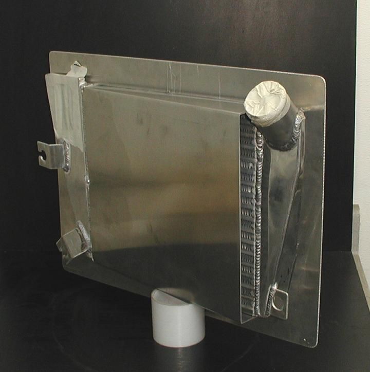

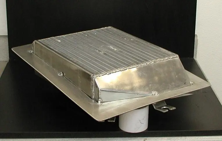

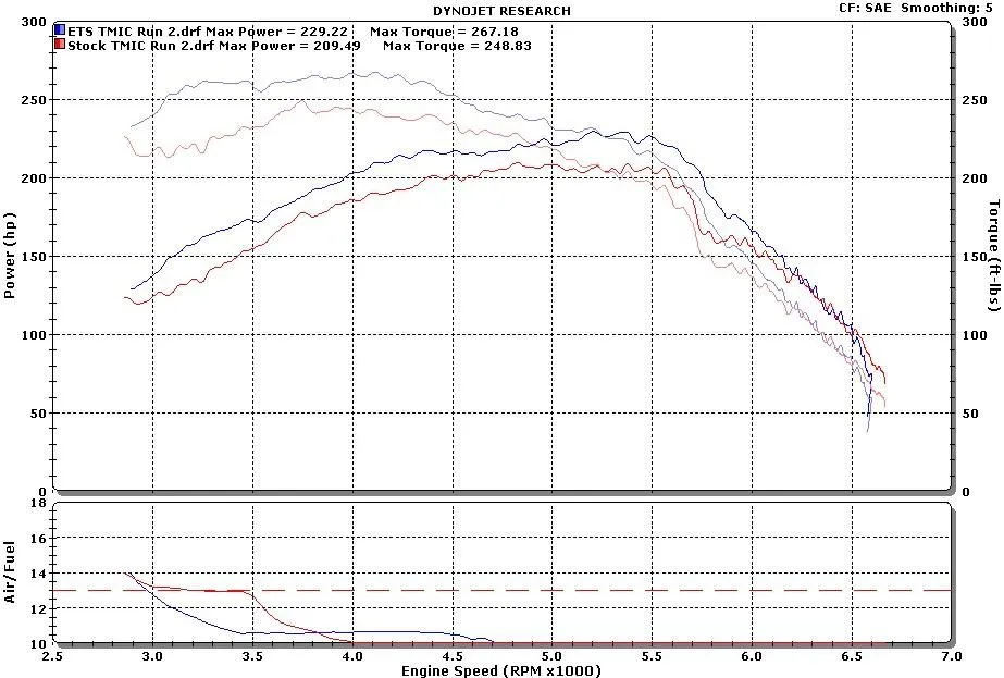

Hot on the heels of our FMIC upgrade for the Mazdaspeed6 comes our TMIC solution for the entire DISI turbo engine lineup. We have developed in partnership with Anatoly (CustomMSP) a complete replacement TMIC featuring a thicker, larger, bar and plate core with custom endtanks and an all aluminum design. The intercooler also incorporates a custom fabricated air diversion plate to increase air flow to an already enhanced design. Final production pieces and dyno numbers are scheduled this week with a final price expected to be less than half that of any FMIC kit to date. Based on our experiences with past SMIC upgrades on past vehicles, we expect great gains from this unit even on stock boost.
** BUMP UPDATE - DYNO GRAPHS POSTED: 20 WHP GAIN / 20 LB TORQUE GAIN!! **

kick ass. the price sounds like it will be good, just can't wait for installed pics and dynos. I'll be happy with an upgraded tmic, don't plan to push enough power to need a fmic, plus I don't need one to show off my car. :) (just playin)
(mswerd)
This is what I have been waiting for. Can't wait to see the numbers on it. Will you also be recording intake air temps under various conditions on the stock and new TMIC?
Can you give us some specifics on the core?

What would you like to know about the core?
Dimensions are: 14 x 12 x 3-3.5"
Bar count: 16
Pressure drop: ~.8psi @ ~370hp
