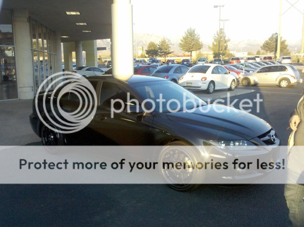

Not the best pic, but the new addition.
Just picked up an 07 MS6.. 6400 miles
Very Nice Find! Congrats!
