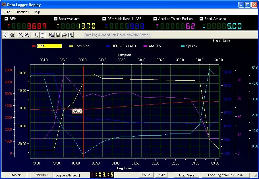

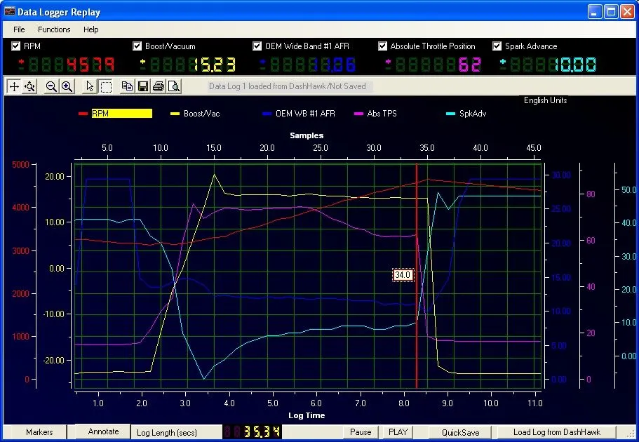

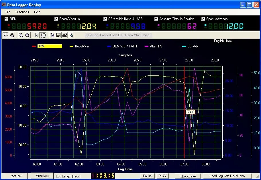

Here are a few of my logs tonight. First one is gears 1-3 and the other 2 are in 4th gear. Timing seems to be doing pretty much what yours is doing, dipping down a little below zero then coming up to about +10-12. It was fairly cold tonight around 45F (cold for San Diego ;)) and I've never seen my AFR so high before at WOT. Its around 11:1 in the 2nd & 3rd log. But its around 9.5:1.
Let me know if you want the actual log files. And I didn't read the last post before I recorded them so I didn't take it to redline. Maybe I'll try that tomorrow.
