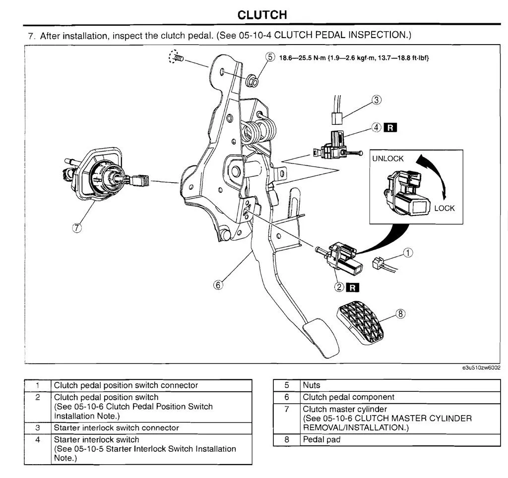

Just found this pic that might help you out
This is not a Mazda picture just so you know.
Did find a Starter Interlock Switch , talks about depressing the clutch to check continuity but it doen't tell where its located!!!! Anyone know please?
Have you looked up and down the clutch pedal yet? The pic posted by smoke is a pretty good explanation of where it should be.
Found the Clutch switch and bypassed it and no luck, anyone with any other thoughts on the issue, I think I am going to try and look at the ignition switch if I can get to it and look for a lose wire.

My guess it still is something to do with the clutch pedal position sensor. It happened to me in my Focus once, my foot slipped off the pedal and kicked the sensor breaking it. I didn't realize and it wouldn't start, until I pieced it back together to be able to push it down and it started.
How did you bypass it? Just unplugging it won't let the car start either, you have to trip the connectors in there for it to think the clutch is being pressed.
I unpluged it and ran a test lead from one port on connector to the other, I don't have an Ohm meter so I couldn't check continuity but there was a diffanant closed loop!
