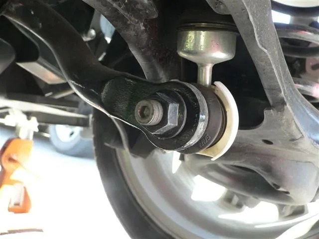

I have had my speed for about a month and have been hearing a clunking noise sometimes from the rear over bumps. I found the jack could move around but I fixed that and the clunk was still there. So I finally jacked it up and crawled underneath today to find the bolt on the stabilizer (anti-roll) bar right side link was completely loose! The nut was half way off the threads, I am surprised it didn't come all the way off - probably would have in a few more miles.
My manual says it should be torqued to 40 ft-lbs, so I try to tighten it and the nut won't tighten up. The threads on the stud are boogered up from banging around in the hole in the stabilizer bar. So I removed the link and had to repair the threads with a thread die. It's all back together now so I think it's cool, I will know for sure next time I drive it up a bumpy road.
Moral of the story - don't ignore clunks from your suspension; get it checked out before it boogers up the threads, or something worse.

To take it to the dealer means a 40 mile trip, arranging a loaner, 40 miles again to retrieve the car, probably being without my speed for a few days while they order the part. I have the capability in my own shop and it took me less than 1/2 hour. I'll go to the dealer when something needs doing that costs money or that I can't do.

As an update to this, I tightened up the loose nut and it seemed better for a few days but now the clunk is back. I put it up on ramps and looked around but didn't find anything. The nut is still tight and I didn't find anything else loose. It is going to the dealer tomorrow morning. I'll post what they find.

Yup...looked under the car and the same nut was loose...what is the deal with this car....didn't they do a safety check prior to leaving the factory???

I just got a call from the dealer. They say the link between the stabalizer bar and the suspension arm is bad. It's not in stock so I get to drive their loaner for another day. After the MS3, anything else seems really slow.

I did not put loctite on it. There was no locking material on it and the shop manual doesn't call for it. The construction of the bolt should not need it if tightened properly to begin with.
I think it was not correctly torqued at the factory. I drove it for a while before dealing with it partly because I am hard of hearing and wasn't really aware of it until it got really bad. Then I futzed around securing the jack, making sure the spare was locked down, and other stuff like that before actually getting under the car. I expect that with the bolt loose for quite a few miles, the rattling around damaged the link so just tightening it was not sufficient.

Tightened mine when I had my new tires put on today...I cannot believe that bolt backed out so far...
