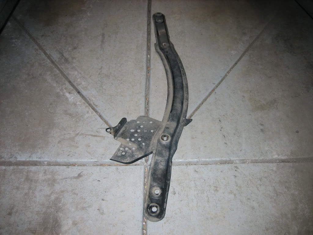

I just replaced my FSB bushings in my garage and have some tips that helped me since all of the instructions I have found focus on installations with a lift.
1. Raise the front of your car as high as you can for better access.
2. Remove the brace right behind the sub frame as shown in the following pic.
This brace is removed with 5 bolts.

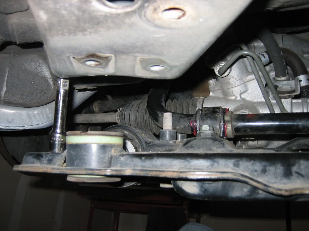

3. With just the front of the car up in the air, the sub frame doesn't hang the way you need it to. I used a ratchet extension to wedge between the back of the sub frame and the frame of the car as shown in the pic below.
As you can see, the Sway Bar bolts are pretty easy to get to in this configuration.
With these tips, your bushing replacement or FSB installation should go a little smoother.
