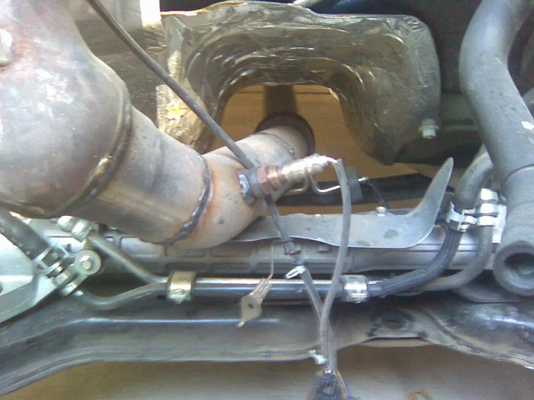

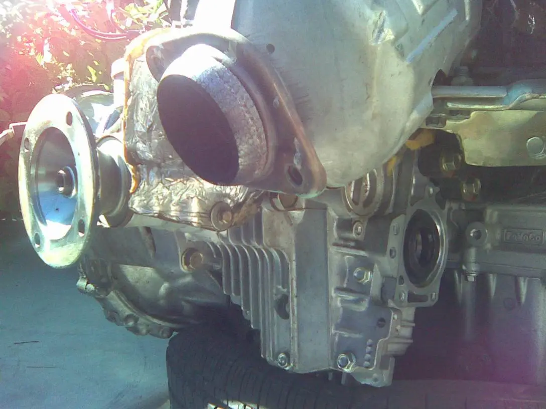

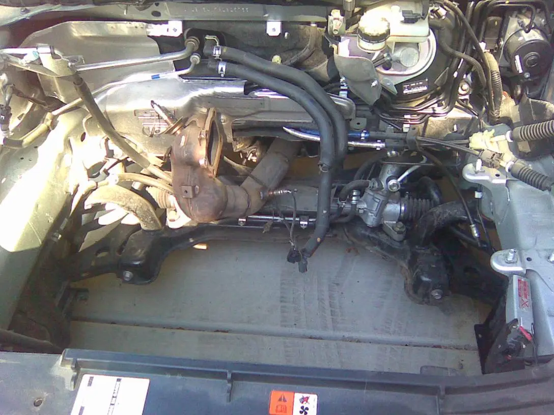

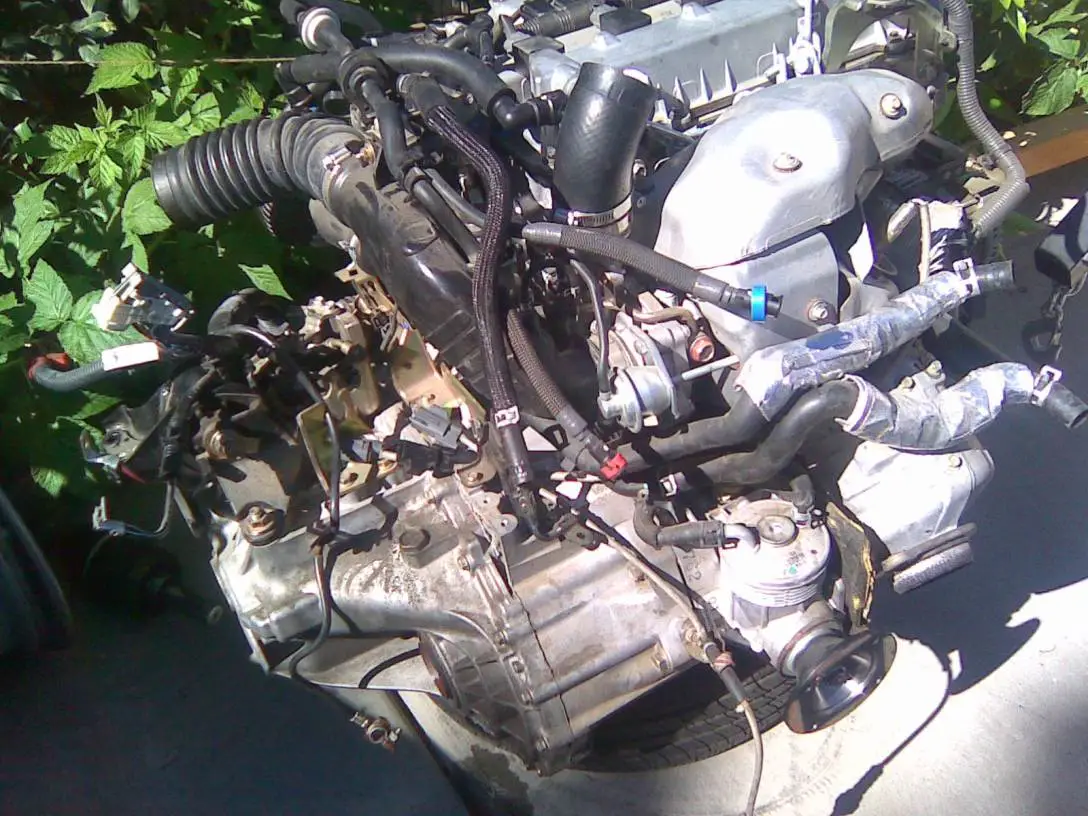

Finally have time from work to work on ms3. Took couple of phone pics of the engine bay and ms6 engine that I will be trying to fit in there. I decided that i will keep the tranny and pto from the 6, incase i want to take my project further(smoke). I will try to fit ms6's engine harness and fuse box and splice it with ms3 dash harness, since I dont want to buy engine harness for ms3. we'll see what happens(scratch)
If anyone knows where i can get electrical diagrams for ms6 and ms3 that would help alot.

ms3 bought it as a theft recovery with missing engine.
ms6 bought it totaled from a local person here in north cal.
