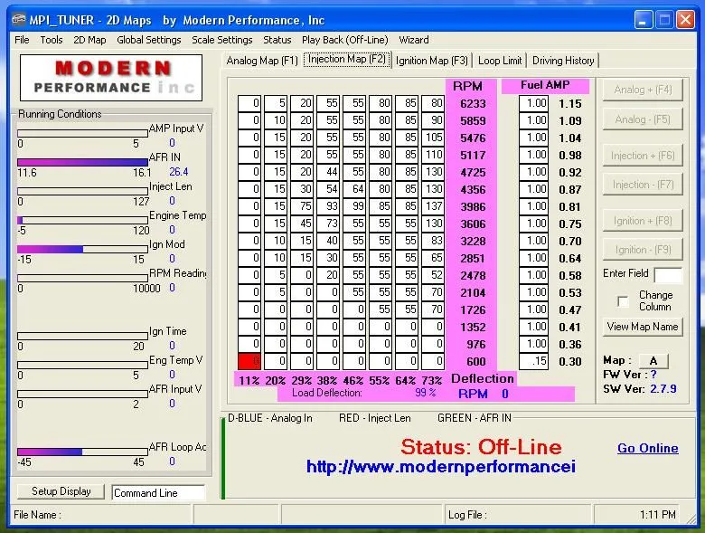

My 13psi maps from today.

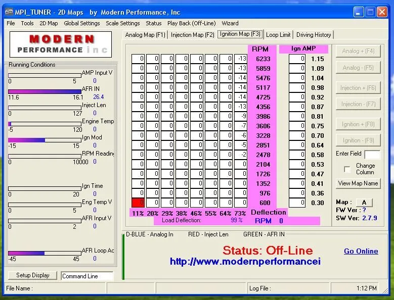

I dynoed 249 on my PDA dyno with these maps during lunch. Not my best, but I don't think it's knocking. I'm still playing around with it, and I'm running a 10.3:1 AFR on average. Quite rich.

Dude, that ignition map is all kinds of wrong!
Edit: To be a little more helpful.
You should either be using the AMP column and pulling timing based upon boost (via the MAP you are using), or you should be pulling timing in all areas (where boost is made) rather than just WOT. As it stands you are probably knocking if you run anything other than WOT, because you'll be building boost without pulling timing.
Hey, I just set it all sorts of retarded to prevent knock. If you have some suggestions, shoot 'em to me. I'm certainly no ignition expert.
PS - Before I tuned today, my A:F ratios were WHACKED. stoich @ 5K RPM and WOT, etc. Wacky stuff. So i reset the ECU and it "fixed it" quite a bit. Scary.

Looks ok for a race track!
LOL, yeah, well I start my tuning at WOT and work my way back.
Honestly, I haven't heard knock at partial throttle yet.
I agree with Beavis, you really need to retard more throughout most of the map. That's also a hell of a lot of fuel down low, are you running xtra injectors or no?
Beavis--shoot him a screenshot of your timing map so he has a reference as to where the J&S is sensing knock with the MP3 ECU.(thumb)

Dana..
As it has been mentioned above..you need to use the amp colum to pull timing..as you build boost..using your map sensor!
Chas
But if i AM knocking, I can't hear it.
Also, when I had the exact same numbers in my AMP column, it would go funky on me and knock. ???
I know one thing to always be true. If you hear knock it is worse then you think.
