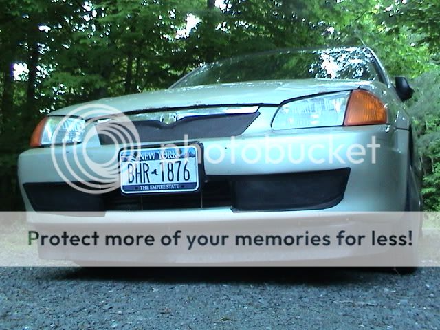

Here's more on my 163-k Protege. Last August I entered it in an Economy Run event. In my prep for the event I added the above upper and lower grill blocks and the only place left for cooling air was small slot below the licence plate. I watched the stock temp gauge carefully and it never moved any higher than before. So I thought it did not effect engine temp at all - and this was in August! I believed this until I later bought a Scan Gauge and then found out that I was mistaken. With a Scan Gauge unit I can monitor the actual engine temp [digitally] as opposed to believing my stock gauge. In most cars built in the last 20 years or so the stock temperature gauges are frequently designed to appear rock steady during driving, making the owner feel that his car is very reliable. When that needle reaches the center of it's range, the engine could be 150 degrees all the way to 215 or so! In other words, unless the car is really overheating, you never know exactly what's really going on.
This past weekend I made the same grill blocks out of choroplast and reinstalled them before a trip to southern NJ. This time though, I could see what my actual engine temps were with the Scan Gauge unit. My car normally runs at 195 degrees. With the grill blocks back in place, I got on the Thruway and the temp went right to 205 and kept slowly climbing until 213 deg, at which point I decided that was high enough and pulled over to widen the lower grill block a little. I didn't have to peel back the lower grill block much to get temps under control, maybe 2 inches on each side. I don't mind 200 to 205 or so, as a hotter engine burns the fuel more completely. So here's what I ended up with.
As an additional note, I now know that my electric cooling fan comes on at 206 degrees. Obviously if you're interested in best mileage you don't want your cooling fan to come on at any other time than when you're stuck in traffic. It represents an increased electrical draw on the charging system and raises fuel consumption. Generally it should never have to come on when you're moving. With my grill blocks in place, mine was probably on the entire time during last August's Economy Run!
So how did my grill blocks do on my round trip to NJ last weekend? Well in addition to my new low drag moon disc wheel covers and folding in both side view mirrors, I finally broke 40 mpg [41.87 actual] with my automatic equipped Protege DX. That's almost 10 mpg more than the car is rated for. I like that. :)
I'm not gonna lie it looks goofy, but if its what your into and its working then thats awesome.
