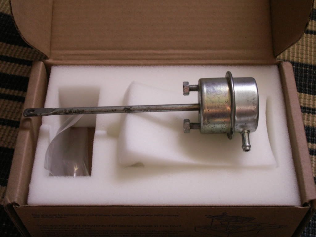

List Update: parts on the way/bought: Turbo GT2554R, ATP Wastegate 7psi 7. Oil return line, Oil return oil-pan fitting, Oil feed - turbo fitting

WGA came in today
