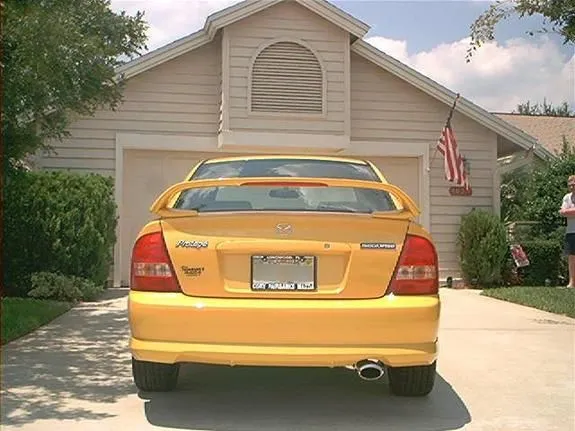

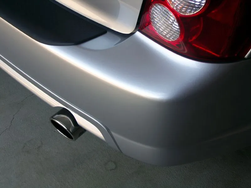

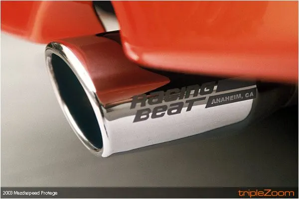

MP3 Racing Beat muffler has the "squished" oval tip, while the MSP is more of a rounded oval. Here's my Mazdaspeed / Racing Beat.

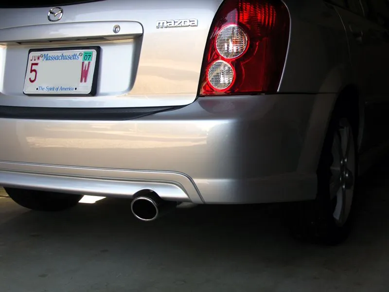

Are you sure? I think the MSP tip looks more like a squished oval than the MP3.
Pic#1 MP3
Pic#2 MSP

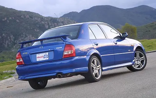

aMaff said:
I THINK that 03 msp's had a round tip
Yep, same tip as the MP3.
