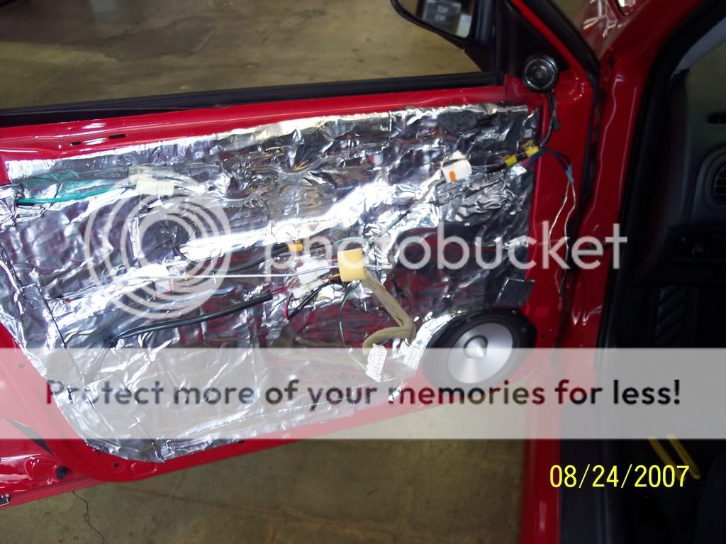

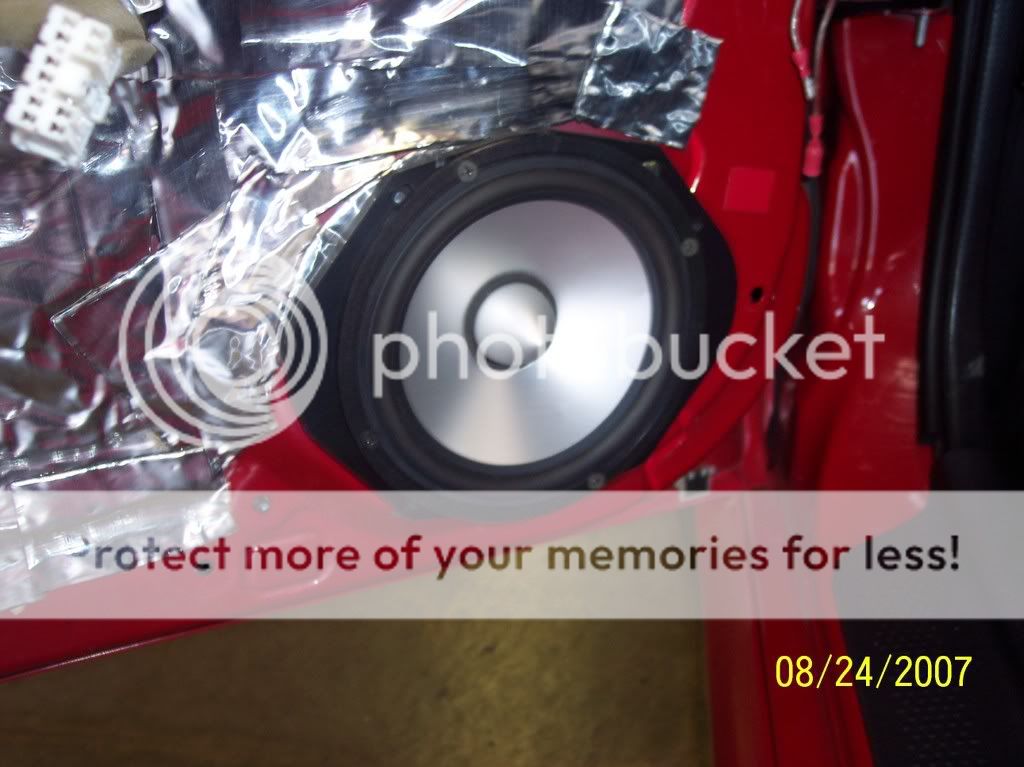

Here's a look at how my mids are mounted in my doors.....just a standard spacer in the factory locations, currently....
A larger baffle is probably going to exceed a smaller baffle in terms of less diffraction anomalies. Therefore I'd go with the 5x7 to 6.5". That's what I did originally. Then I took the plastic factory rain guard and traced holes to countersink the factory screws. IIRC I thought I needed to get them down about 1/2" if you're using 3/4" MDF.
The main recommendation I'd give based in my experience using MDF is to coat it in either liquid sound deadening, fiberglass poly resin, or bed liner spray. Or something that will have a good affiliation to the semi-porosity of the MDF (ie soak in). Otherwise, expect....
That's why I switched to a composite of PC or HDPE plastic and lead in my baffle building. A combo between moisture, improper screws and lots of them over time basically destroyed them.
I also switched because at 3/4" MDF, I found the cone would hit the door under high excursion. Went to 3/8" HDPE and it did the trick. Had Lotus Ref and Rainbow Profi mids on them and it cleared both the window and the door panel just fine.
