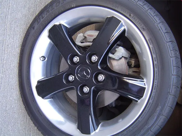

I finally finished my four month project today. Way back in January I powdercoated some stock 03P5 rims with my brother in law. Yesterday I finished polishing the aluminum and mounted them today. Next up is to paint the calipers red and of course drop it. Enjoy the pics.

Wow, doesnt even look like the stock rims. Bring that sexy sheet to the meet.
I think that looks really good! awesome job, im guessin you got the spokes powdercoated and just polished the lip up yourself? what did you use?

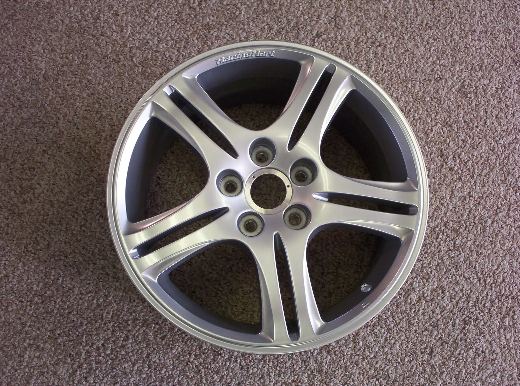

Nice touch for a stock wheel. I got a deal on MSP wheels but for some reason ended up with MP3 wheels. still have to get some rubber.

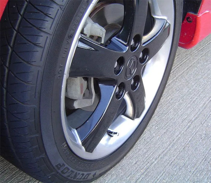

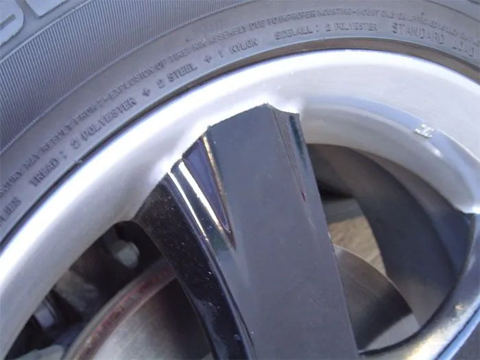

Sorry about not replying sooner, I've been to 3 Red Sox games this weekend in Texas. There are some close up pictures below, I still need to do a little touchup where the powder didn't hit the metal right. The white specks and other debris are dirt from driving so much. The process isn't all that hard its just time consuming.

Wow, those closeups look great, even though you pulled off the tape.
