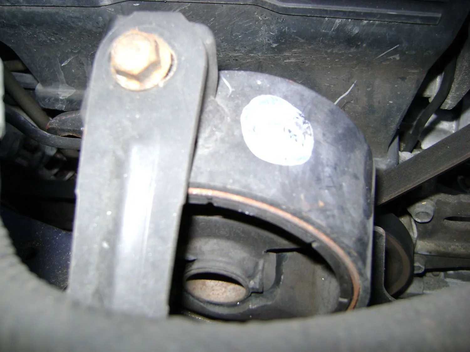

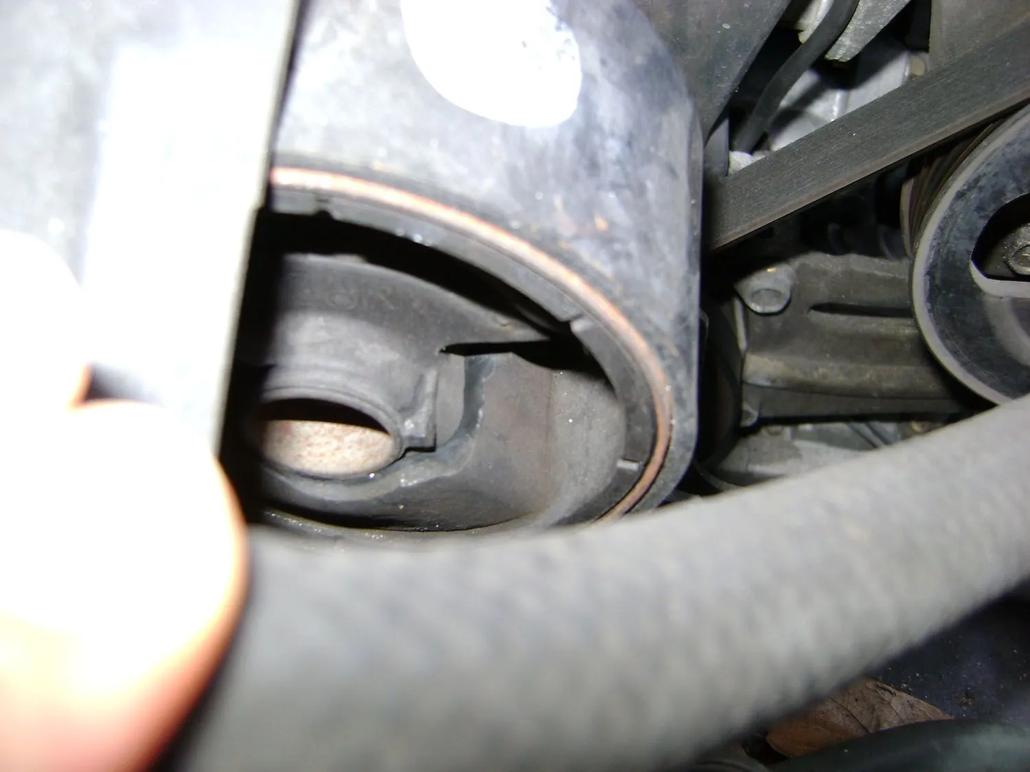

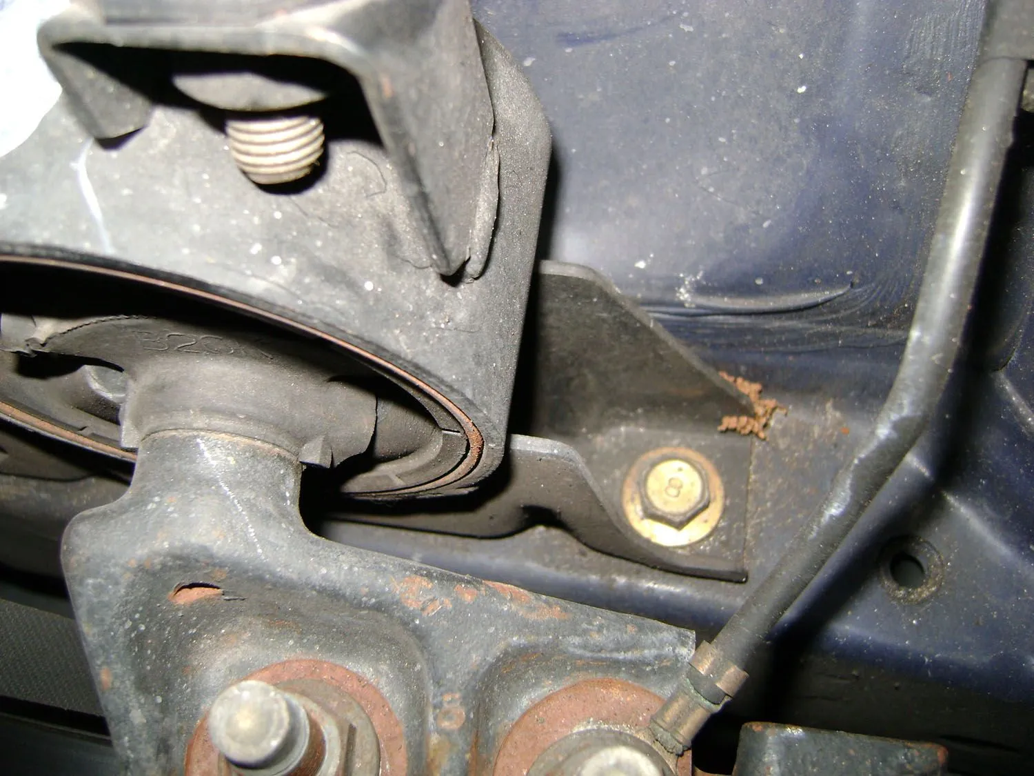

Ok so i've ordered the AWR front and rear including the inserts for the passenger side and tranny mount. I've included pictures of my side mount as i dont know if its bad and needs replacing or i can just stick the inserts in and be good, so i turned to my p5 brothers for some knowledge.. any help is greatly appreciated.

looks broken to me.. i'd SUGGEST getting another stock mount and putting the inserts in there.. but if you dont feel like buying those, i'd just put the inserts in that. it's not really recommended.. but i guess you could put some epoxy in there also.
Your passenger mount is toasted. I would highly suggest getting a new one instead of just the inserts. There have been several for sale here on the forums in the past week or so.
My suggestion is to replace the mounts that are broken first, then move on to the others. The back is definitely the hardest, but if its still good, why change it out now? Fixing that ripped passenger mount will make it feel like a new car.
