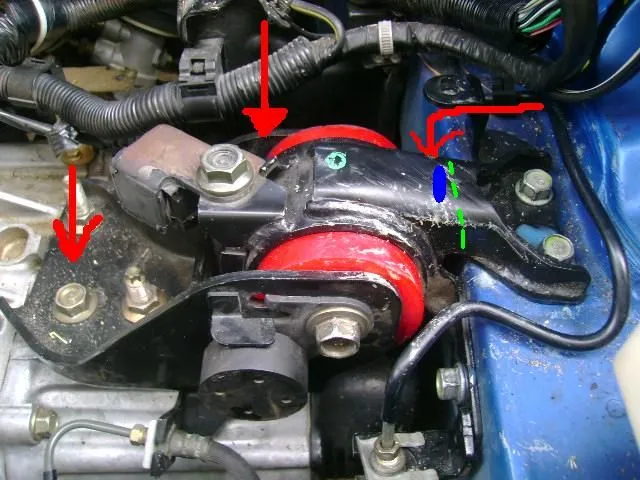

Well, I did the side mounts yesterday, I found a nice hard spot on the block just behind the front mount and got the job done although it was a PITA. I thought the passenger side one was a b**** because of the flange but that was nothing compared to the driver side bolt that is in the side of the chassis. I tried every type of socket and wrench and eventually gave up on that idea to break the bolts holding the mount to the transmission. Well, 3 of the 4 mounts are in and not bad, just broke the battery tie down bolt and broke my dad's socket wrench while trying to break the bolts from the transmission. I found that much more accessible compared to that 1 damn bolt on the back of the mount towards where the battery would be. So in total, it would have taken me like 2 hrs for both the mounts but i spent 1 hr on the passenger side and about 4 on the driver side.

yeah, it helped me prep for the whole thing and was a very good write-up. I just wished that the damn driver side mount wasn't so hard to get to. I ended up leaving the mount bolted to the chassis and sticking the inserts in that way and sliding the mount from the transmission over it. Anyways, I think I'm about to call it done with changing out mounts for a long while.
The 3 red arrows are truly bitches of the whole install, if I could get that damn bolt off, I wouldn't have had to spend 3 hrs on that 1 damn mount.
