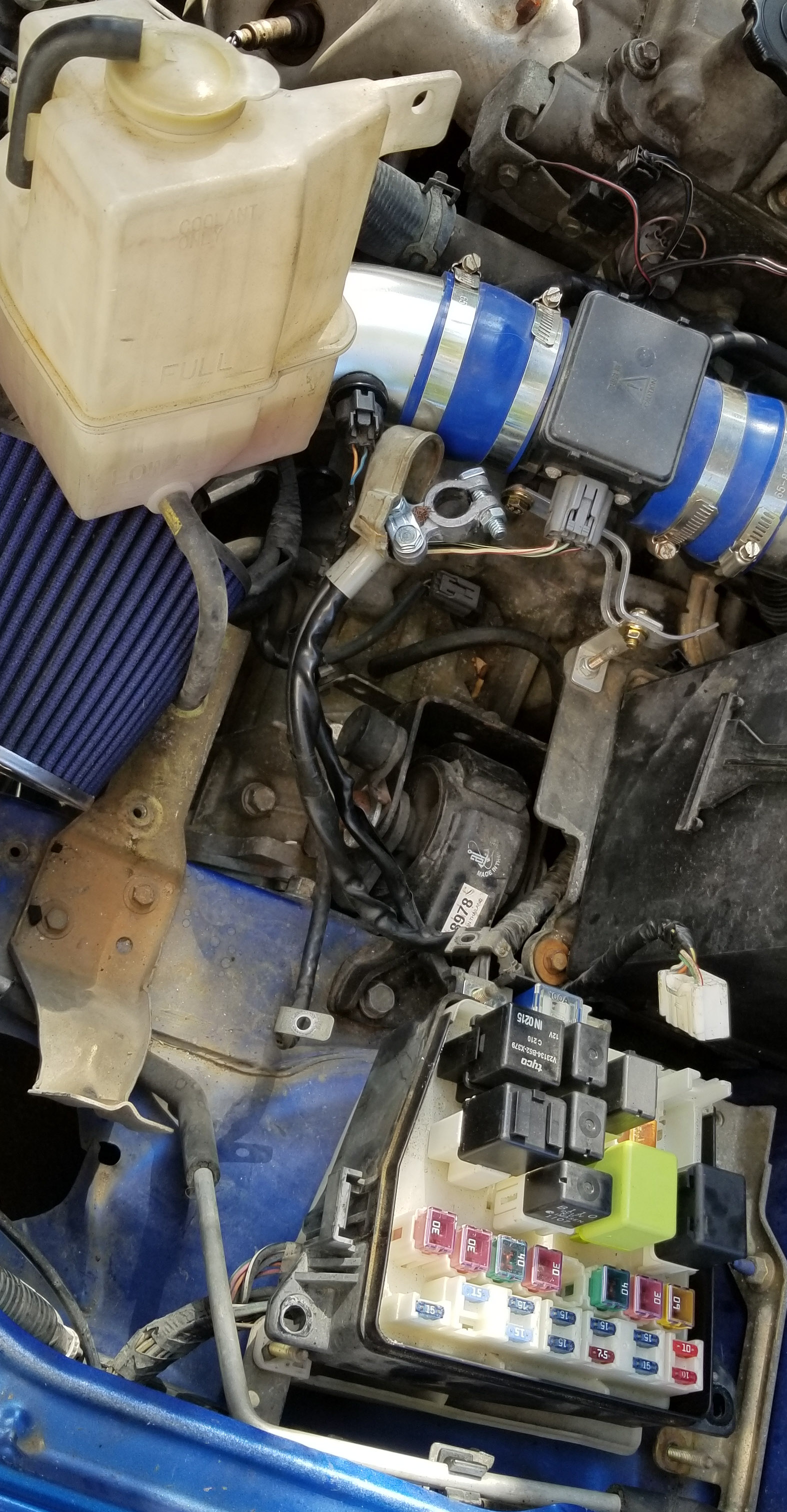

This is a picture of the the fuel pump and relay.
You should get +12 V going to two terminals in the relay socket.
Measure between the terminals and a good ground.
If you don't get +12 then the power isn't getting from your main relay to your fuel pump relay.

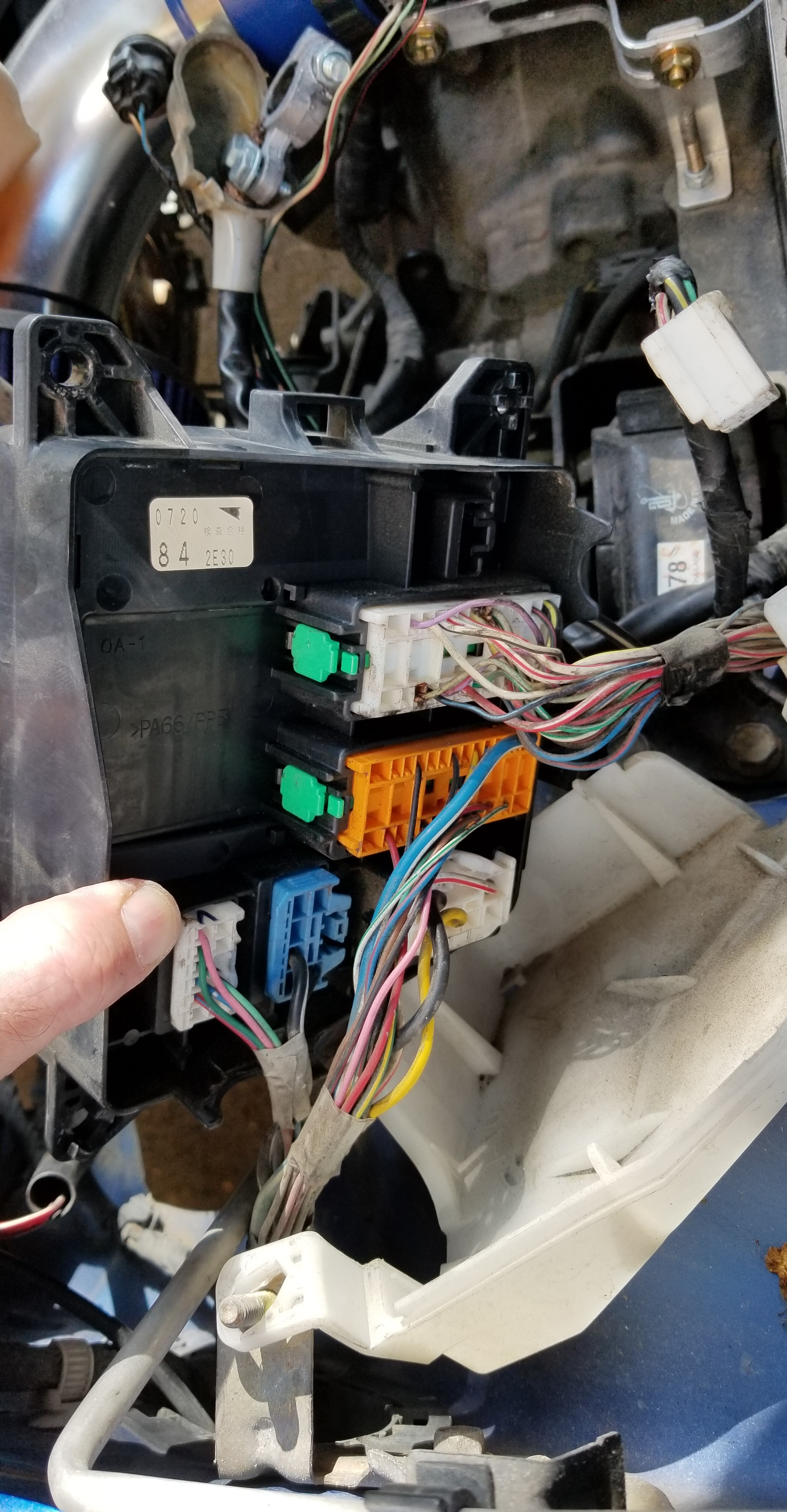

Fuse box: three 10mm bolts for hold down, two 10mm bolts for power and ground on main fuse thingy.
On top of box is one small connector to unplug.
Under the fusebox are 2 big, 2 medium, and 1 small connectors that are easily unplugged. The big ones are held in with green slide clamps in their mounts, kinda BMW-ish style.
Of the two big connectors, one is orange and the other white. The white one is probably the one with the fuel pump wiring because A) It's on that side of the fusebox, and B) Both parts car and the Blue Lemon have scorch marks on some connections.
I'm taking the fusebox back off the car now, will post pics.

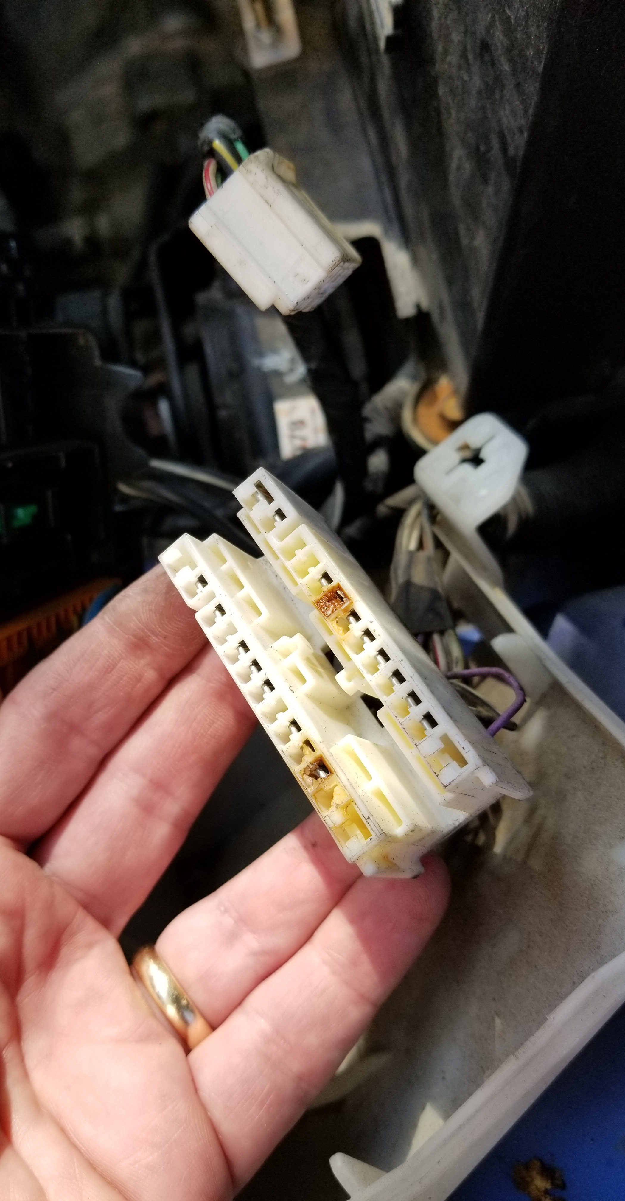

Fuse box pics being uploaded soon, Blue Lemon has very little discoloration on large white plug - in fact it looks like old dialectric grease and there's no melting at all.

Fuse box:
Pop up the coolant reservoir and lay it aside, otherwise you can't turn the box over:
Use little flathead screwdriver to depress locks on green sliders to free the big connectors.
Old grease?
