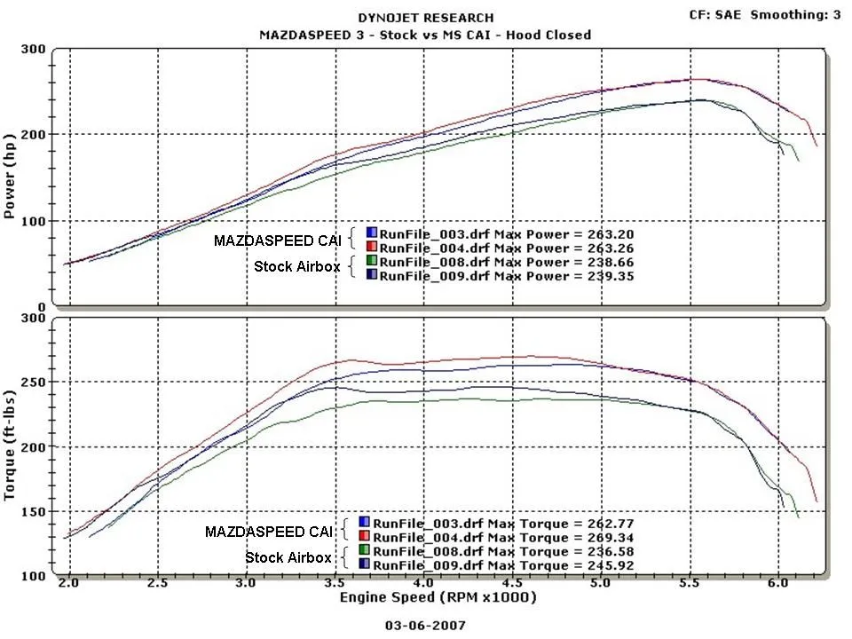

I recently has a Mazda CAI installed on my new MS3. Here are some observations:
1. I think I feel a loss of low end torque
See graph attached. Power and torque are higher than stock at a lower RPM.

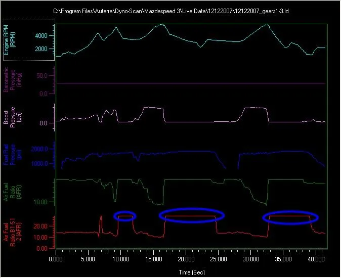

I believe this is a fuel pressure issue. My fuel graphs show an initial drop in pressure to 400psi when I first punch it, then it climbs up to ~1700-1800 psi.
3. The car pulls hard above 3000 rpm but not so much below 3000 grand.
The car does pull harder at lower RPMS (See Dyno comparison), but it also pulls even harder at high RPMS.

Yes. I went back to stock to Dyno the car in the "before" configuration. I was glad to get the CAI back on a few days later.
