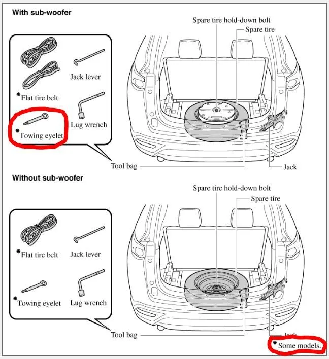

So, in MB, I need to display a front plate. I don't want to drill into the front bumper, so I wanted to purchase a license plate mount that would be secured to the front tow point. Basically, instead of installing the towing eyelet as shown in the attached picture, I would simply install the license plate mount.
attachment.php
Unfortunately, my car didn't come with a towing eyelet in the tool bag, and I assume this is because I didn't purchase the OEM hitch accessory. Can anyone confirm this fact?

The eyelet should be there. It is a recovery item, not an option for towing.

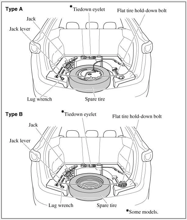

Is it in your tool bag (by the spare tire)? Because it isn't in mine. I also chatted with a Mazda Service Rep, who confirmed that the eyelet is not included on certain models, and that Mazda stopped including it on all vehicles sometime in 2014. There is a possibility that I overlooked it in the trunk, as I only looked in the bag that the manual references. The eyelet on the CX-5 has a cutout in the foam material surrounding the spare (see picture), so I wonder if it could be the same with the CX-9 (but the CX-9 manual suggests otherwise).
