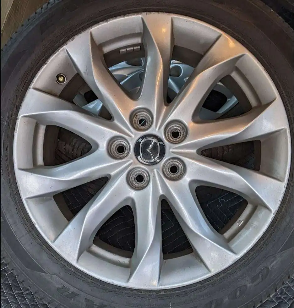

I just recently purchased a new (2 me) 2014 CX-5 GT. The 19" tires are shot. Where I am, the roads are bad, and I'm thinking of using 17" rims from a NC Miata (with 225/65R17 tires). This is a long shot, but has anyone tried this, and broke a rim by using a Miata rim (from less load capacity) ?
The 17" look tiny, especially when the 19" is closer.

The 17" rim did fit flush against the hub without any problem. The Touring trim came with 17" from the factory, so it's good. I know the offsets are off a little. These are 55's.

These 17" Miata wheels are approximately 17 lbs.
Your CX-5's curb weight is about 3400 lbs. The NC Miata wheel has a maximum load rating of about 1100lbs. I don't know if this would be considered safe to use, but I'm not sure I would risk it on "bad roads".
By comparison, your OEM 19s have a load rating of about 1700 lbs, which is half the curb weight of your CX-5. My 2018 CX-9's OEM wheels also have a load rating that is about half of the curb weight of the car.
I'm sure the taller sidewalls of the 17" tires would soak up many of the bumps, but yeah, take that info for what it is.

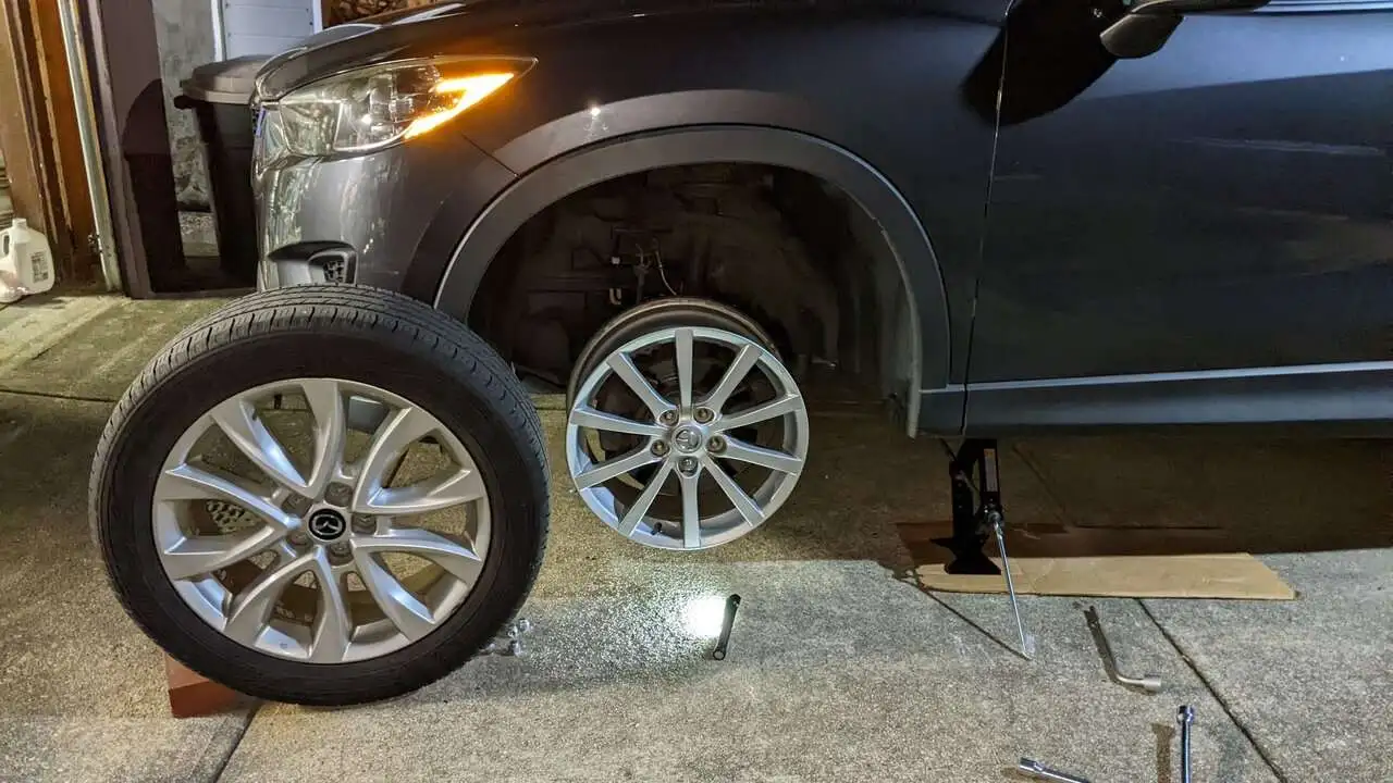

I just picked up a set of these wheels today, thinking they were 17's. Another member of the community pointed it out to be a 18's from a Mazda 6. The back is stamped 18x7J 50, so they should fit. Any chance you might have a idea of the load rating on this baby? Appreciate the help!
{edit: as it turns out, the 2018 Mazda 6 GT is nearly the same weight as my CX-5, so we should be good!}

Using their calculator, I could see that 225/60R18" would fit the rims I have, and not stray too far from stock. Their data is very accurate. Not to knock on them, but I don't understand why they list the 18" rims from a 2018 Mazda 6 as being 7.5" wide, but the back of my rims is stamped 18x7J 50. I should just take a ruler and measure it LoL.
