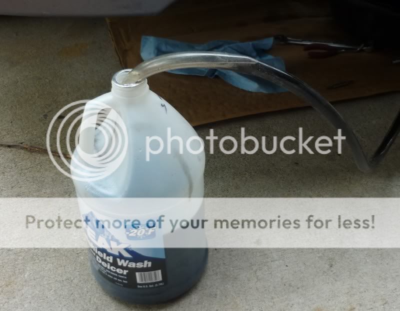

As in the above write-up 8mm hex to remove the drain plug my service writer say doesn't exist. Hardest part is getting the clamp off the line-out on the transmission cooler only because clamp faces up which makes it a bit more difficult to remove. I hooked up 3/8 tubing and put the other end in a plastic jug I had labeled in quarts. I was able to have the jug over on the driver's side so that I could watch the fluid coming out. It came out a little slower than expected, which was helpful when doing the job without an assistant. I pumped out 2or3 quarts at a time and then added the same back into the tranny.

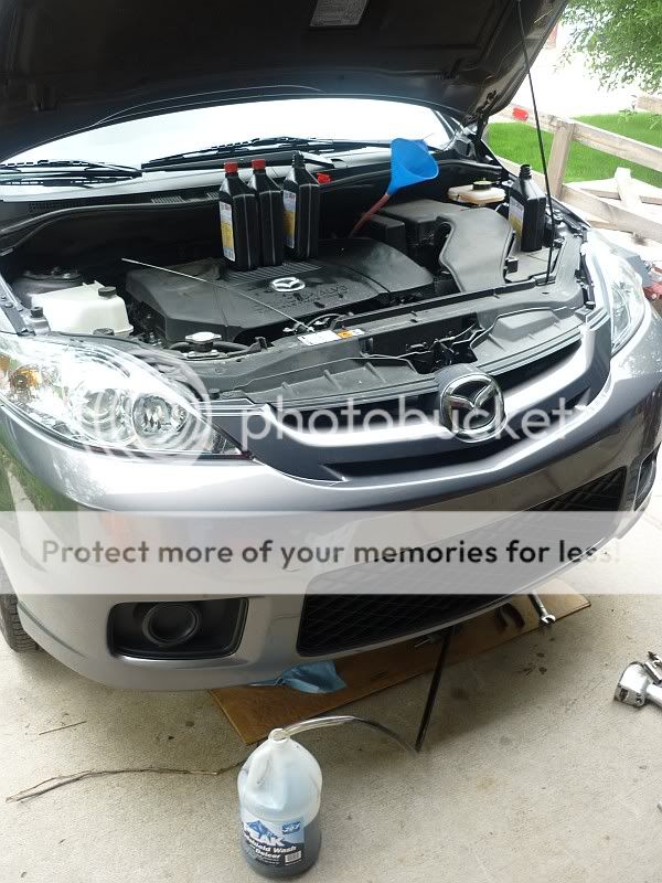

Did the change today and the fluid was BLACK as engine oil, not a hint of red left in it. 45k miles is probably too long to wait for a service, I'm going to do it again at 60k (and the filter) and go 30k intervals. Took about 9 quarts to do the home flush. Since my funnel wouldn't fill as fast as it pumped out I would pump out 2 quarts, turn it off, fill, repeat. The fluid isn't entirely red but its 100% better than it was, I can't believe it still ran flawless. Used that Oreily Global ATF so we'll see how it holds up.
Some pics
