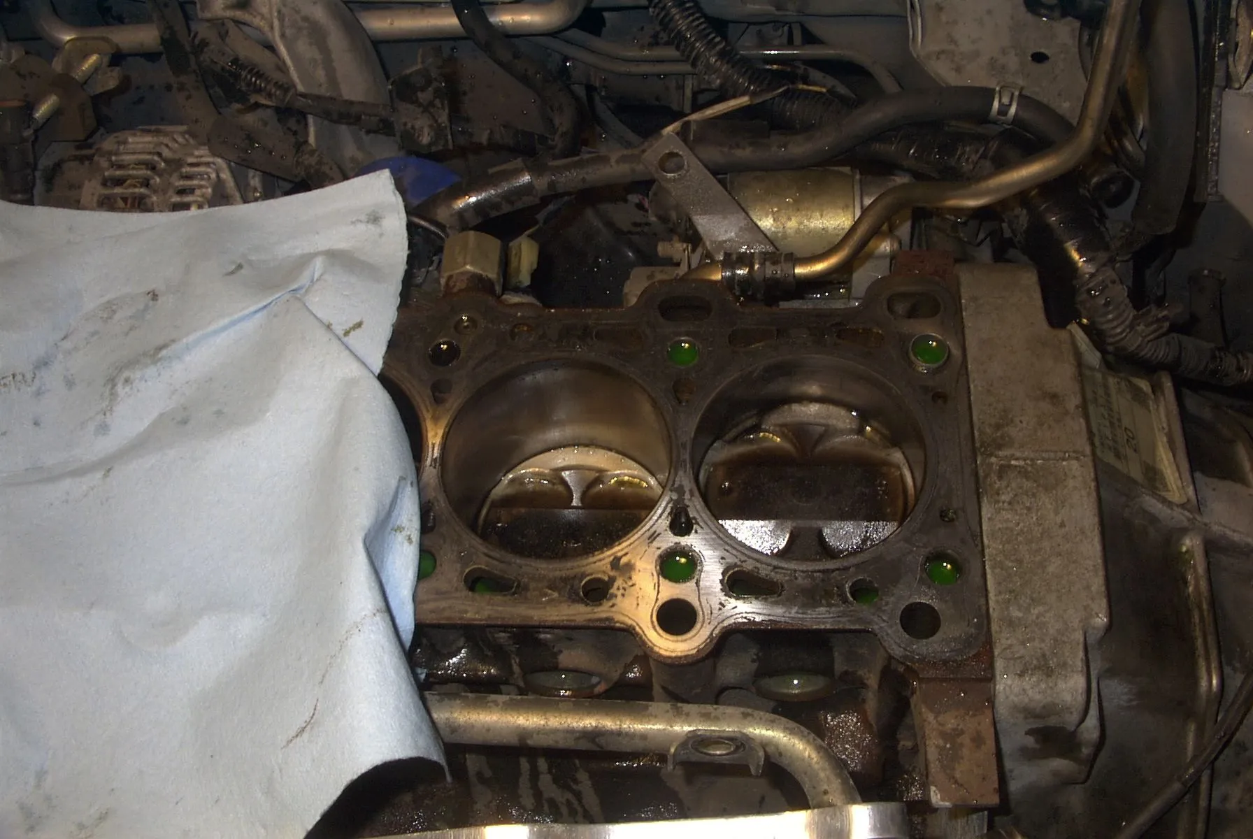

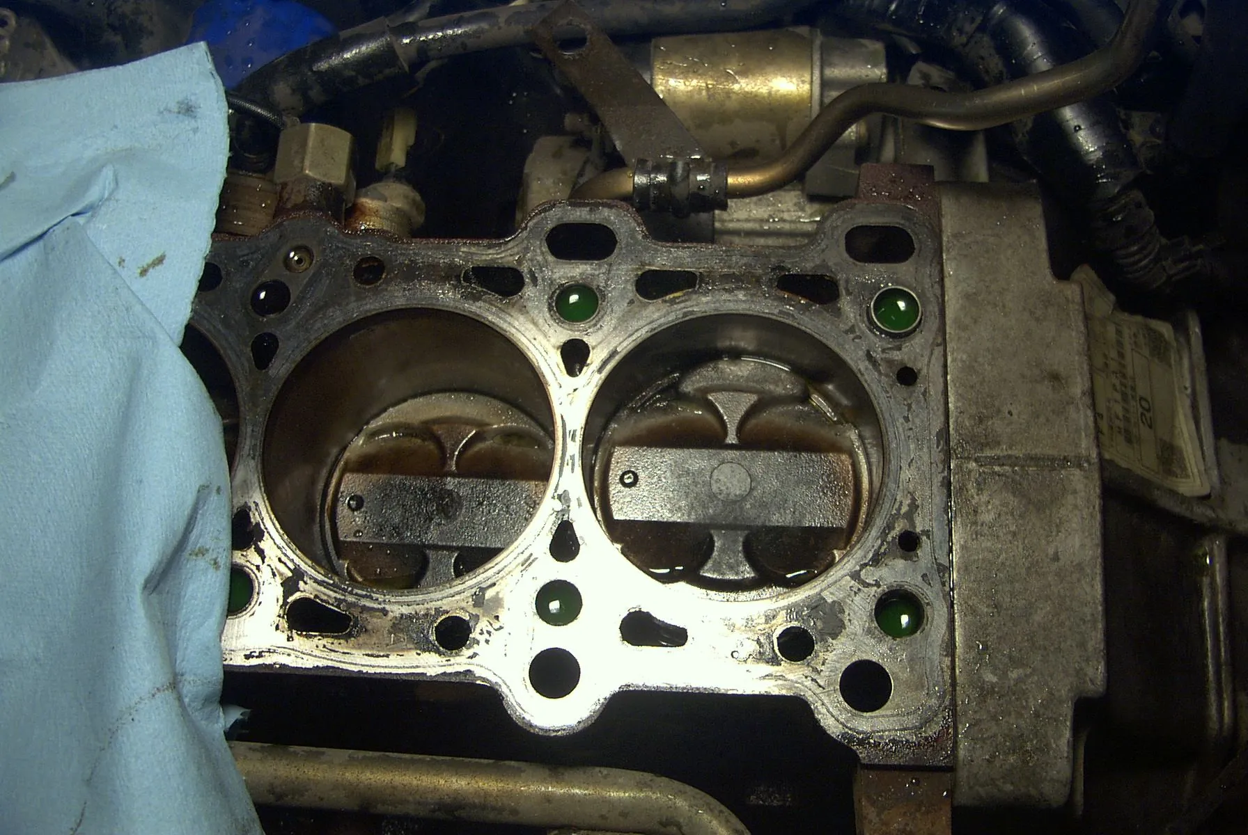

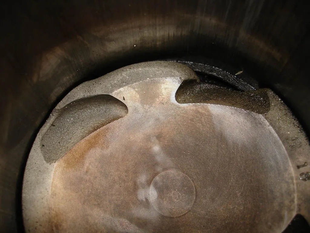

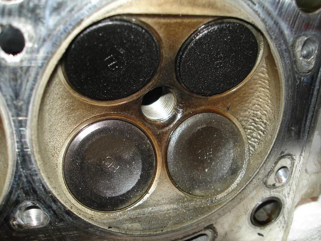

Yup. #4 went lean after spiking to 12psi. Will be replaced with the Arias / Pauter combo. Melted the piston, (IIRC EGT was approaching 1400* after turbo) and then oil rushed up into the cylinder. All this at 6000RPM. I'm surprised it lasted as long as it did to be honest. As you can see, the head will need a bit of polishing, there's some of the piston melted to it if you look close. And the cylinder walls are scored, but I'm going .020" over anyway, so no problemo. Anywho, on to the pics.

Ya, thanks guys. Running a TB03 60 Trim. Looks liek that cylinder just leaned out a tad too much. Oh well, could have been worse. For engine management, I'll be running a Split Second AFC II. I've got it under my bed somewhere...

Ya, I'm surprised it lasted as long as it did to be honest. Oh well, we'll get it running 22psi next LOL! Yeah right. My goal is 14psi daily, and 18 at the track. Should be good for about 350HP On 18psi. Maybe more.

maybe you should get your injectors flow tested....that injector could be flowing less than it should....adding to the lean condition.w
prolly too much ignition also helped in the meltdown.

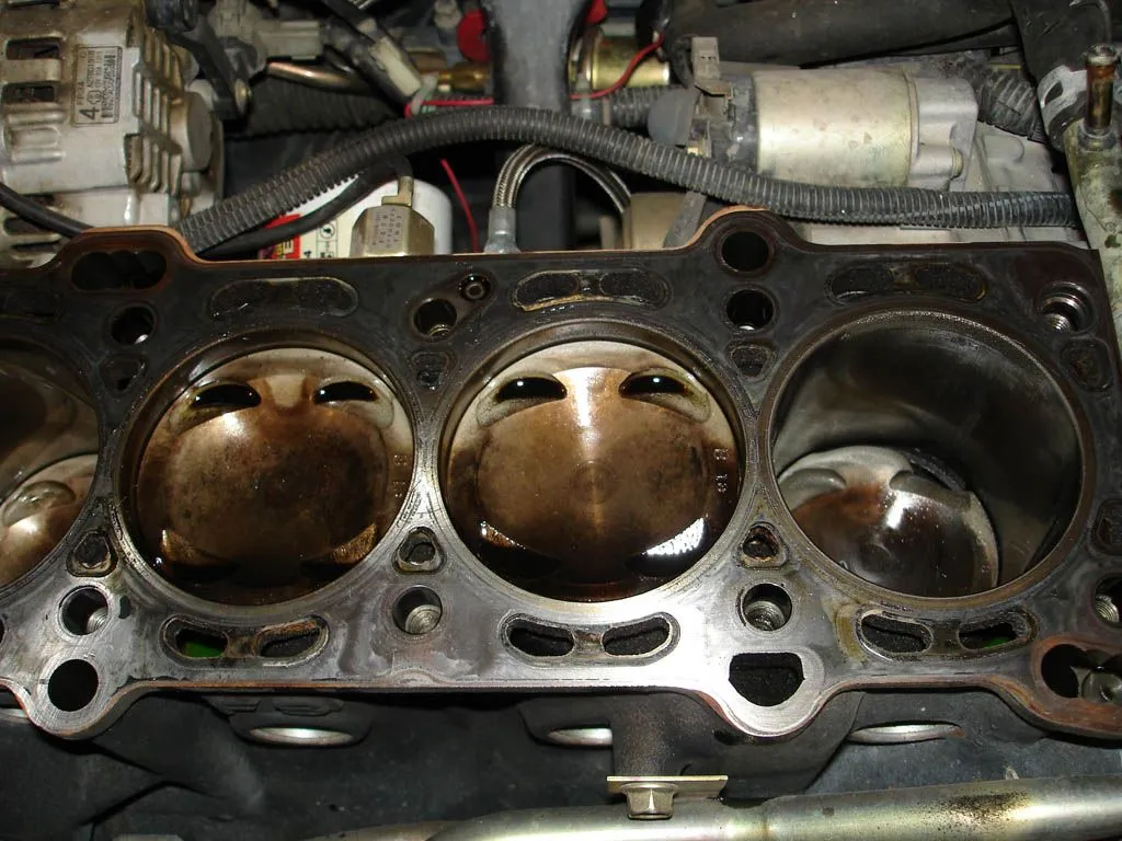

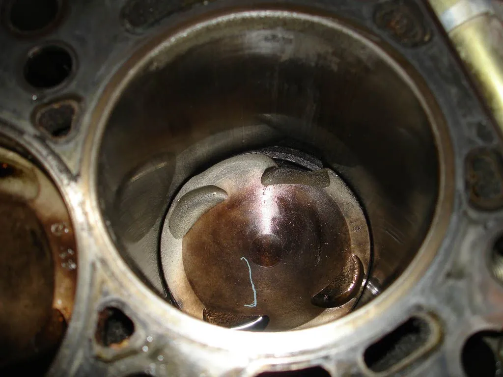

Ran Lean
sound like a pattern maby. this guy is on his second super charger and was equiped for 93 octain gas and higher bost with a piggy back ecu. but the ecu never came. so it "should have been fine" as long as he didint beat it. but he did. so this almost looks identical to what you have done.
