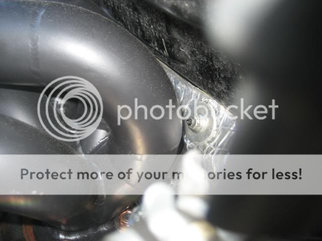

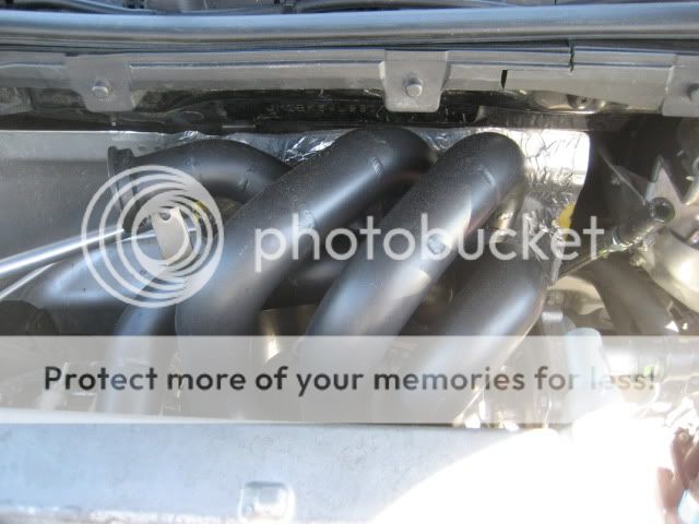

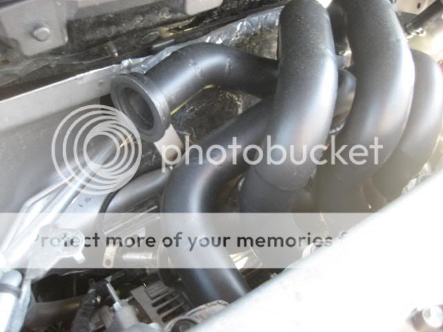

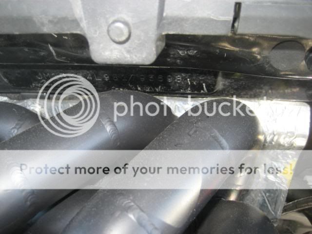

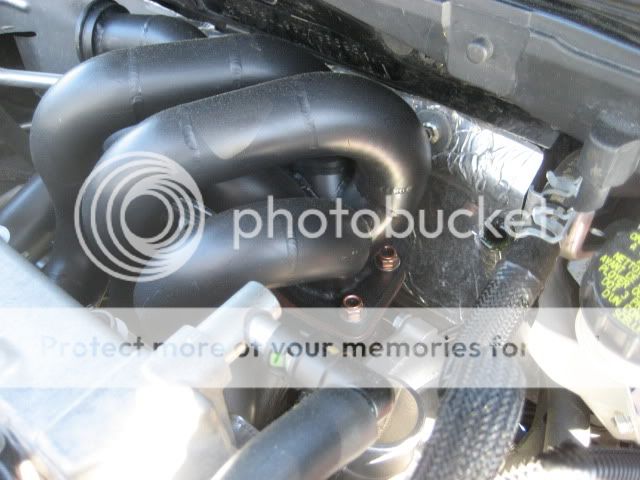

This is done with a gt3076 and a custom made downpipe that was already on with the stock turbo. Everything bolts into the factory location with very few problems. The head studs must be removed and some of the studs on the turbo require a little shaving as well as a little technique when bolting the nuts on the turbo. There are no fitment issues as you can see from the pictures. Plenty of clearance and nothing had to be shaved or modded. All in all its pretty easy to be done, just takes time and a brain.
Time to reinstall mine. I had to remove it for warranty. It is a PITA to install, but gains are very noticeable.
What will you be using as turbo back and man that is close to the firewall! you will feel the the heat in the cabin, but who cares with the performance. Looks like good fun. I am looking forward to your report on performance. That thing is going to come on boost hard!
