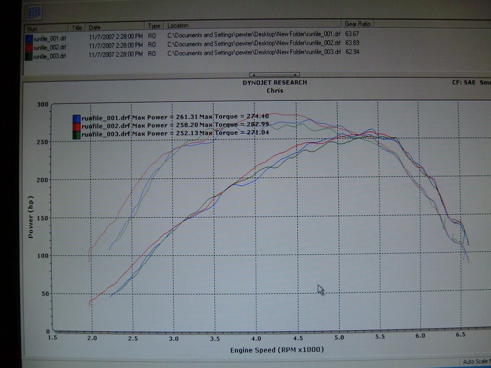

#5 Oz owner (with 50 mph fan and "bonnet" closed. K&N Drop-in; Running synth in the engine and trannie):

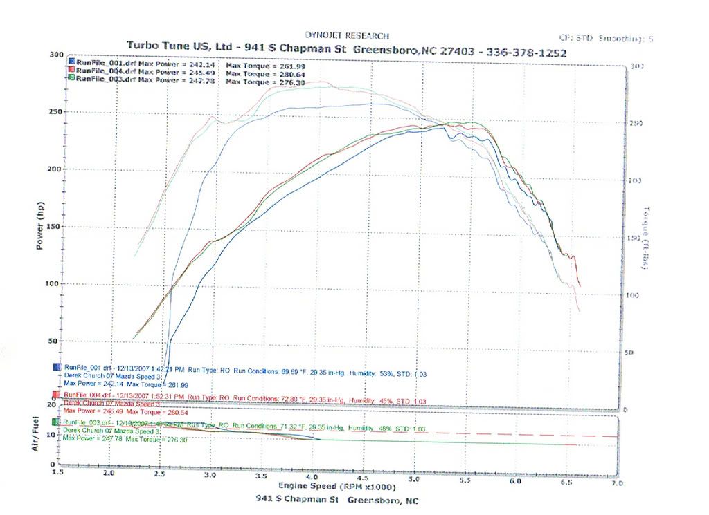

#8 Tru-Boost Stock (67 degrees 29.35 in-hg 14%humidity SAE 0.99)

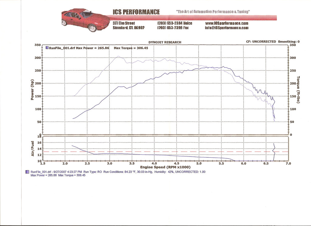

#9 Speedy3 (Stock / MS CAI - hood closed comparison)

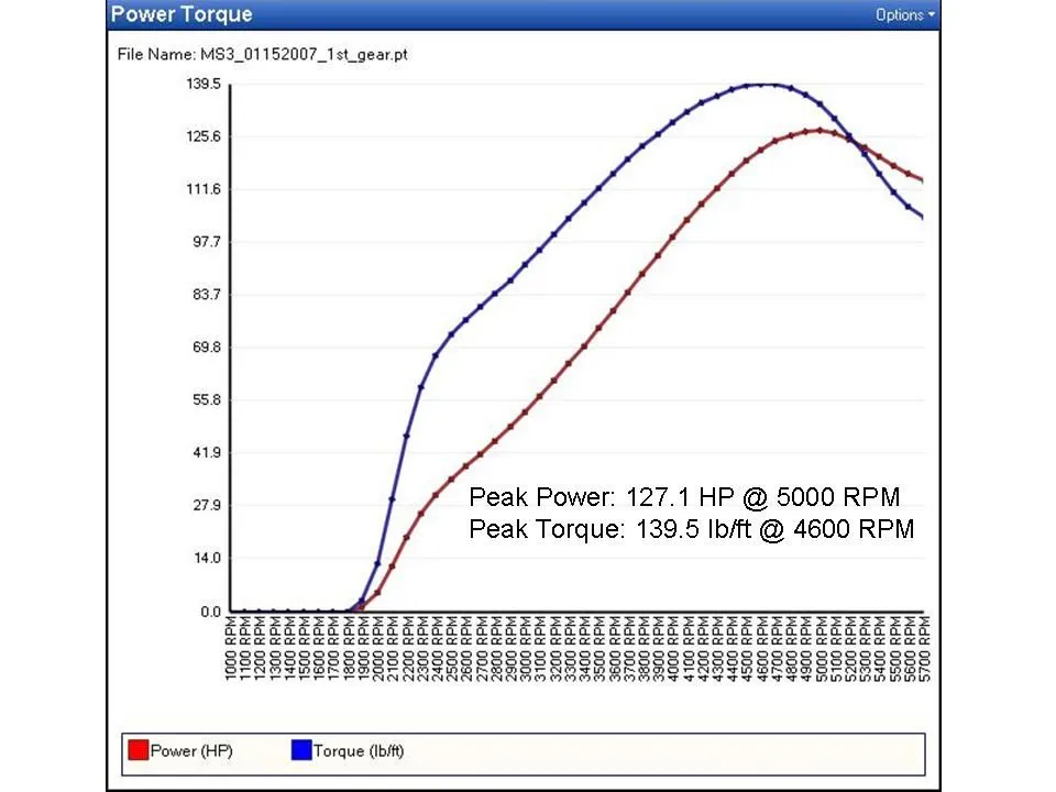

Auterra Dyno-Scan Graphs-First Use
HP/Torque Gears 1-4:

#5 Oz owner (with 50 mph fan and "bonnet" closed. Running synth in the engine and trannie, but no mods):

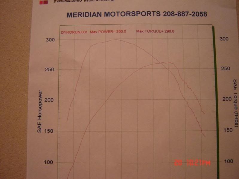

I just dynoed my 08 mp3 and with only 650miles, and the only mod being a test pipe the car made 260whp 298ftlbs. Boost gauge was reading 13psi falling to 5psi at redline. Im very happy with these numbers. Ill post the graph later.
