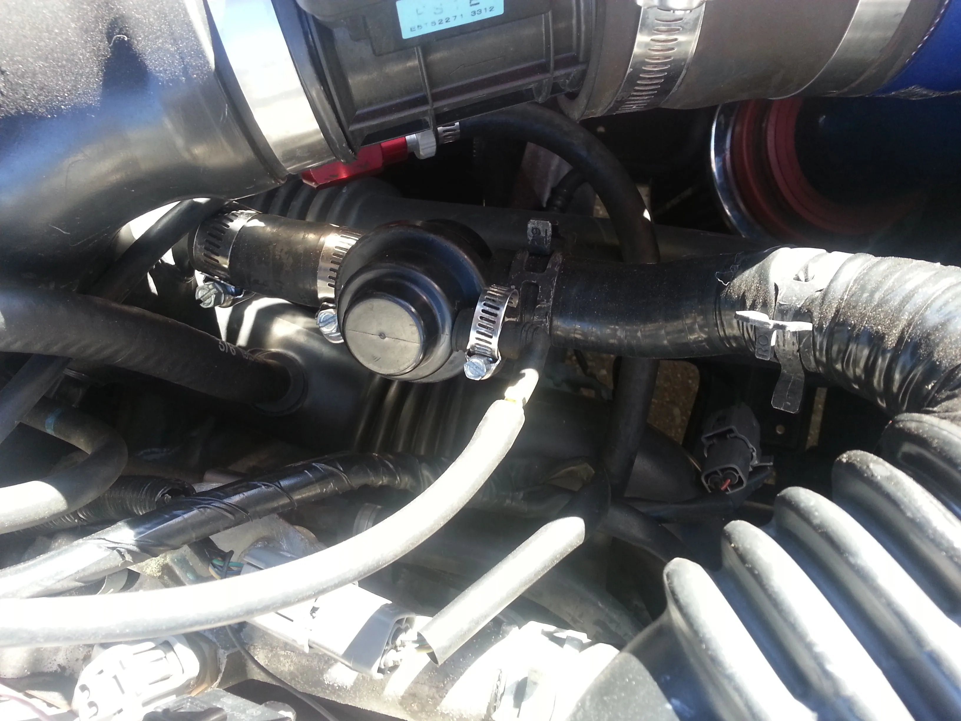

I'm trying to figure out what this valve is and do I need it, it connects the stock intercooler piping to the intake near the throttle body in this picture?
Picture of valve
